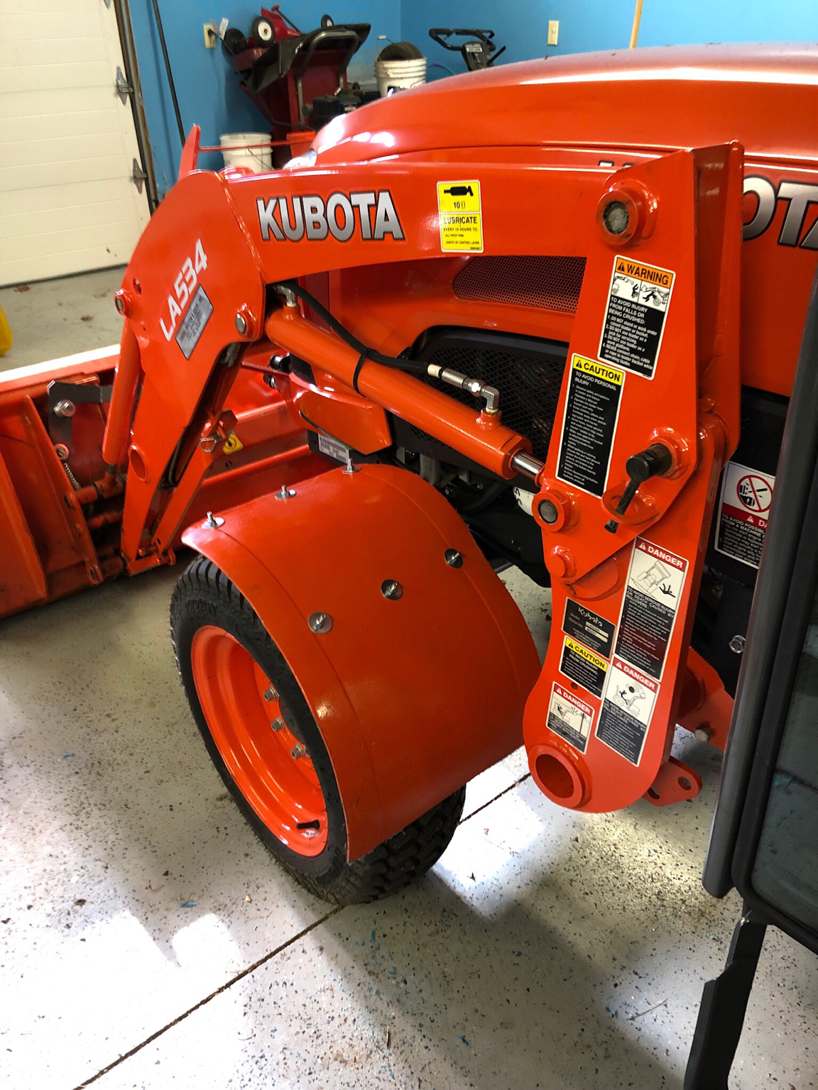

Snow Made a fender for my B2650.

Need to trim the bolts and touch up the paint.
   / Made a fender for my B2650. #4
Agree, that's nice. What's the reason for making the fenders?
   / Made a fender for my B2650. #6
You should start selling them!
   / Made a fender for my B2650. #7
Looks great. Nice idea. Love a good fab job!!
   / Made a fender for my B2650. #8
I would be interested in a pair!!!

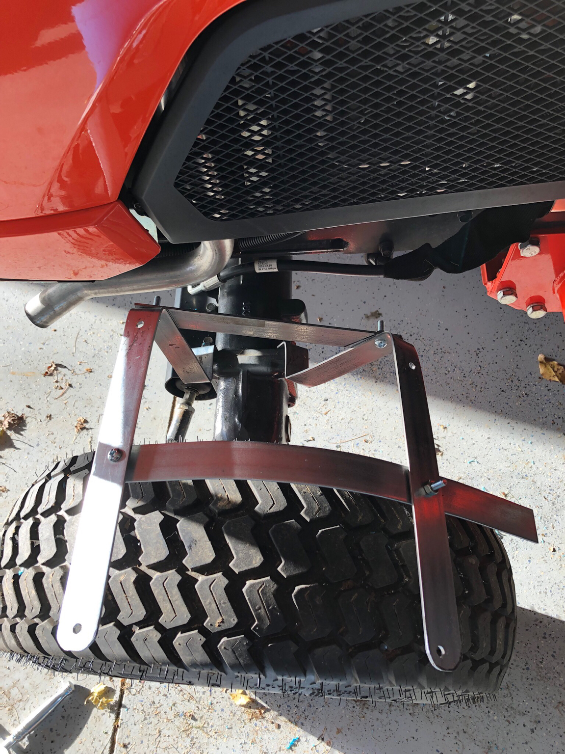

When I was briefly looking at adding them and comparing them to yours, do yours hit anything at full lock left or right?
It is difficult to see how they are mounted, but I assume there are brackets mounted to the axle hub bolts.
#9
Mine don’t turn with the wheels so no they don’t rub or hit anything. So far they have worked great. Was working in mud and plowed snow. Keeps most of the mess on the wheels from flying. I did have one instance where I got to close to something and pushed the fender into the wheel.
I was able to straighten it out easily.
I attached them with these brackets. This was while prototyping.
