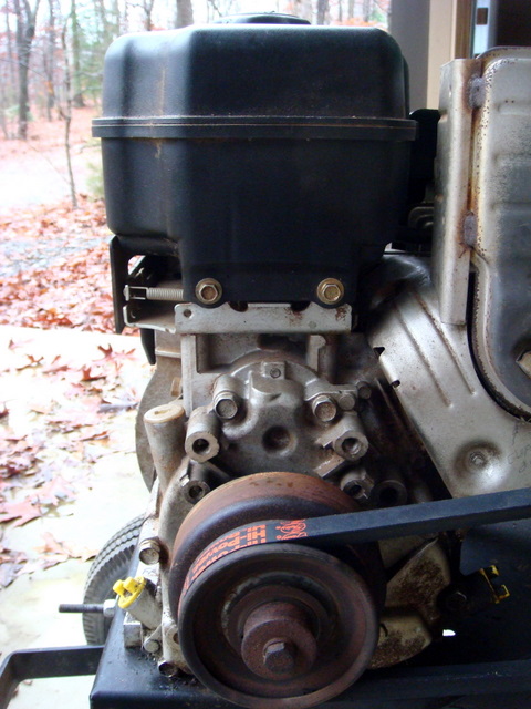

Hi Terry - Found the numbers (Engine Model, Type, and code). Also found some nice .pdf illustrated parts lists on Briggs and Stratton Engine Parts.
I'm attaching two photos which show the shredder engine.
My sound like a stupid question, but which side should I attack from; the pull rope side or the reduced side?
