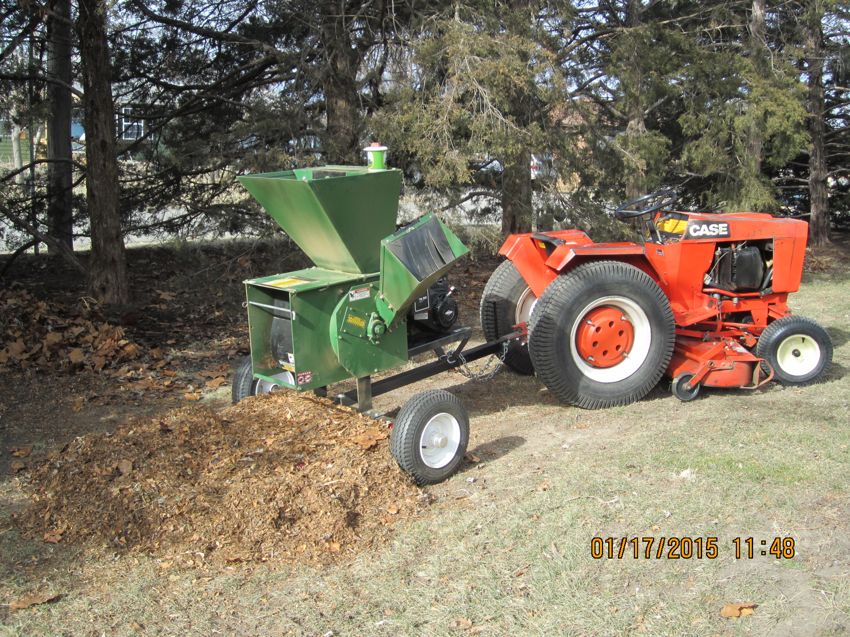

They are a good old time company. Their equipment is USA made and top quality. I've got the stand alone gasoline powered towable model since 2009 and it gets used a lot. If I can burn the debris, I do....if It is too big I either burn it or stack it for later use. But it is handy to pull out for smaller issues. The larger screen I use the most and make paths and general mulch out of the end product. 809.JPG
