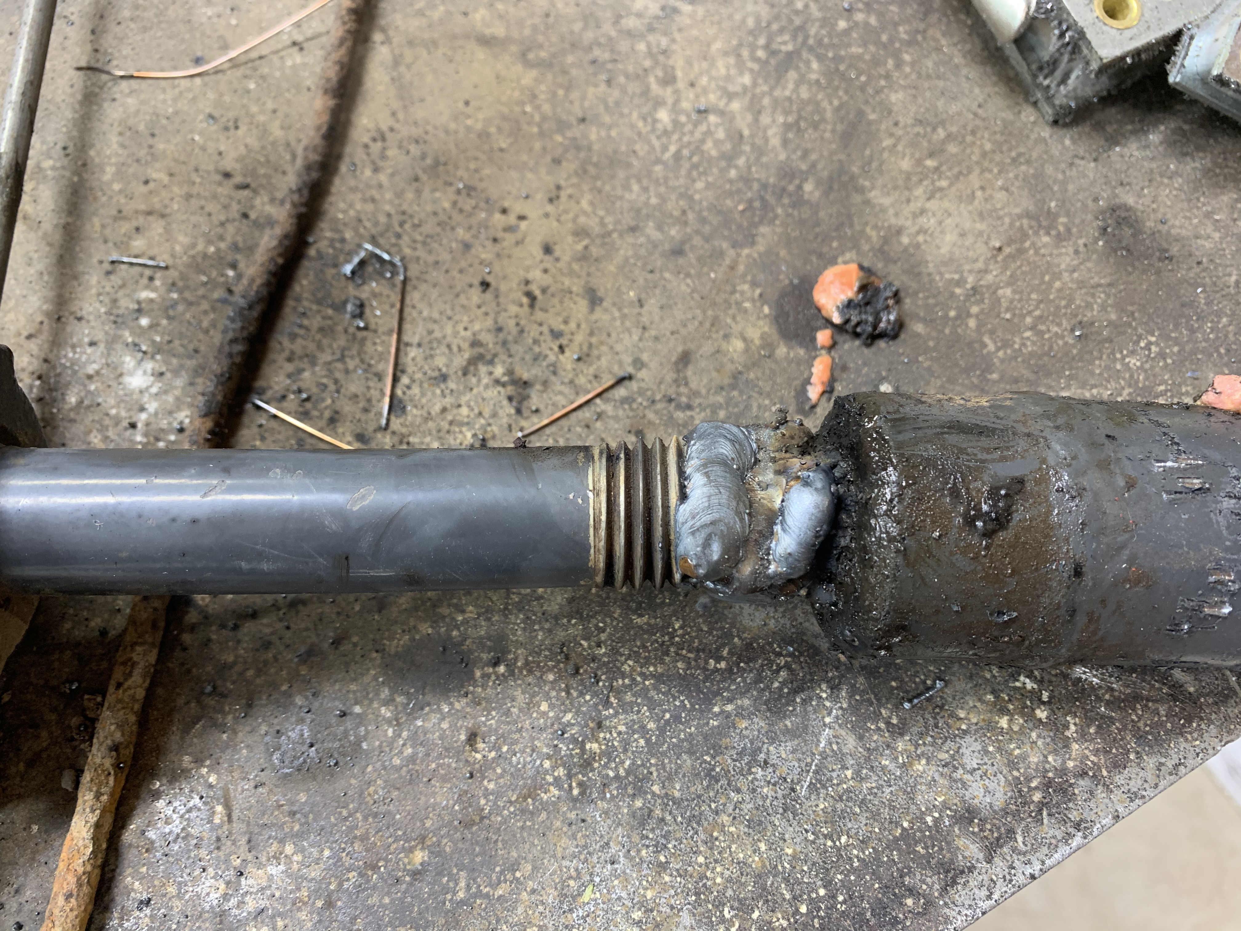

My old Kubota M5030 had nice heavy cat1&2 3pt hitch arms and hand crank leveling box. Use to 3pt hitches from Ford, MF, Case built heavy a made to last a lifetime of hard use. Newer Kubota and particularly the TLBs I currently run are light weight in comparison. See the same failures in my friends kubotas 60-80hp range.
Hope your weld holds. Your welder is a marginal structural welder. If it breaks again might trying heavy wall tubing. Easily sourced from online suppliers or places like metal supermarket. Be stronger than OEM, more surfaces to weld and friendly for your welder. OEM would probably fold up again.
MIG welding requires more attention to clean and joint prep. Stick with the right rods is more forgiving in the right hands.

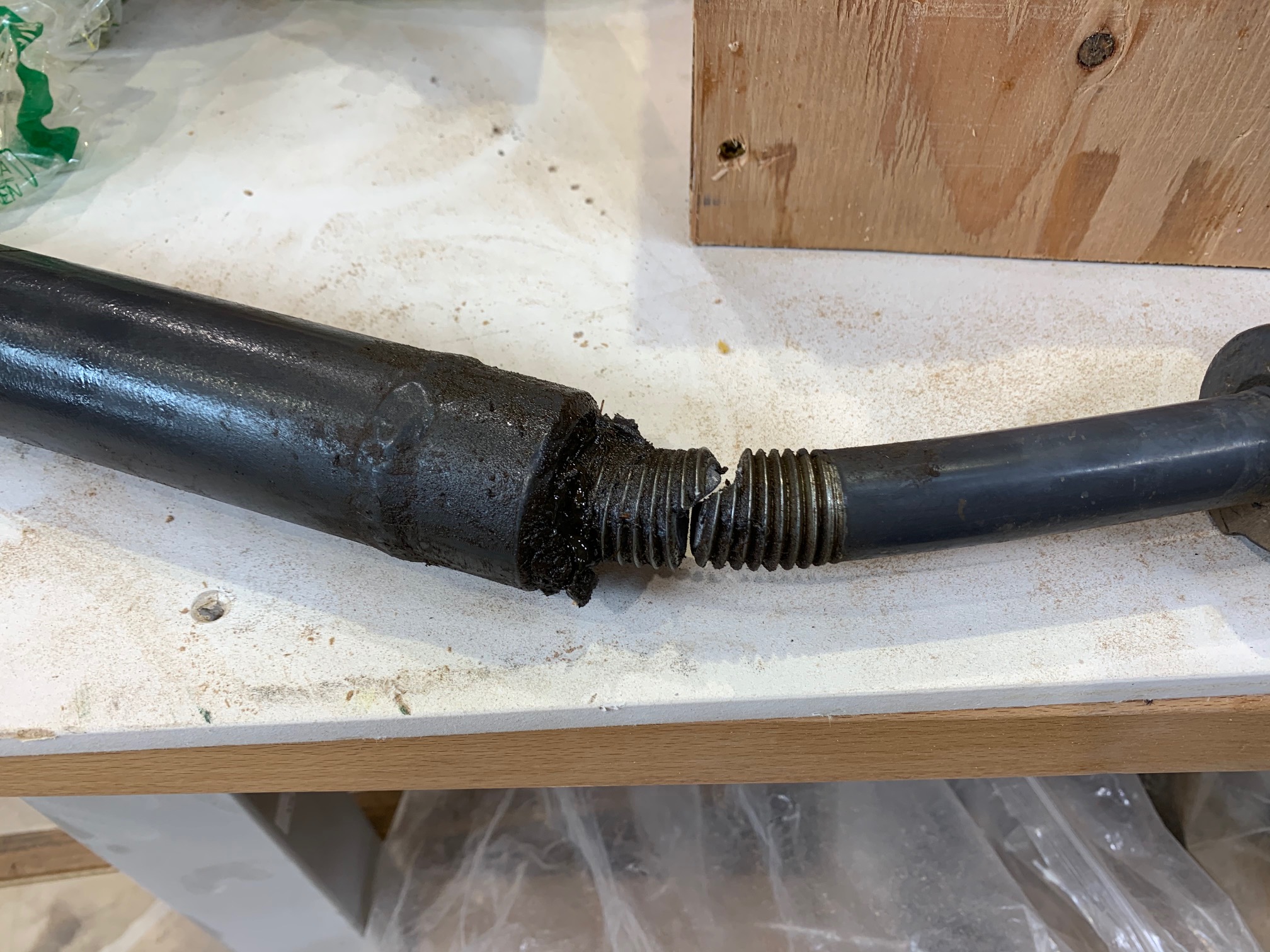

On a positive note, it’s a good thing that the rod broke otherwise you might to buying a new pto case or worse

I've been watching it and so far so good.
But if it does break, I'll use stick (which I'm even less good at).
Thanks!
LOL! It's the shear-pin strategy -- and it worked!
   / M9960 broke threaded rod in leveling assbly #17
As an engineer and designer I can appreciate shear pin strategy. Not sure this is the case. The threads reduce the diameter and their sharp corners invite stress points. These rods are failing under compression. Both my friends were grading when their lifting links folded. One was pushing backward. The other grading forward at angle. Not sure why that side even has a threaded adjustment. Some of my other Kubota don’t.
Even the best engineering misses from real-time applications sometimes.

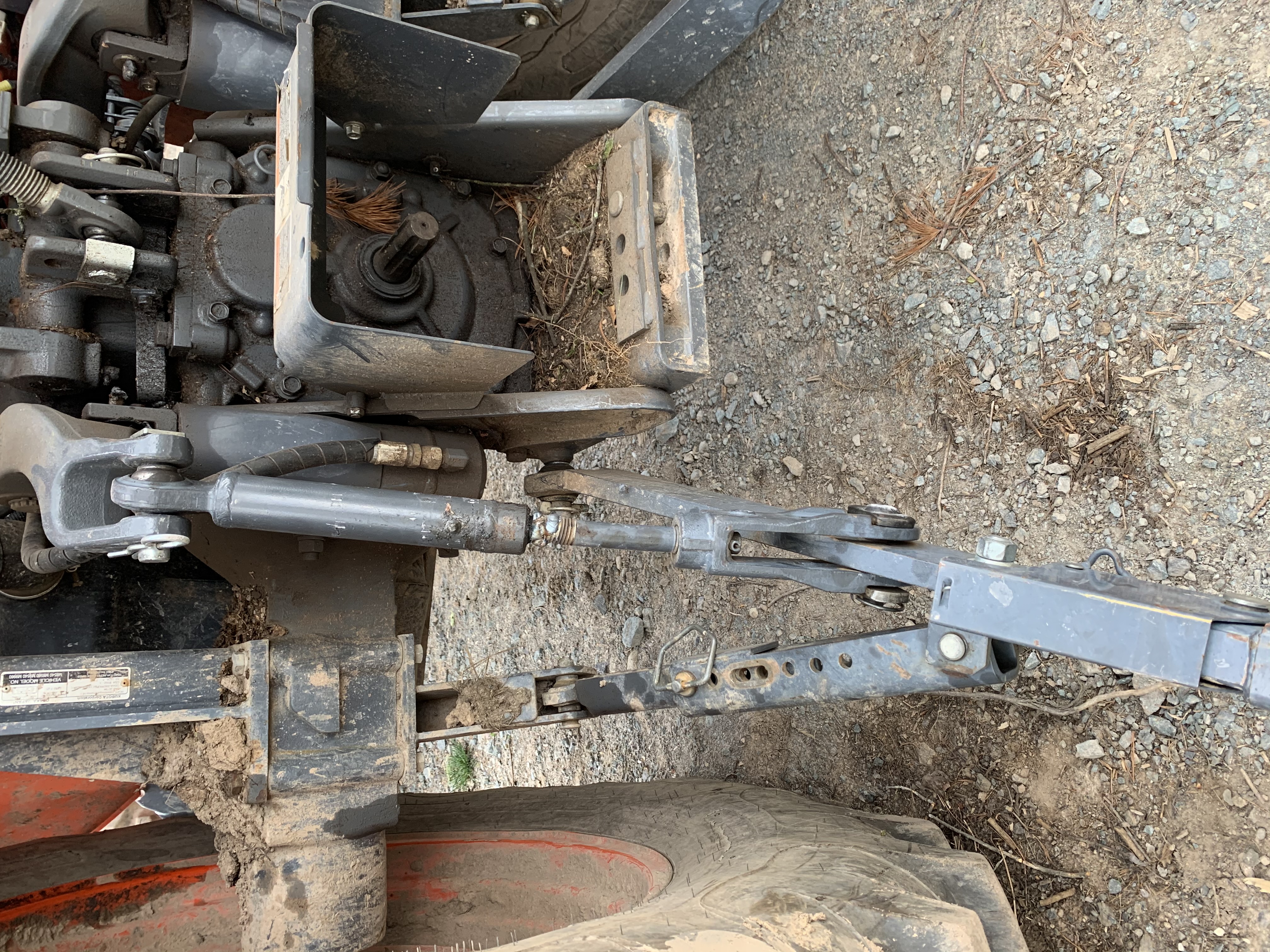

Left side threaded link gives the 3pt much greater range of motion.
   / M9960 broke threaded rod in leveling assbly #19
I looks simple to fix if that is a standard American thread, but I don't see why it would be. If it is two bolt heads welded together.
   / M9960 broke threaded rod in leveling assbly #20
I’m curious if anybody has ever needed to adjust the left side?

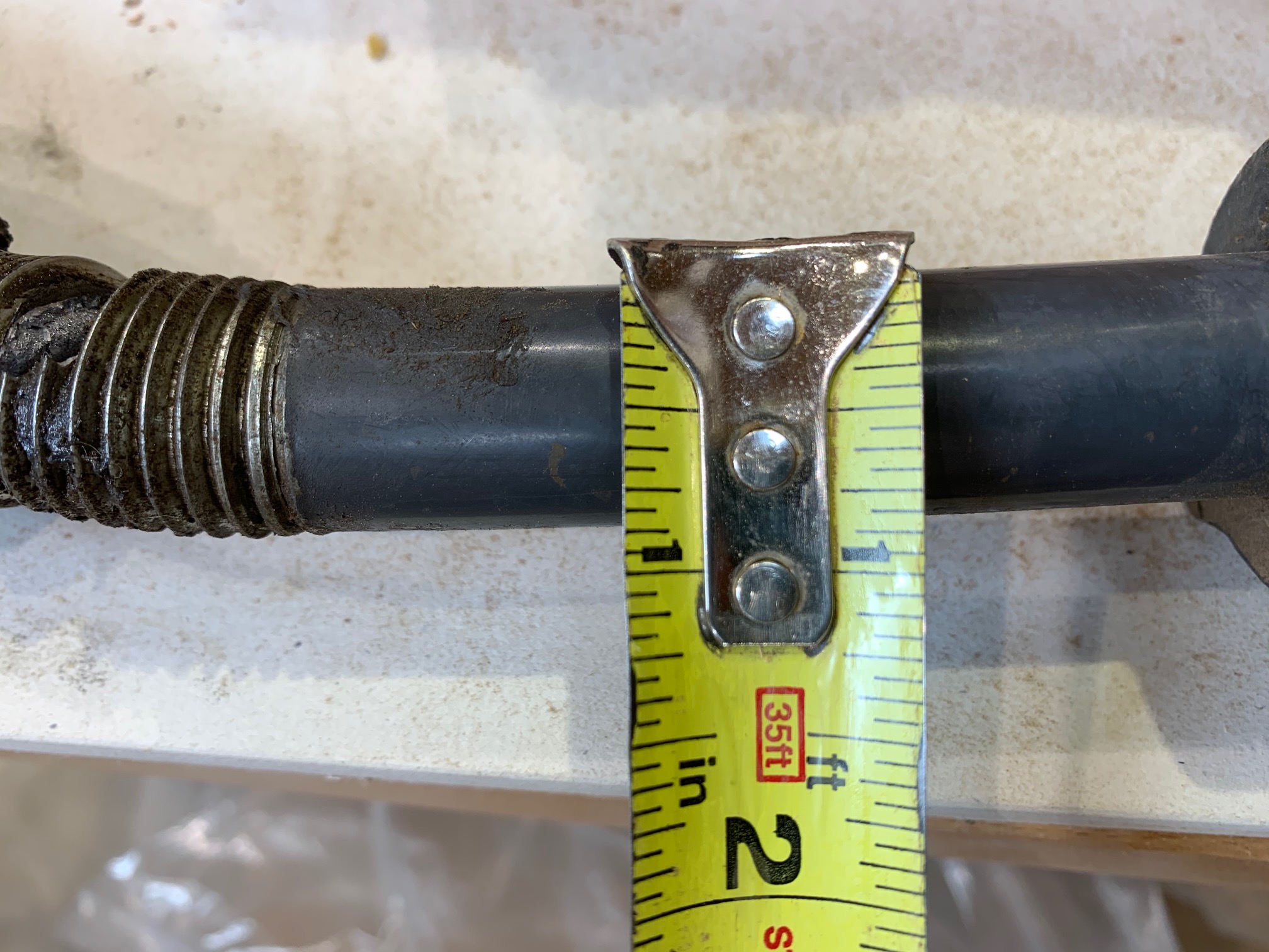

If it broke with normal use it would not be replaced or repaired back to OEM spec. That lifting rod threaded feature is a couple of sizes too small for my taste. Fortunately the local scrapyard has large nuts, bolts and threaded rod even in stainless by the pound. Drops of all kinds of structural steel.
