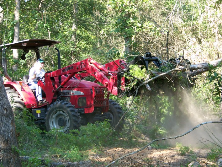

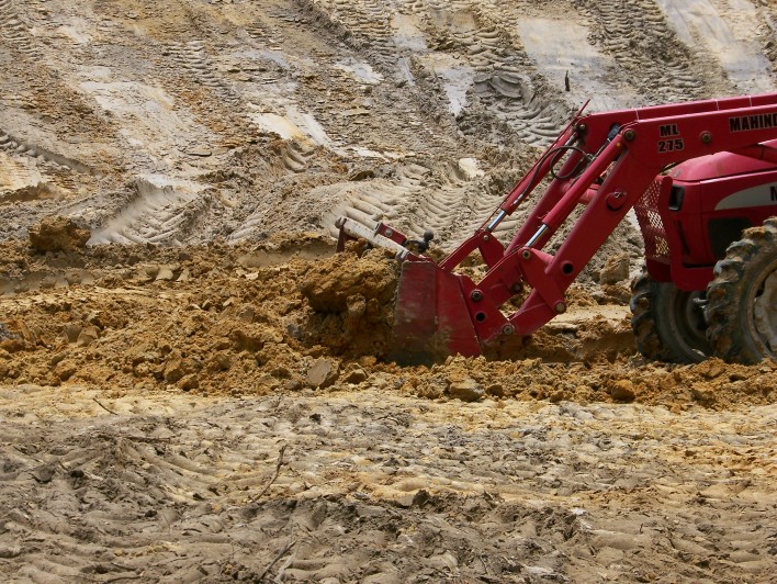

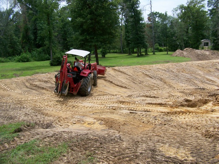

I have a 84 inch skid steer attach bucket on my 6520 4WD. It is a 2007 model and it the earlier version of the 7060 and now the M75. I love the bucket width and the tractor works well with that size bucket. I have added 3/8ths thick end plates and a 2 inch thick wall tube to the top lip of the bucket. It has a receiver hitch in the middle on top, so I can move my 29 foot gooseneck around. I also added chain hooks on each corner. It is a beast. I call it the Big RED Beast and it can move lots of dirt. It's stable on slopes, but would be better with loaded tires. I like to keep the nose pointed uphill on slopes. As you can see, the bucket is way wider than the front tires.
The grapple is a 6 foot Titan Industries unit. It works well for me, but would have liked a wider grapple. I like the dual lids on it, as I can pile a huge pile of limbs up against a tree and push into the pile up to the tree and close the lids on both sides of the tree and pick up the whole pile. 6-2-12 Grapple First Time in Action.jpg8-5-07 Stump .vs Brandi & the Big Red Beast cropped.jpg7-9-12 Big RED Beast going up dam with clay.jpg7-9-12 Pushing Clay.jpg
