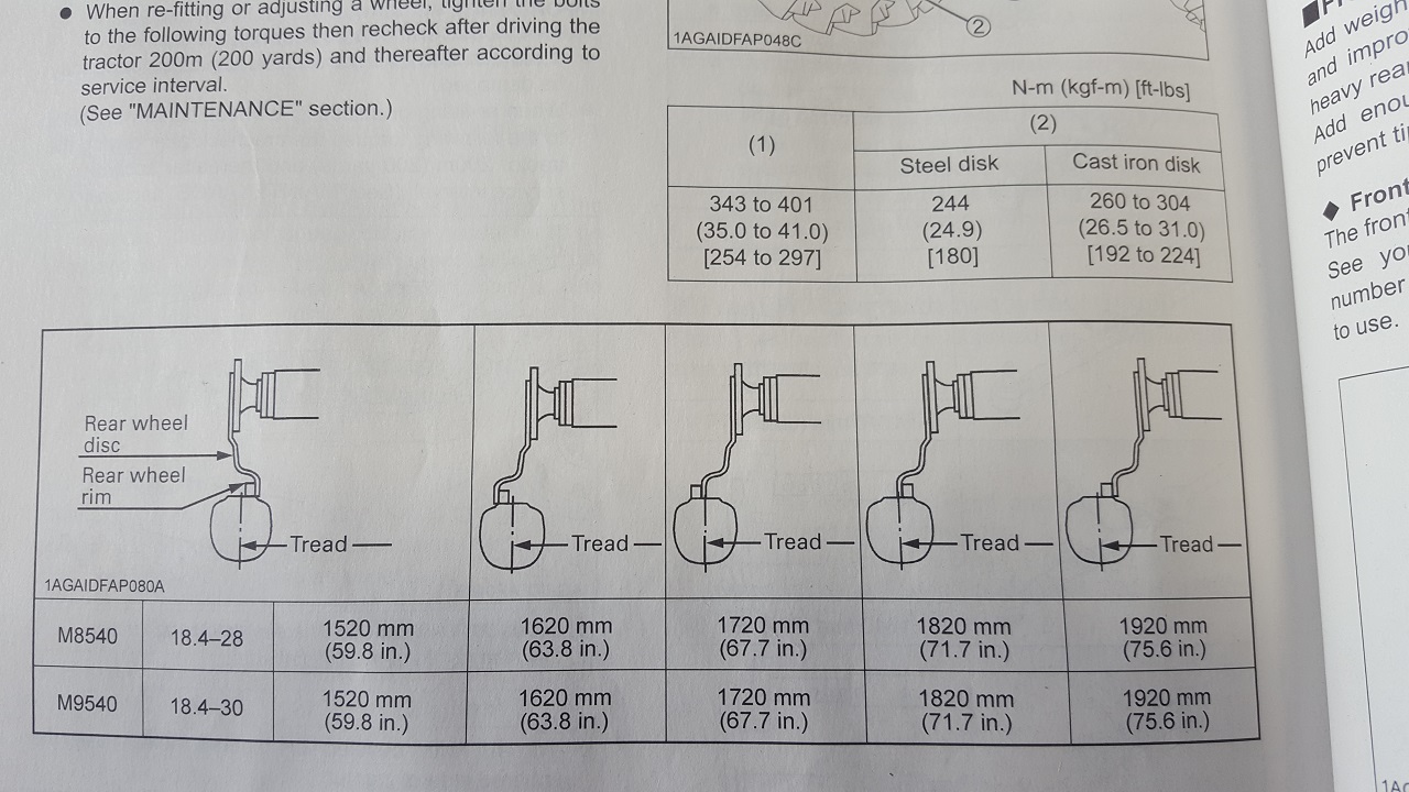

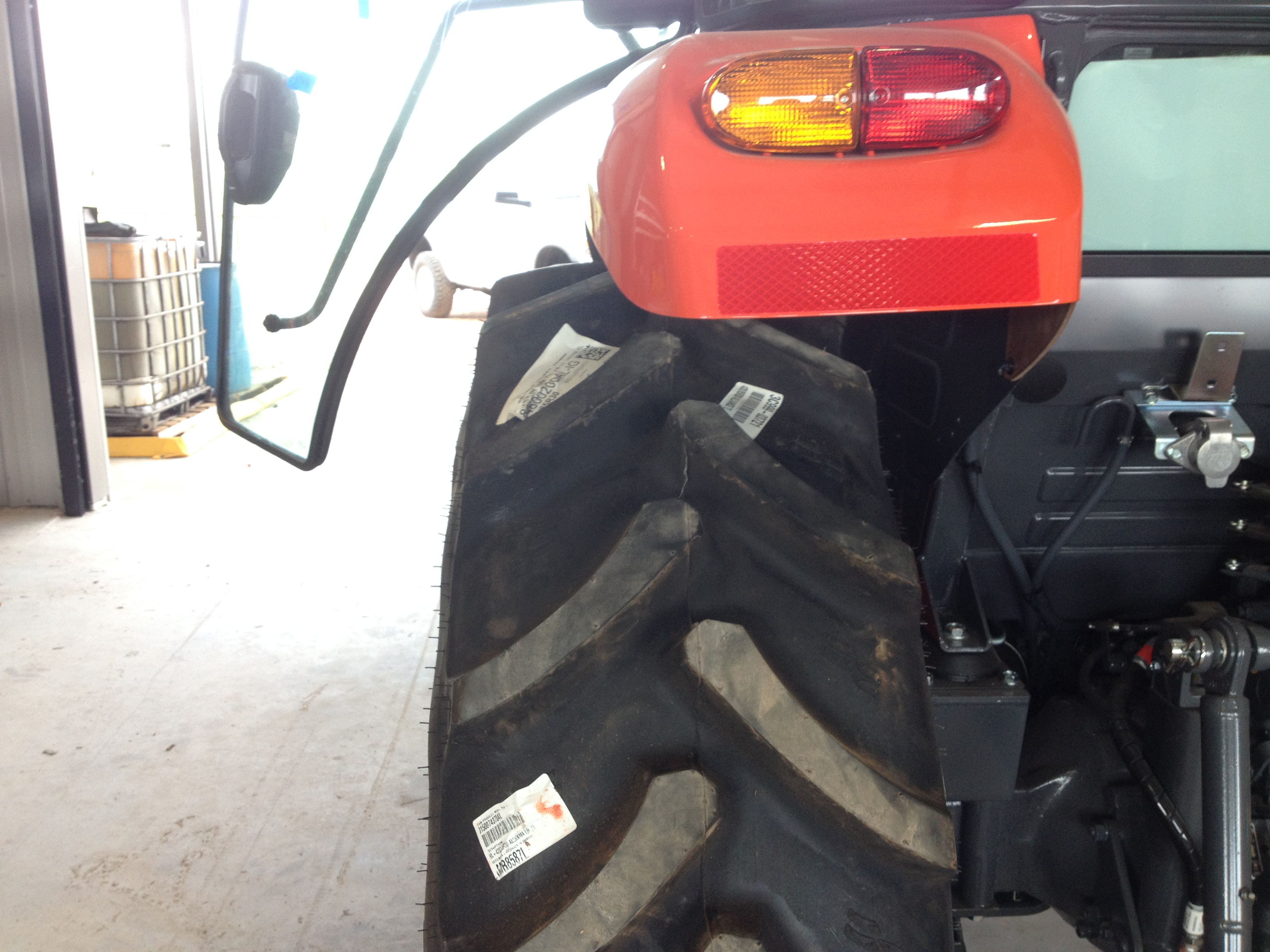

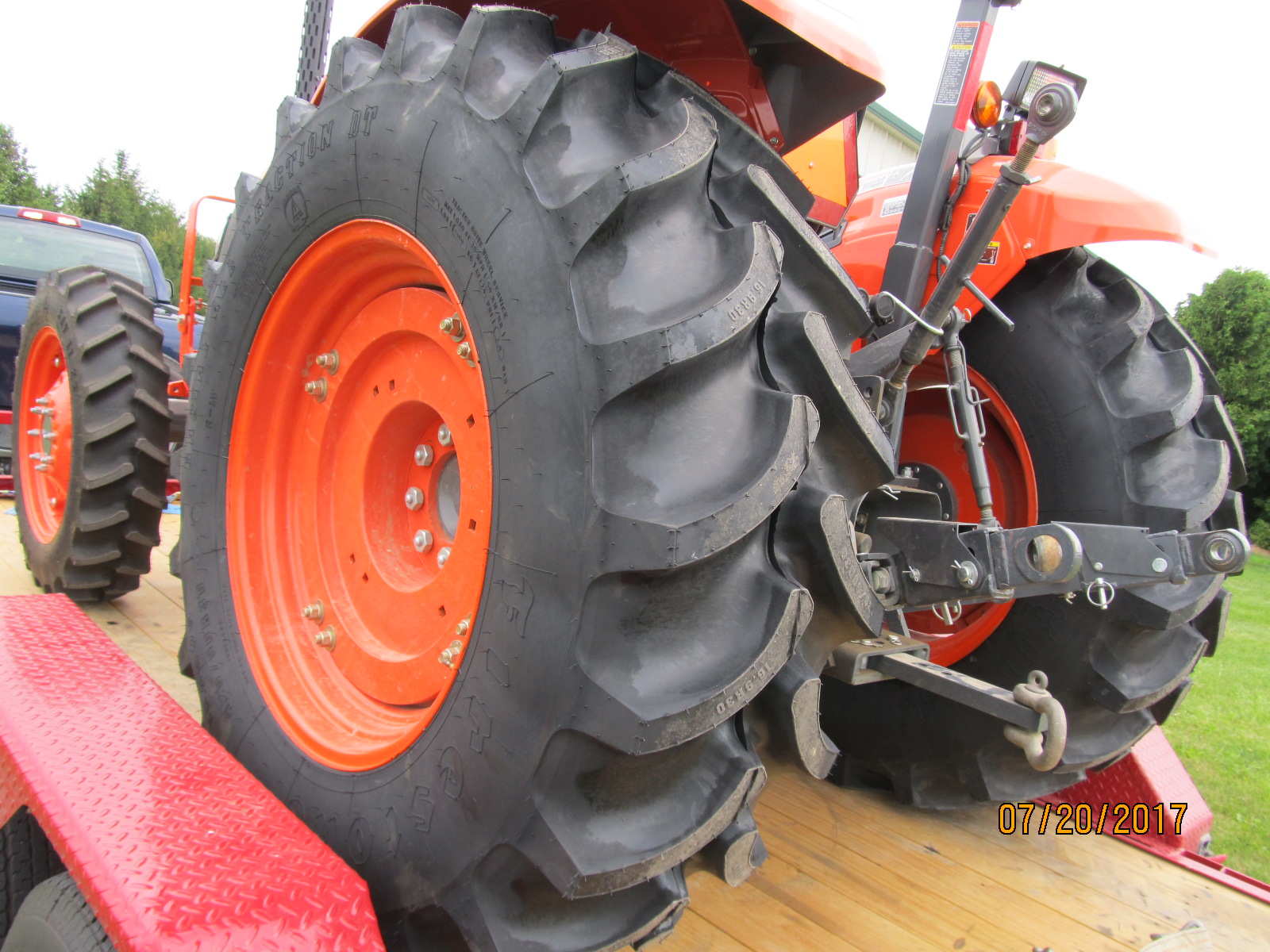

The overszd manual page above agrees exactly with what I found on the dealer lots (using tape measures and calculations) when shopping for a tractor last round. The M9540 widest stance is 75.6" Add the tire width using 18" tires and you get ~ 84 inch best case width between outside edges. I run my MF2660 wheels such that the outside edges of the tires are 96" apart all the time, which I find nearly ideal. There is about another 12" spread available on the Massey with various wheel configurations that I have not used because of trailering limitations, etc. But the flexibility is there.

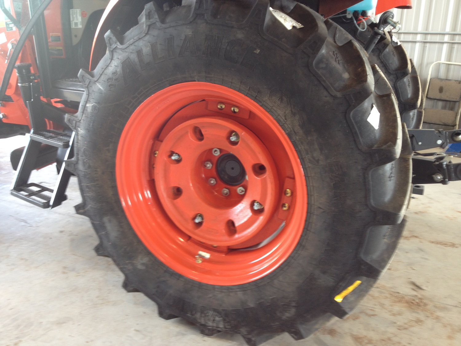

I'm pretty sure my owner's manual makes no consideration for Cast Centers versus Stamped Steel. So I don't pay much attention to the measurements listed. I only listed my manual page for reference as to mounting positions.
I'll attach another pic. You'll hafta trust me that the tape measure end is even with the outside of the opposite tire. This is with 18.4x30 tires. If I move the rim tabs to the outside of the Cast Centers I gain another 4".
Ooppss, forgot the pic.....

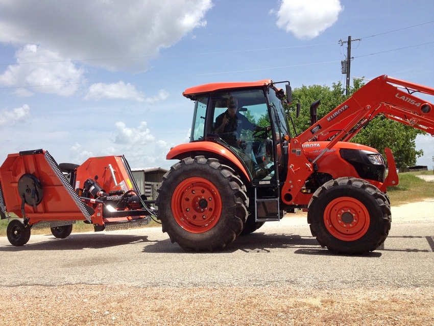

Agreed, no twists here. Im happy with the spacing I have for now and if I ever get a flat I and have to pull a tire off, I may add more spacing at that time.
Until then ole Texasboy is a happy camper, I got A/C and a radio ! :cool2:

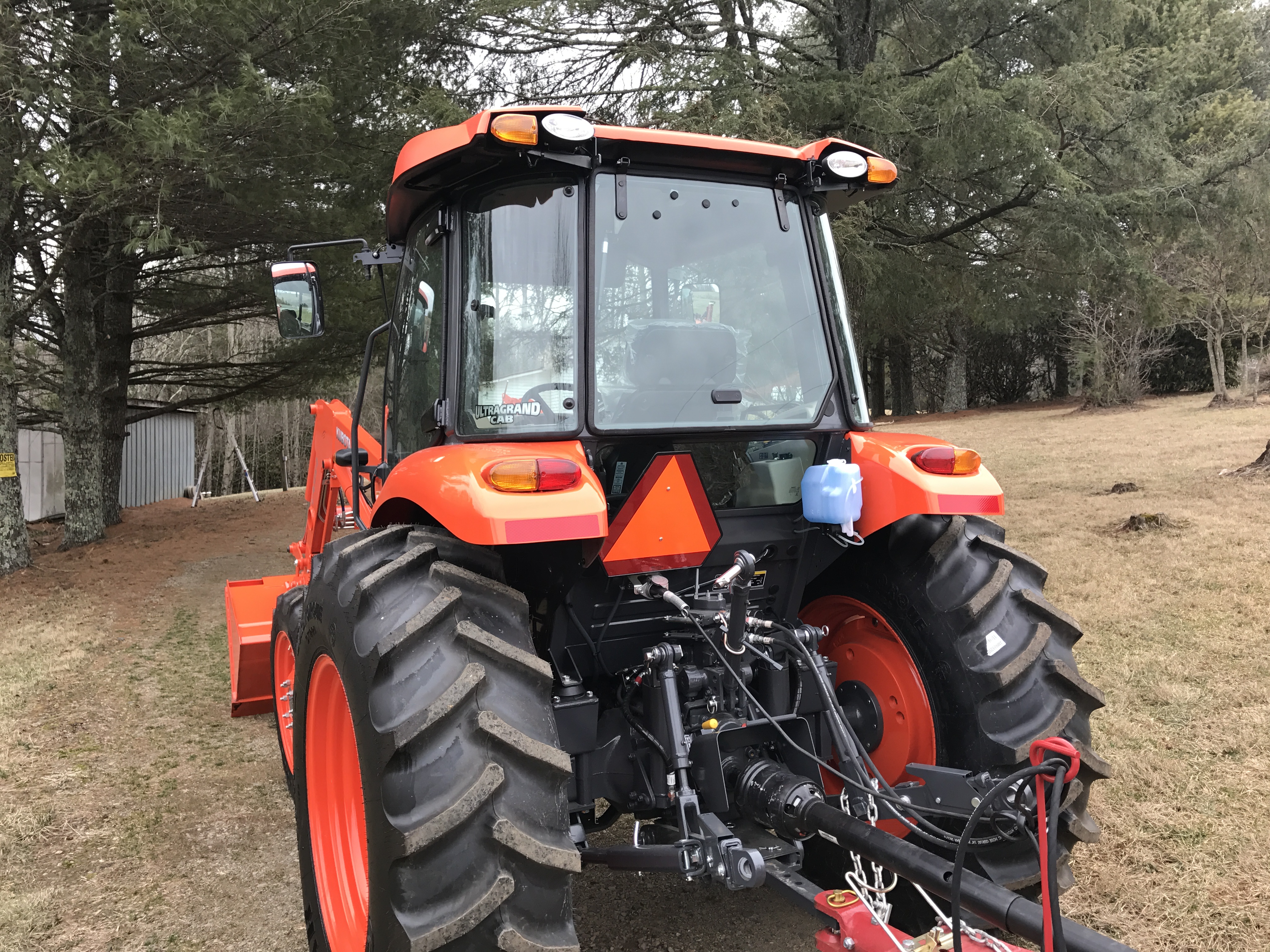

When I bought the tractor, new in 2009, the dealer asked if I wanted the wheels moved out to the widest setting. They are at one "notch" less than full width. This would have made outside to outside go from 80" to 84". If the 4" would have made that much difference - I'd be long dead.
No - the 1500# of RimGuard in the rear tires makes a whole lot more difference than the extra 4" of width. There is one place on my property where I always try to go up/down the slope - not horizontally. Horizontal can scare the snot out of me. It's probably still a ways before things would get dangerous. My fear factor takes over long before the tractor would tip.

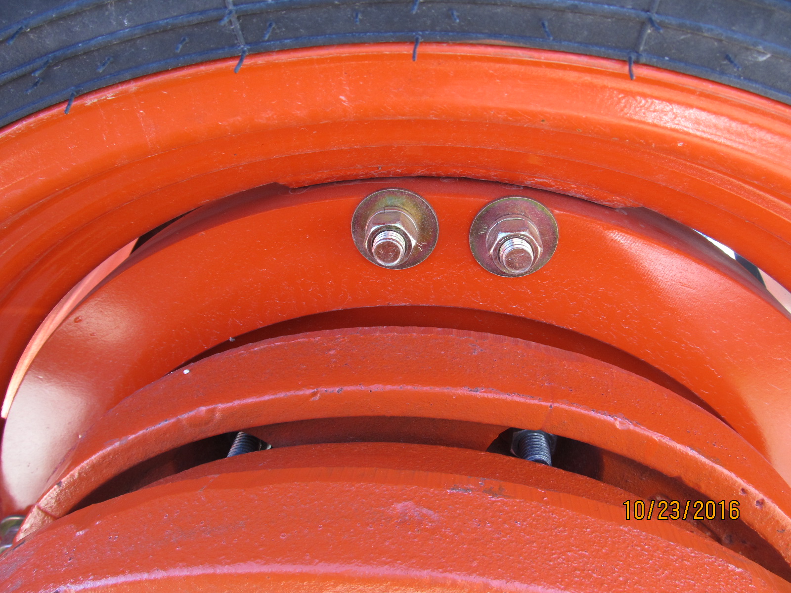

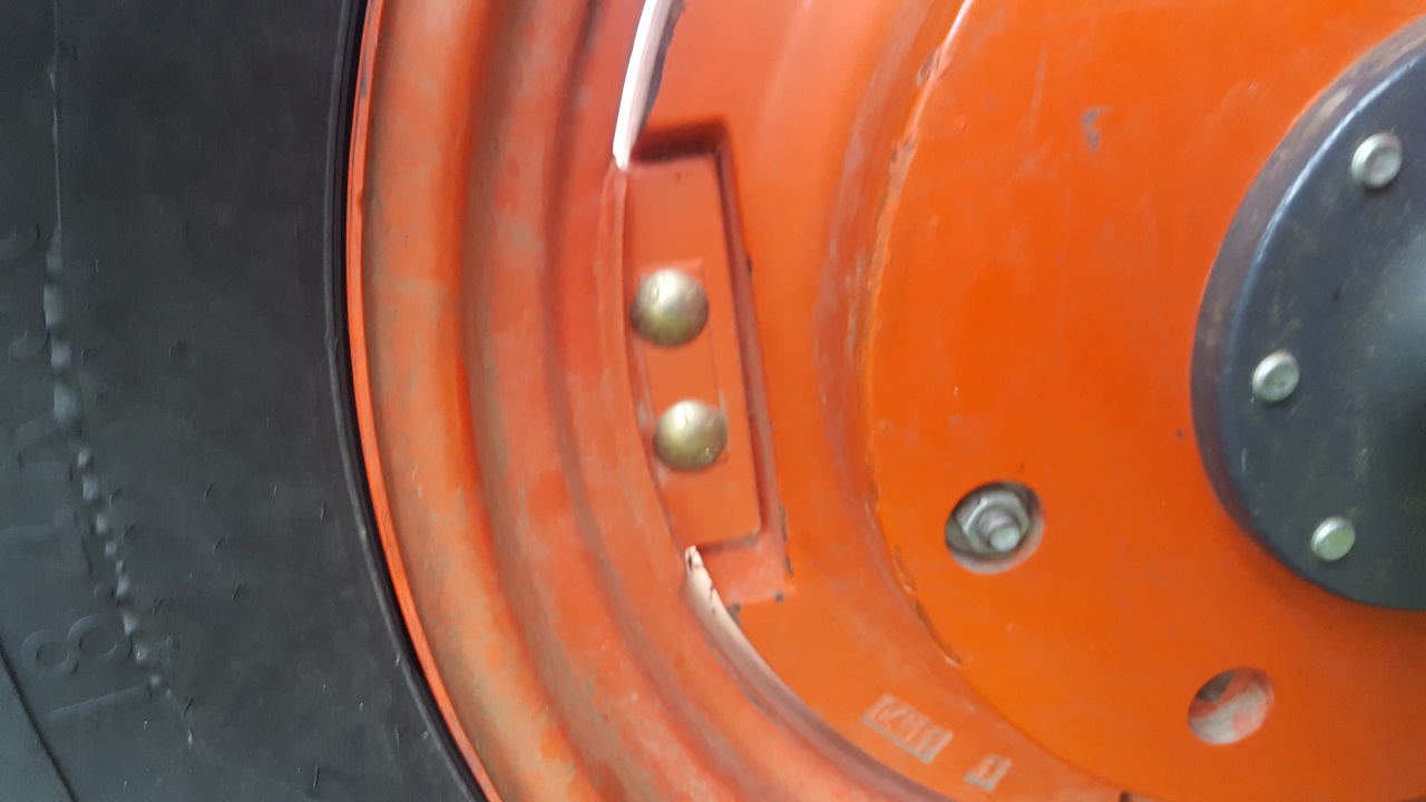

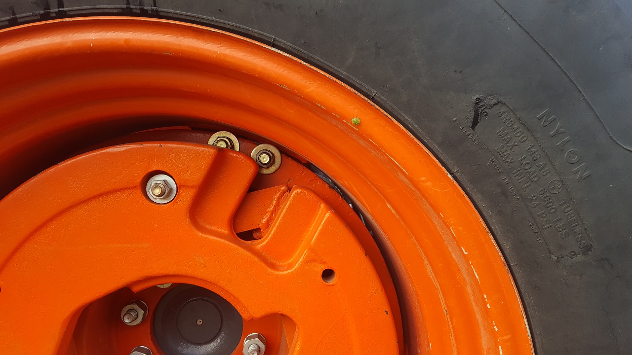

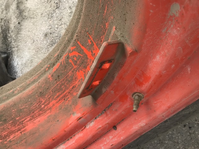

As I explained earlier in this thread, with the raised boss on one side of the tabs limits the options you can do. This is the point many are missing. As the tractor sits now, we did indeed take the left tire and move it to the right and the right to the left. And doing so gained us what appears to be a bit over 2" on each side. But that raised area on the one side of the tab limits how many options you get without taking the tire off the rim and moving it the other direction. That raised area cannot be put against the wheel center.
614313d1564014182-m7060-rear-wheel-offsets-img_4131-jpg

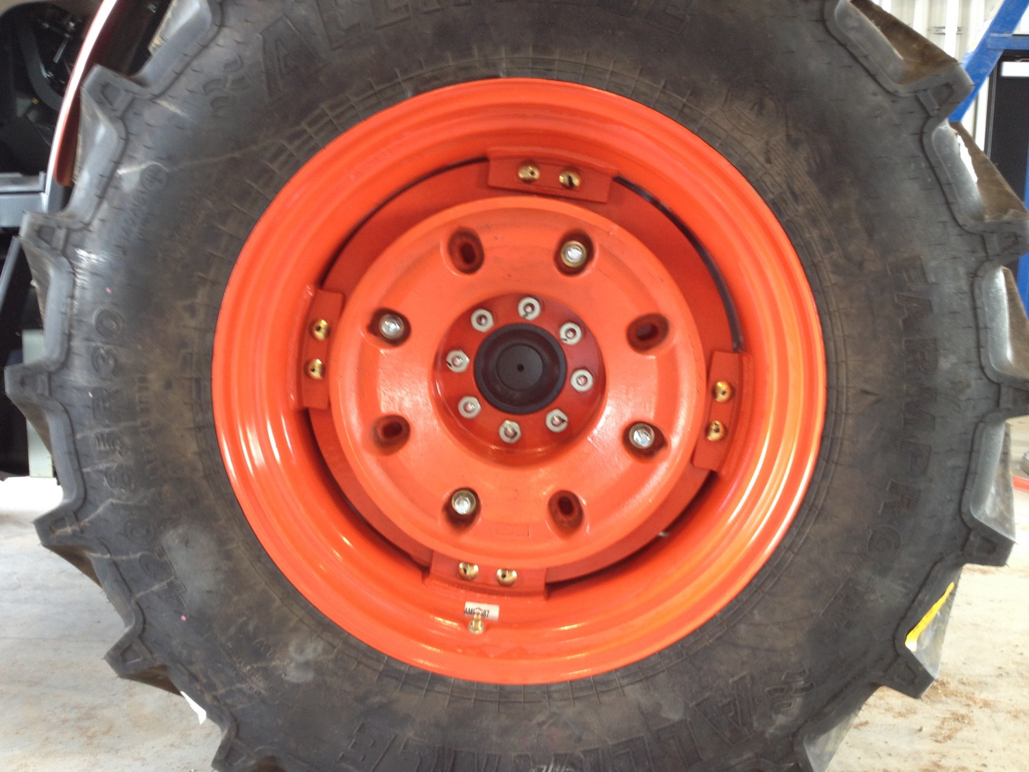

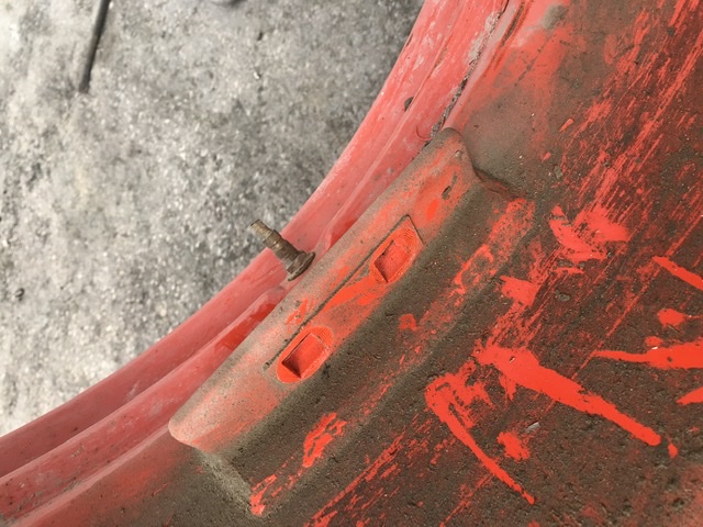

Hi Tex et el
sorry to drag up an old thread but it was one i found while searching on how to widen my tires and i want to share what I learned.
I have cast centers. I was seeking to have the width Herky has....
it would have appeared from your pic that i couldn't get that due to that raised spot on the tab. Well, once we lifted the centers out of the rims, low and behold, both sides of the tabs have that raised area.
I'm able to let you know that you can get 8 positions with the cast centers.... the cast dish can go on either side of the rim's tab.
I can say that this project was not hard but needed big equipment to lift the disks and rims, it's all heavy.
It made a huge difference in handling of this tractor. it feels how a tractor should, it seemed very tippy in in the narrowest setting.
View attachment 658528View attachment 658529
That is great information to know and no way to get it without all the heavy lifting involved. Thank you.
How did you lift and handle everything? Any unforeseen problems? Any advice to someone who might be planning such a move?
