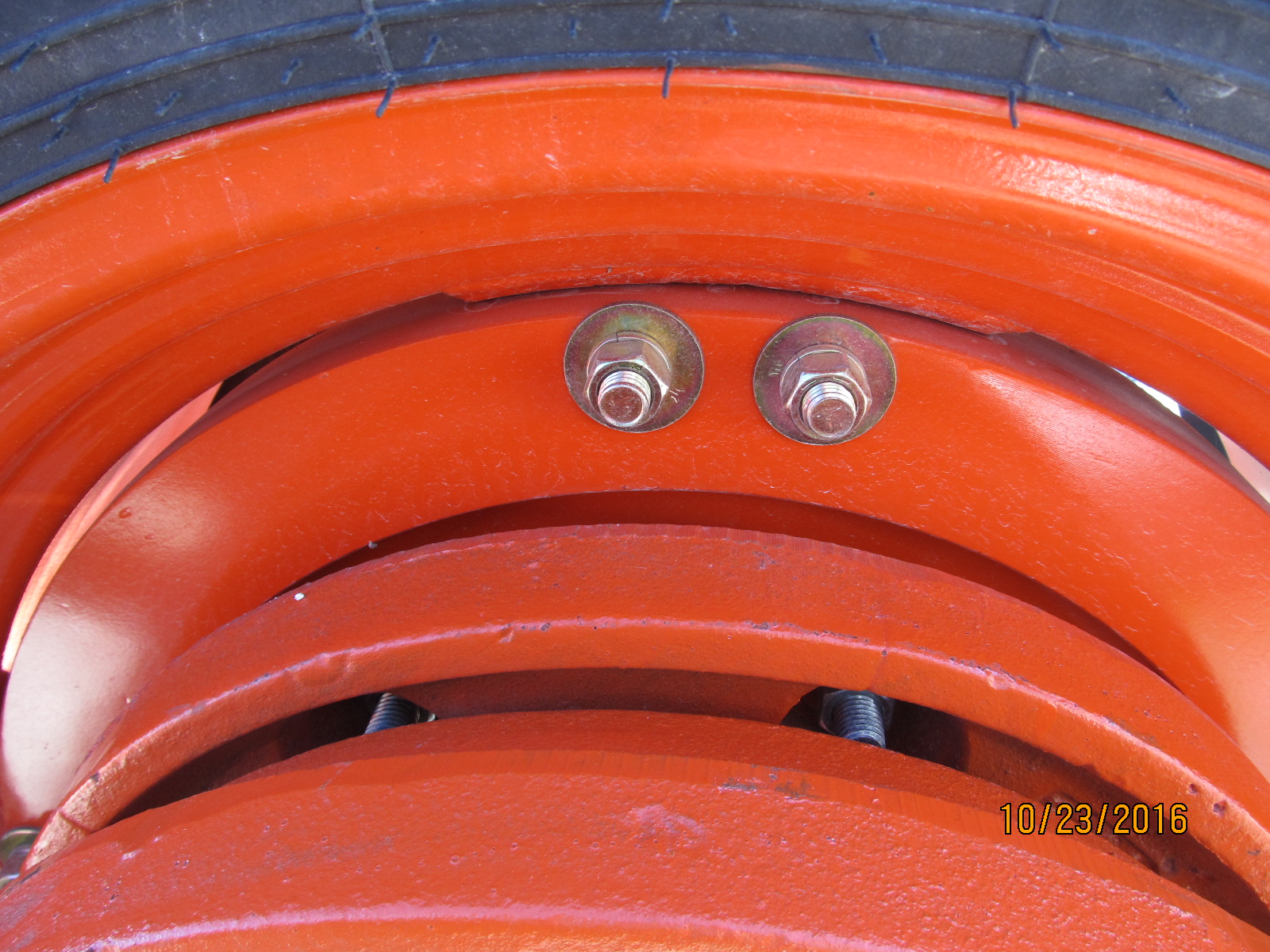

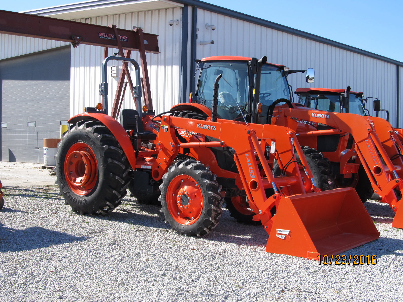

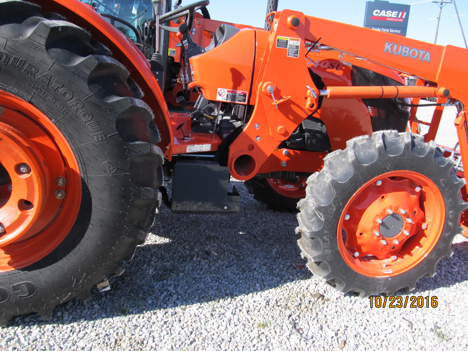

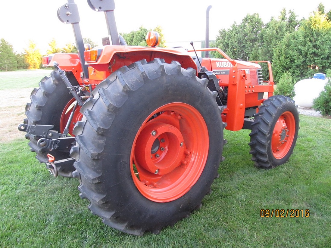

Yes, you can add rear weights to the cast wheels. It's no big deal and is done all the time. I do it and have pics of others doing it as well. You can have cast and add up to three sets although two sets is plenty. Not sure if I would do it with liquid in tires since people usually do one or the other.
