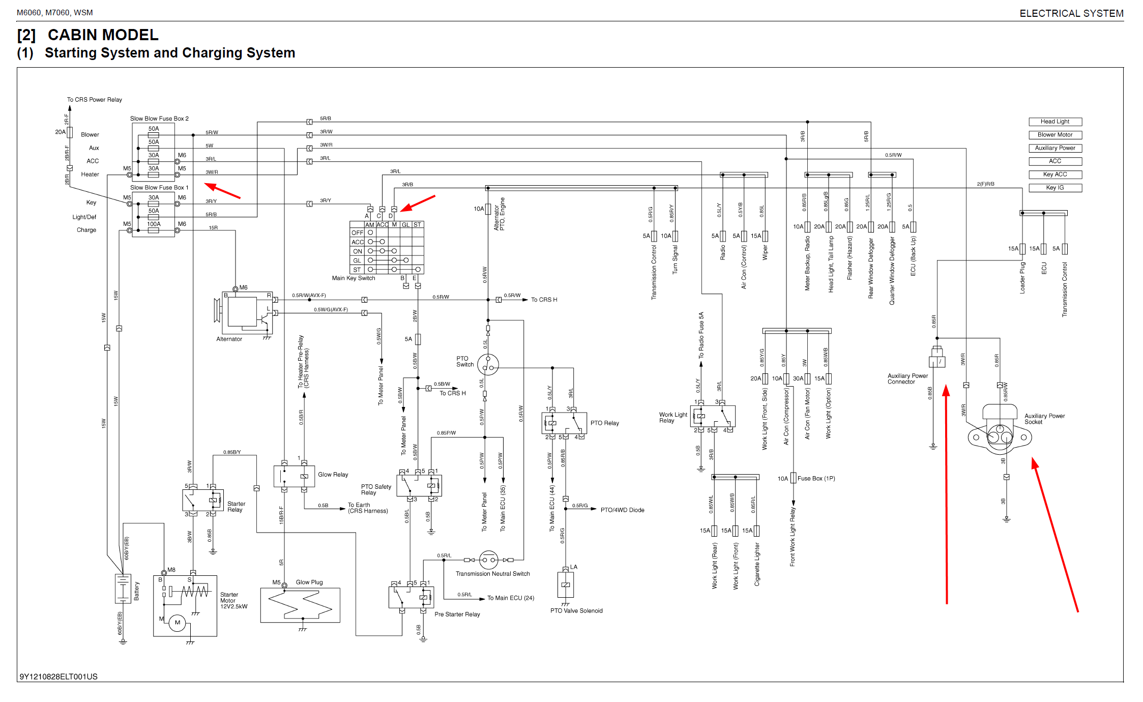

M7060 cab right side liner access
   / M7060 cab right side liner access #1
RoyKing
Platinum Member
Nov 4, 2017
839
Gainesville Florida
M7060HSC/18, RTV-X1100C
Ready to mount my new air seat but need 12vdc. Tthe aux power connector has two circuits 15A on during run, and 30A on all times. Want get to the 15A for air seat and front/rear camera/monitor. So WSM schematics show a unused plug behind right side liner. Anybody know any easy way in, maybe you added a rear hydraulic valve?
#2
I believe somebody posted about this but I couldn't find it with search. The extra plug the dealer told was there and wears two labels "loader plug" and "aux power" since I have the 3rd function on FEL it is plug in there and I need a Y cable adapter. Hope dealer has Y cable or just factory plugs in stock. New seat doesn't have operator presence switch so I'll just short it.
