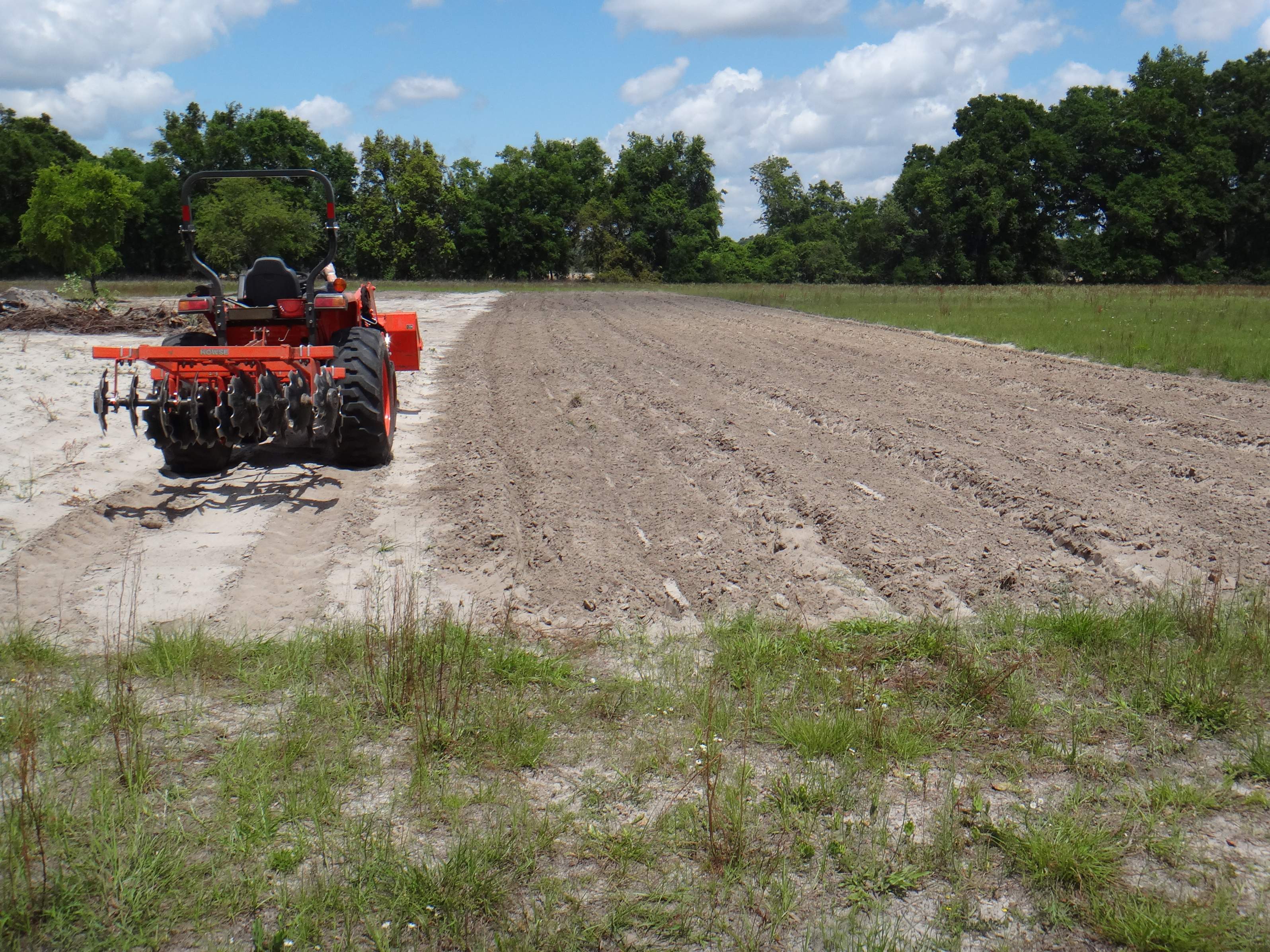

Tandem Disc Harrow is a type of TILLER. It mixes soil when front gang cuts and throws soil OUT, then rear, wider gang collects soil and throws soil (less violently because of less aggressive pan position) IN.
You need to go fast enough to observe this in/out mixing, four to five miles per hour.
Optimal speed will vary depending on pan depth, first/second pass and soil moisture. You cannot use a "set" RPM.
Fasten your seat belt.
Are you confident about settings of your front/rear gang angles and spacing between left and right rear/collecting gangs?
