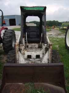

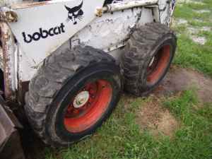

i have been dreaming about getting a skid steer for quite some time now and i am going to take a look at one this weekend its a older unit, bobcat m700. i am mechanically inclined and work on all my own stuff, but i am not familiar with skid steers. this is just going to be used around the farm moving dirt, rocks, and pallets. not for construction or commercial use.
my questions are what should i look out for with the m700, or any skid loader in general? whats a m700 worth, they are asking 3500 for this one? how difficult and expensive is maintaince on these older units? and are they reasonably reliable or is this something thats going to nickle and dime me to death?
thanks in advance for any advice.

I've got a M700 for home use and I think it's just fine. They don't have any of the computer interlocks that drive you crazy when they quit working due to a period of inactivity, the air cooled gas engine is pretty simple to work on and reliable. Parts are still available, and as long as it's not going to be subjected to ham-handed employees using it commercially you should expect a long and happy time with it, provided it's in fairly good shape to start with. I got mine surplus from work before it was going to the auction; the pivots for the bobtach are worn badly and the tires are almost smooth, but for what I do around here it suits me fine.
Things to check for: slop in the pins for all the cylinders and tilt points, should be evidence of grease there. Also seepage at the glands of the cylinders, evidence of hydraulic oil leaking around the Vickers pump, that would be the most problematic area. Check that the machine doesn't creep when in the neutral position, and that the drive is the same, no tendency for one side to go faster than the other, both forward and backward. Push against an immovable object, the tires should spin and the machine shouldn't stall. Lift the front tires with the bucket and check for chain slop, there shouldn't be more than an inch or so of travel in the tire, and you shouldn't here a chain slapping inside. Wheel bearings should be tight, no in or out or side to side play. Check for evidence of leakage at the axle seals as well.
There are several members of the skid-steer forum here as well, they'll chime in with anything I've missed.

Your M700 is slightly larger than the M610 I recently bought.
For reference my 610 (judging from the two small photos you provided) is in much better condition and had four brand new tires on it when I bought it. It needs going over to fix some minor stuff but has no leaks in the hydraulics, no damaged or missing parts, motor runs great (rebuild with ~700 hours on it), has auxiliary light front and back. and the paint is in great shape with very little rust anywhere on the machine. I was told it was kept inside most of its life, and it looks it for a machine built in 1980. For this I paid roughly what you did, only big difference I see between the two is capacity (1000# vs 1200# for the 700), and machine weight (3810# vs 4230#).
