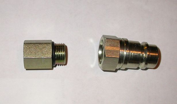

Alright, I've been a little slow lately. Not sure why I was worried about the flow of those 3/8 female fittings since they were coming off anyways. /forums/images/graemlins/tongue.gif
I went to the hose and hardware place and picked up a couple 1/2" male tips and adapters for the 3/8" size hose (pic attached).
After looking over the hyd cyl on the log splitter the in/out hose fittings are 3/4". So if I swap the hoses out down the road I may just go with a 1/2" hose and the 1/2" tips I've got now (and 3/4 to 1/2 reducers.
The only thing that has me stumped is: I've used quick attach air fittings and the female connector usually has a ring that slips down and allows easy attach or detach of the male tip.
But on the Kubota there isn't a slip ring. I read the manual where it said to relieve the pressure and just pull the hose out, and I remember the comment from slowzuki about uncoupling if you drive away forgetting to disconnect them.
Question is, is that all there is to it? Just pull on the hose or fitting? Course I had to try the male tip (no hose) and it attached OK but then it had a little fluid leaked and I had a heck of a time getting it back off.

   / M6800 hydraulic connector size? #9
There is a ring but it is held in the bracket on the tractor. If you watch carefully the hose going to the back of the female will move when conecting.
Push her in and pull her out is all there is to it. When they get dirty things can be fun, you sometimes have to wiggle them and help from behind the bracket.
Yes you lose some fluid each time you connect or disconnect. Newer big ag tractors have a little collection pan and bottle so it doesn't hit the ground.
