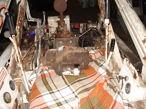

I couldn't find info on removing the starter any where.. here's how I did it.

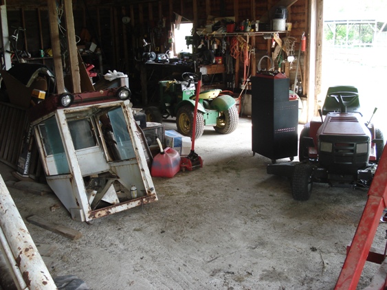

removed the cab had a motor hoist and no helper so it wouldn't go high enough to clear the ARMs so I pushed it over the side toppling motor hoist and cab to the floor but it was off. Tough cab..nothing broke.

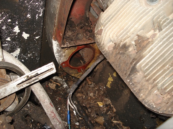

Then I removed the cross bar that holds the generator and removed it. then I could see the starter. I put some wood over the front so I could lay my 230 lbs over the foot area and work with various wrenches to try to get the starter bolts loose.

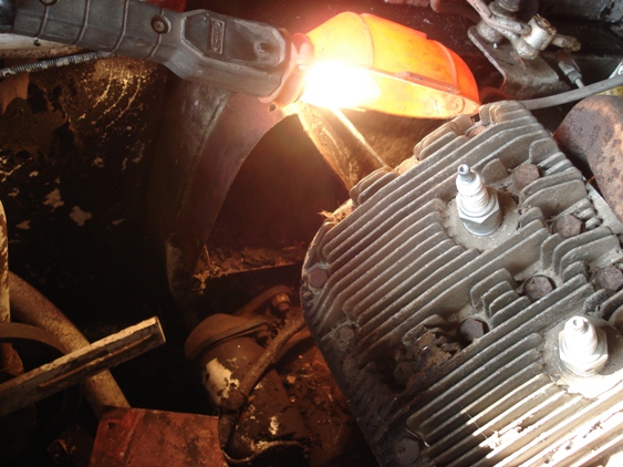

I realized I would have to remove the motor shroud. this required a 3/8 socket and a little bit of work with a sawszall, there are screws inside and outside the heat shroud. after removing the hardware a sawszall was needed to cut one stubborn piece of sheet metal the the crowbar had trouble with.
What I found at this point was that rodents had been living in heat shroud for a long time. I cant imagine any air passed through so I wonder what good is the shroud?
After removing the sheet metal I could get to the starter and hooked a jumper cable to the lead that goes into the starter and gave it a test, and it spun. this is the small screw going into the motor. so the solenoid is bad.
I tried taking it off without removing the starter but no luck. two nuts were east to get to in plain sight and one was hidden underneath, The studs came out for all three. MY craftsman 9/16 long box wrench saved the day.
another other tool that was nice was a pair of small vice grips 5". they helped with the odd sized nuts and saved a few crawls out of the machine.
I found it necessary to put my feet on the bucket and do a pushup to get out. that was good for me but not fun at the time.... pictures follow if I can figure out how to post them...

I'll post another reply once it's in and cranks. I'm wondering wheterh to reistal the cab. I only use as himeowner for scarping driveway and maybe snow removal and to mpve things around in the bucket. no dumping or high work.

I wonder how much the weight of the cab contributes to counterbalancing a load in the bucket (if at all). By removing a couple hundred pounds from behind the pivot point (front axle), you would lose mass that offsets a load in the bucket from tipping the machine forward. At least that's how I see it. If it were me I would figure a way to get it back on. Both for the counterweight value but maybe more importantly for the safety feature of it protecting the operator.

Normally you would not follow the procedure 'istvanv' used to R & R a starter. His did not appear to be 'normal' however with "residents" inside the shroud and all. Generally...the procedure would be to disconnect battery cables and wiring to solenoid, remove front brace on starter (many are running without them) and then use a 9/16 universal (or 9/16 on a universal) and combination of extensions to remove the three starter bolts allowing you to slide starter out. You are working blind most of the time, not one of my favorite jobs on the 600 wisconsin series but I do several every year. No need to move or remove anything else.

still haven't finished bobcat, but starter and generator are back in. I found that rodents have not been on the other side of the motor. they must prefer the inside. some head bolts were also loose. The metal wasn't really that hard to remove just the piece that goes between the two cylinders had to be sawed. only a half inch or so. It's back together. Thanks for the comment about the rear starter support plate. I won't put it back.
