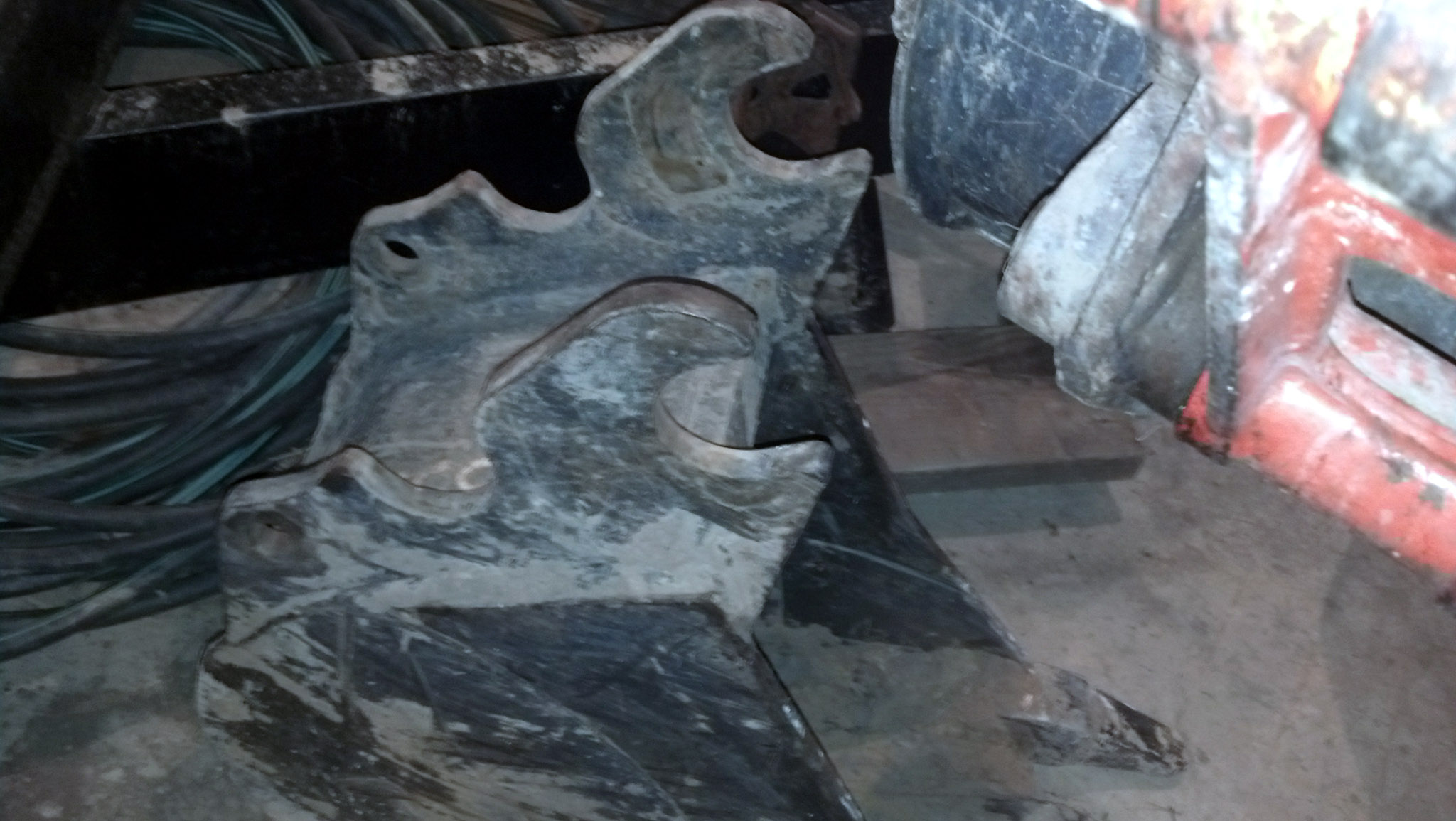

The previous owner of my L39 said the two backhoe buckets I got with it were off a Kubota mini excavator. The buckets are more heavy duty than the buckets I saw on other L39/L45s when I was looking. I have also been told that the Canadian backhoe quick attach is different than the US. So if you find a bucket you like and it does not fit, welding new ears on as lhansman suggest may be the best option.
I'm pretty sure I have the same quick attach. It's a K7770 and it was originally designed for KX mini-excavators and marketed on the L48.

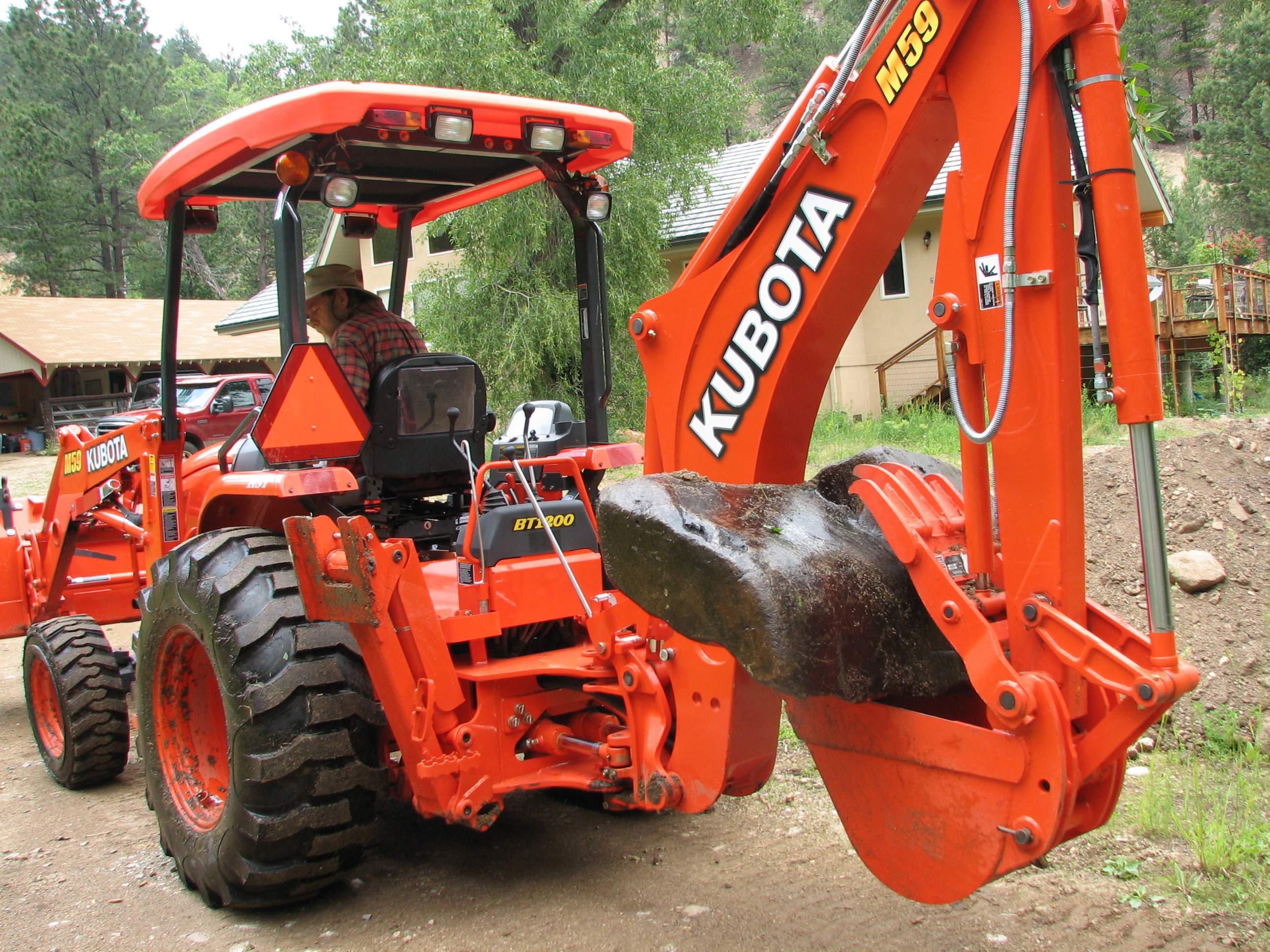

Nice summary; thanks for your work. Maybe someone has some pictures of the M59 options? I'm not sure whether my own early M59 is pin-on or QA!
I do remember that when we got the M59 it had just been introduced and had some extras. One of the extras was that it came with two buckets. These are very heavy duty and have one set of ears and one pin. That kind of ear+pin mounting allows you to stab the ears from the backhoe operators position and then pick up the bucket by lifting the dipper stick. As the bucket lifts up the ears hold it in place whilet the weight of the bucket causes it to rotates into a position that makes the pin holes self-align...then I do have to get off the tractor to slide the pin home.
Real clever system. Thank you Kubota.
Looking at the picture below where I'm carrying a rock with the M59, I think this is considered the pin-on system. The removeable pin is the lowest pin which has a short chrome handle on the end of it - you can see the handle in the picture. In this pic with the bucket mounted the ears are hidden behind the common pivot for the thumb. Anyway, whichever system this is - either pin on or QA - changing buckets with it couldn't be much easier and faster. The other advantage to this ear+pin system is bucket stability. Our M59 gets used for a lot of hard digging in rock and close quarters. Nice to have a tight bucket without side slop.
Not all pin-on and QA are equal. Our big JD310 backhoe has a QA bucket attach system which requires more monkeying with than our Kubota's system. And the additional QA parts add substantially the the bucket's side slop on the 310.
thanks, rScotty
