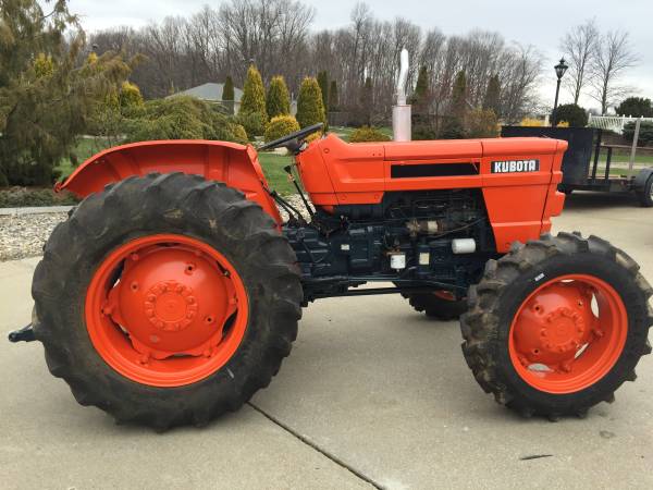

I recently bought a new to me M4500DT in fairly good condition.
It is not equipped with a loader and I would very much like to add one. I did some google searching and the one that I found which would apparently fit is from Westendorf model TA-26. The problem is that the price is apparently $7600.... Given that I paid $8000 for the tractor with a few implements, nearly the same amount for a loader seems a bit outrageous.
Are there any options I am overlooking ? The front end on these tractors seems really strong, so I want a good loader, preferably with a quick attach so I can share implements with my loader backhoe.

The tA-26 is a GREAT loader, easy twice the strength as the Kubota loader. It is worth every bit of that 7600 if that includes the subframe and installed.

Googling M4500 images shows a variety of different loaders have been used on them. Back in those years many tractors were imported bare and paired with US-made loaders. Some were branded Kubota, some not. The M4500 needs a loader frame big enough to reach over and beyond the large front wheels. The good news is there are lots of used Kubota loaders for sale. Westendorfs too. Something needing hydraulic work or brackets should be better starting point than scratch. Good luck and happy hunting!
   / M4500DT aftermarket loader options ? #5
Most cheap loaders aren't going to fit a FWA tractor, or you won't find mounts for said loader for your tractor.
Hate to say it, but likely cheaper to sell and then buy a tractor with loader unless you get lucky!

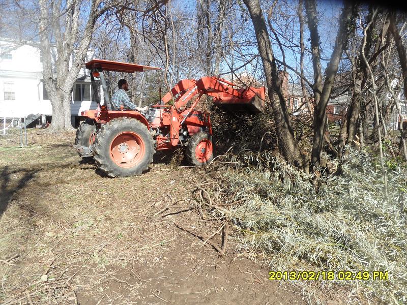

From the past:
What faults if any did the M4500DT have? Anything in particular to look for or ask about when examining this model? Any guess as to a fair price for a 4500DT with about 1800 hrs. and a QT loader? I think the guy is asking around $11.5 for it right now. Thanks.
That was $11.5K in 2008 WITH loader. I paid $11.5K for my M4700 w/FEL (and bucket), canopy and two rear remotes in January 2013.
Yours would be a great tractor for someone that bushhogs roads and fields and does not need a loader.
/edit -
Tractor data lists your m4500 as 4x4 MFWD 4WD (M4500DT), NOT Front Wheel Assist
