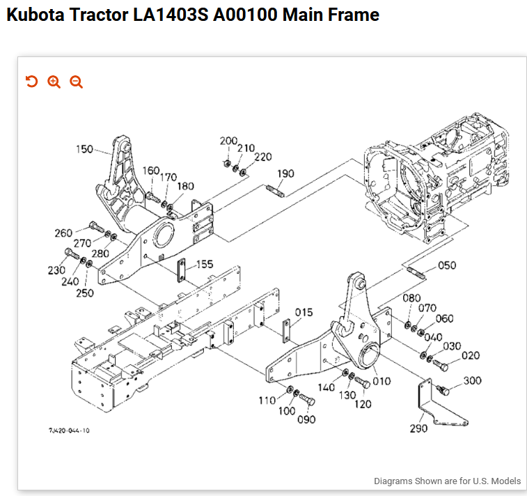

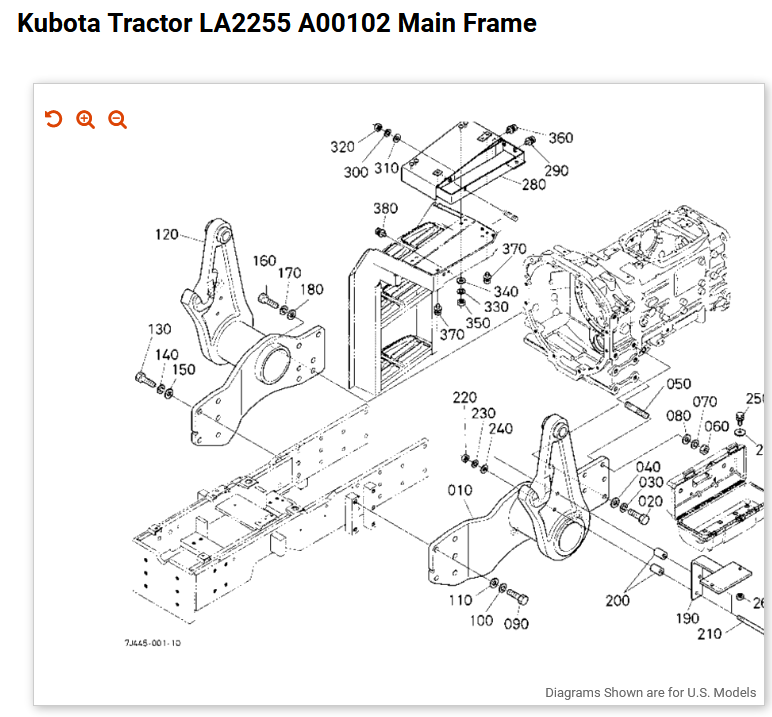

The frame for the M6S-111SHD is 3N800-21710 for the M108SHD it is 3N600-21710. Both tractors use a 3N300-21122 clutch housing.
The M6S-111 uses a LA2255 loader, and the M108S uses a LA1403 loader The loader mounts are different and appear to mount differently. This suggests the frames are different.
What is driving your questions about the differences?
   / M108S versus M6S-111
View attachment 877389View attachment 877390
Thanks, this is excellent information. Just shopping and came across a few M108SDSC with no loaders and a complete LA1944 loader with M6S-111 mounts. Wondering if the LA1944 is closer to the LA1403 than the LA2255. Does look like the frame rails are different between the two tractors.

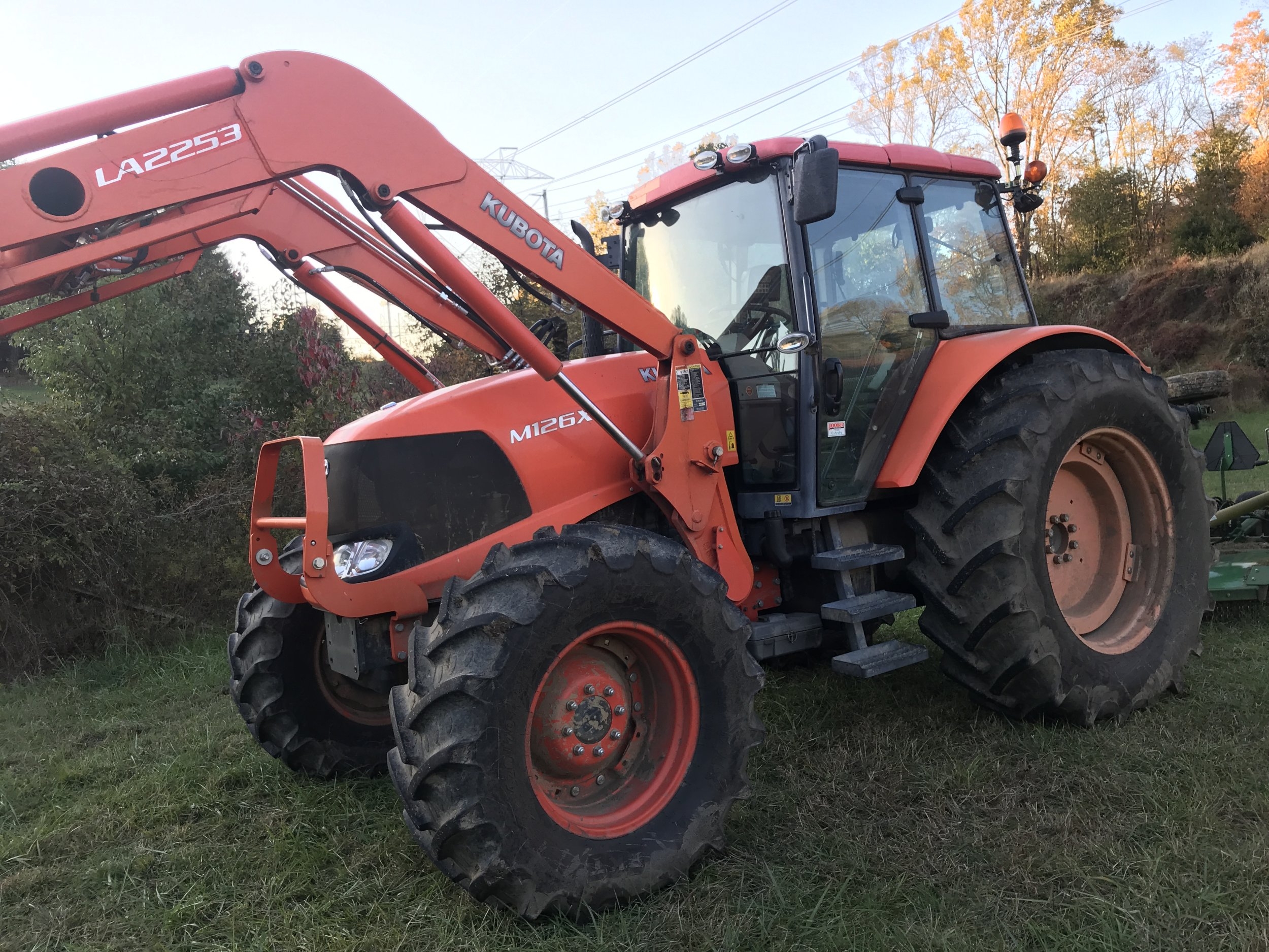

I had 2 Kubotas with LA2253 loaders.
