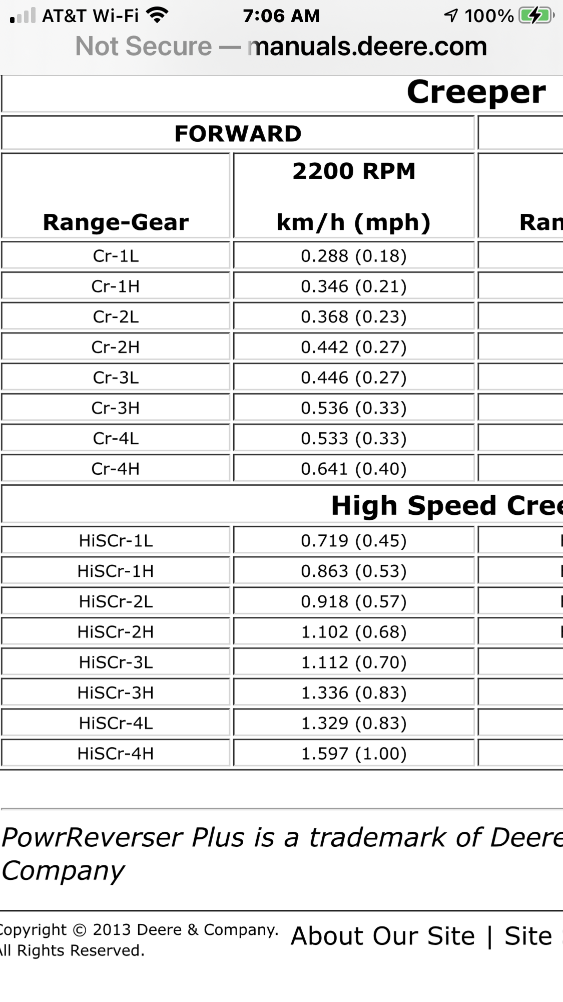

We just have the 16x16 trans. Initially the literature showed we could add the creeper later. It turns out this is not the case and we really could use it on the snowblower and rototiller. :(.
   / M series transmission options #8
Old thread revived : I know I’ll be reprimanded lol
I’ve got two 5k E series 12spd power reverser tractors for poultry house work.
.7 mph @ 1500rpm wasn’t slow enough so I finally bought a lightly used 2018 5115M OS 32spd with 16 (with hi/lo button) additional creep speeds. :thumbsup:
It works great having ANY Speed you need under .7 mph :cool2:
On the earlier year model M : the creeper gear was 8spd No hi/lo button option on shifter
JD hit a home run outta the park IMHO with this $4,600 transmission option & is Extremely Rare to find unless special ordered.
A B C ranges on the 16/32spd M are identical to A B C ranges on the 12spd E.
So No Slower ground speed in A 1 Gear :mad:
The D range on M is a faster road gear for travel.
Poultry House, snow blowing, tilling, trenching & vegetable farming are about the only applications that require the creeper gear option that I’ve found or read.
   / M series transmission options #9
This ground speed chart is at 2200rpm which in E-PTO your not running but 1500-1700 which would be even slower.
Tire Size makes a huge difference too.
I’m running the shorter R4 Tires 19.5-24 which are 49” Tall
