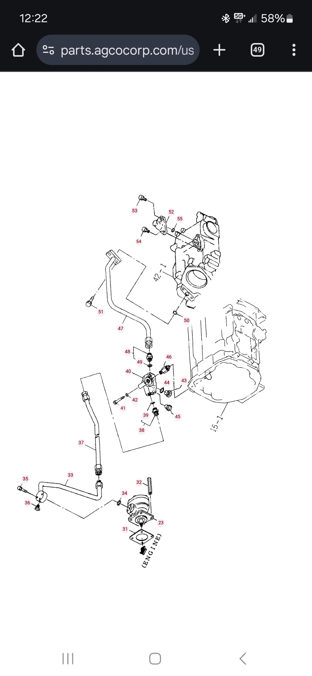

Older MF 1433V.... approx. 3/8" maybe 10mm hard line from pump to valve, flared ends...out of the pump runs straight down, 90 degree turn and straight into distro valve box.....Hose maker was reluctant to replace with flex and fittings.....any ideas where to buy vintage part? Dont understand their reluctance/refusal to replace via flex line
   / M F 1433V Hydrolic hose/line #2
They didn't say why they were reluctant? Steel line will last longer, but...
#33 - 4260837M92 PIPE ASSY,DEL,FRONT
Search results for: '4260837M92' https://search.app/NccDfyg2Uk5RW6ij6
