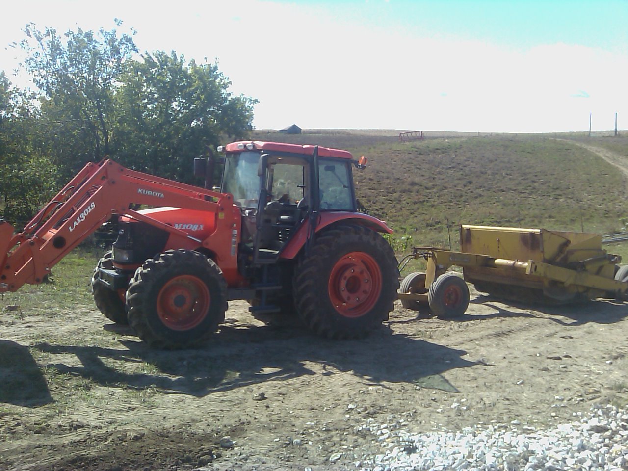

I got to run 108 (same as 105 it think) last year pulling a small 6yrd scraper and it was an assume tractor. I also used it for some loader work. It was very smooth when shifting I was using it on some steep slopes and it worked very well. Only wish I had enough work to have one in my shed. Any question on it ask
