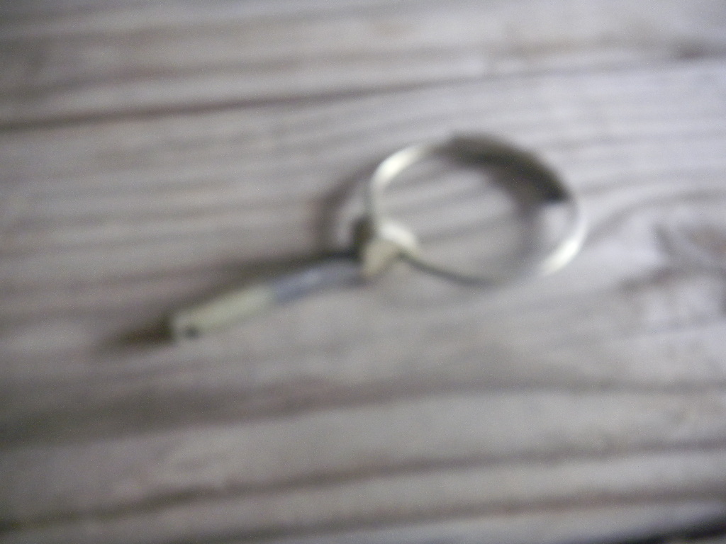

John Deere AL114597 The ring threads into the hole at the end of the pin
