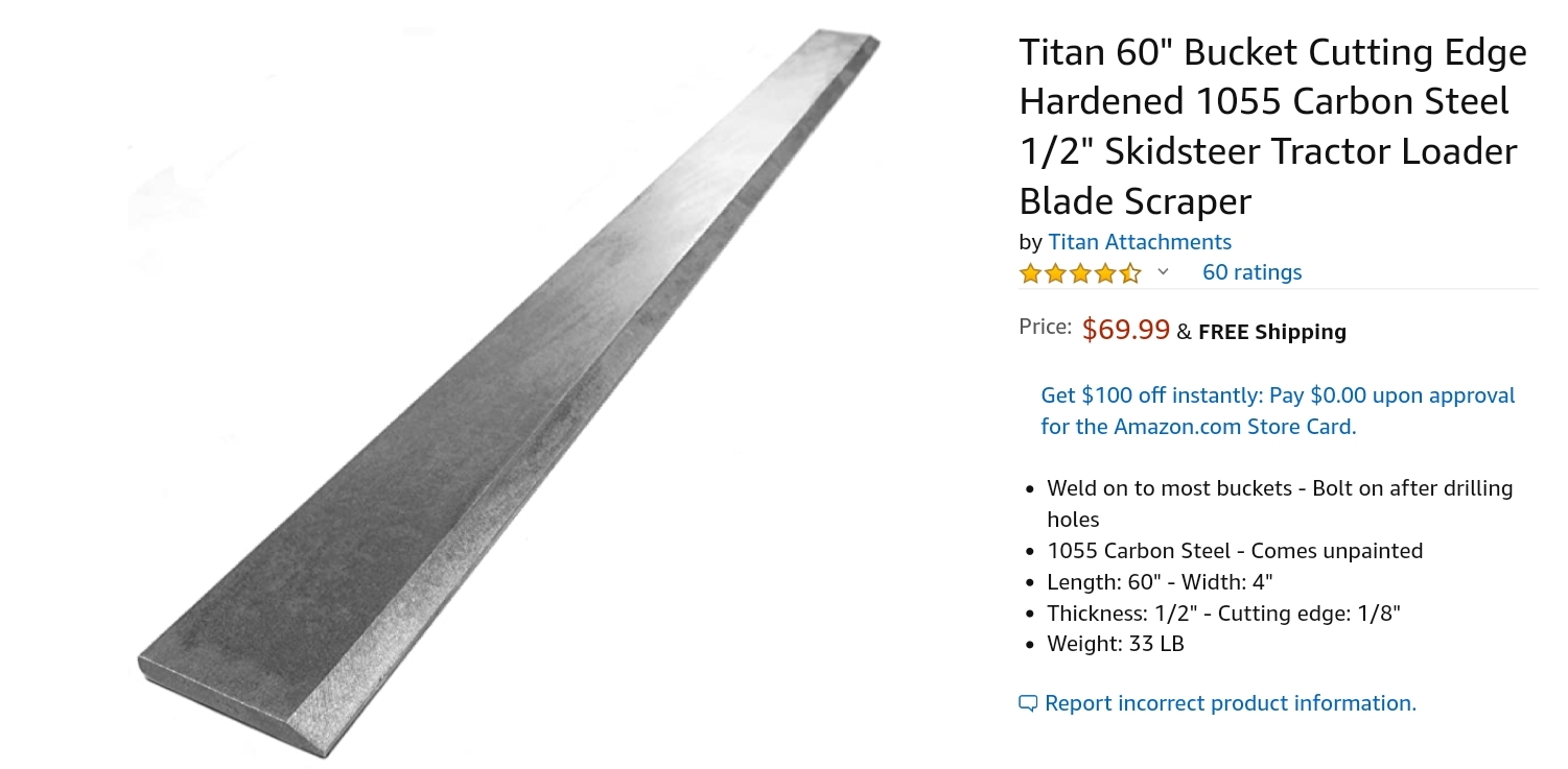

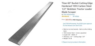

54 inch bucket weighs 176 pounds and comes pre-drilled for an optional Kubota cutting bar. The 60 inch bucket weighs 189 pounds and no optional cutting bar. People do add non Kubota cutting bars.
My 60 inch bucket is labeled light material use and it definitely is a lightweight built bucket. No wear bars on bottom. Thin and narrow cutting edge. This is on a narrow loader and if your doing serious cutting a 54 inch bucket would have a much greater safety factor to protect the loader from twisting. Compared to the NH tractor with 54 inch bucket I previously had it had wear bars on bottom, thicker and wider cutting edge, more reinforcing, and heavier gauge steel.
For serious loader work get the 54 inch bucket with optional cutting bar added. Or get someone else's bucket. I'm currently looking at Durattach 54 inch buckets. Will probably add wear bars on bottom and weld on cutting edge to the 60.
The 60 inch bucket is fine for hauling mulch and use in loose material.

   / LX3310 with BH77 Seat Question #7
Going to weld this on to the 60.
