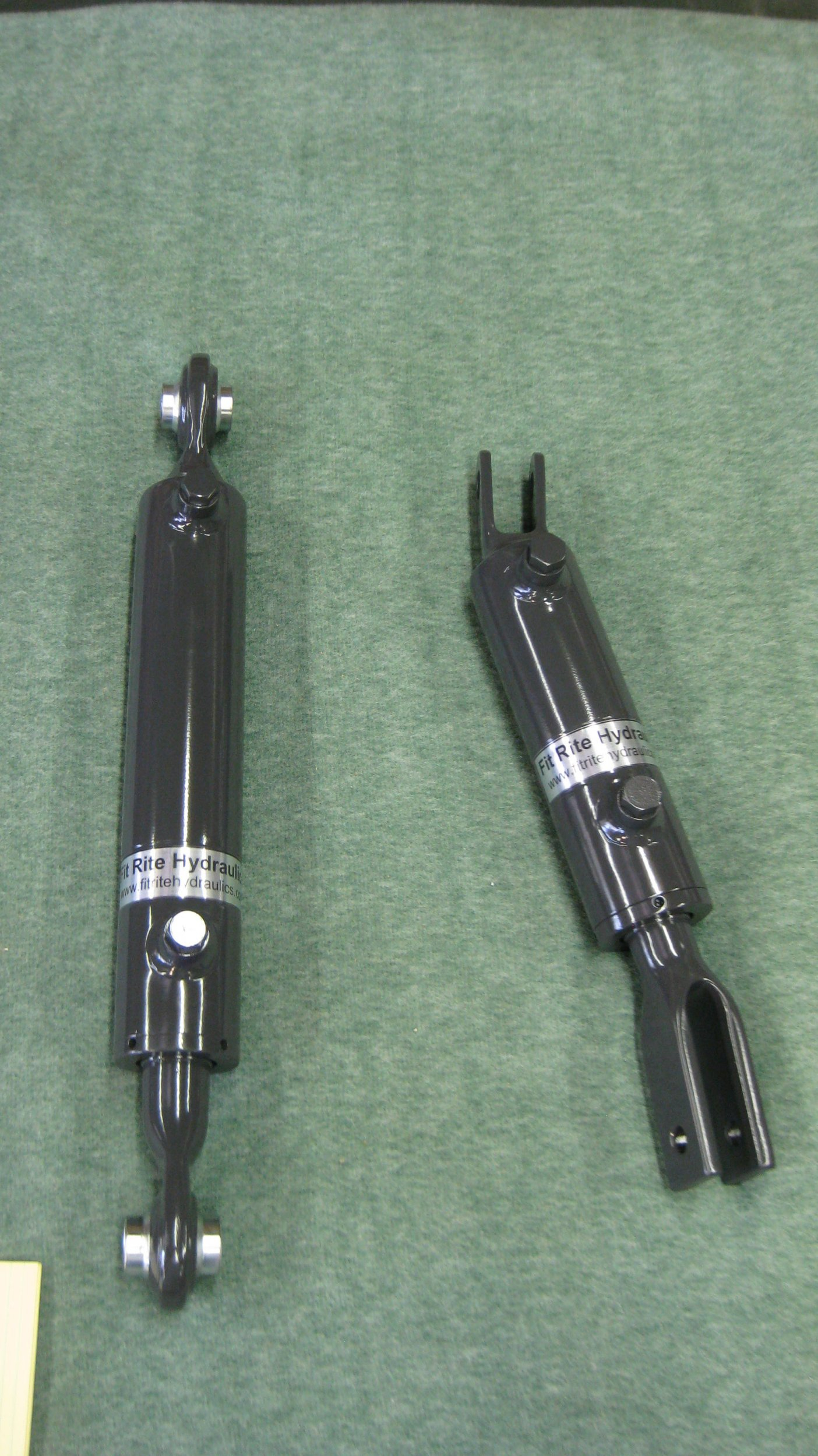

Hello Everyone, I purchased the LX2610 not long ago, ordered a 3rd function and dual remotes, I wanted to add a Top N Tilt kit but couldn't get one at the time, dealership said they'd have to put one together. So I'm in the process of putting one together now, I have the hydraulic top link but the side link has turned out not to be so easy. There's plenty of videos on the top link installation but I haven't seen one yet that has a side link for the LX2610, it has the double offset Clevis mount. I've checked Agristore and others, of the stores that carry the side cylinders, none have the dual offset Clevis types, has anyone done the hydraulic side link on the LX2610 ?

You have the same problem that many of the rest of us do, regardless of tractor model. The side link generally has to be well engineered and custom fabricated. As in, having the right angle and size of clevis mounts, and welding those onto a proper short stroke cylinder.
Best bet is still Brian at fitrite, if you can wait.
Thanks for taking the time to reply, I'll check with him.
   / Lx2610 Top N Tilt Kit #4
Do them all the time.
Just need to get in line.
