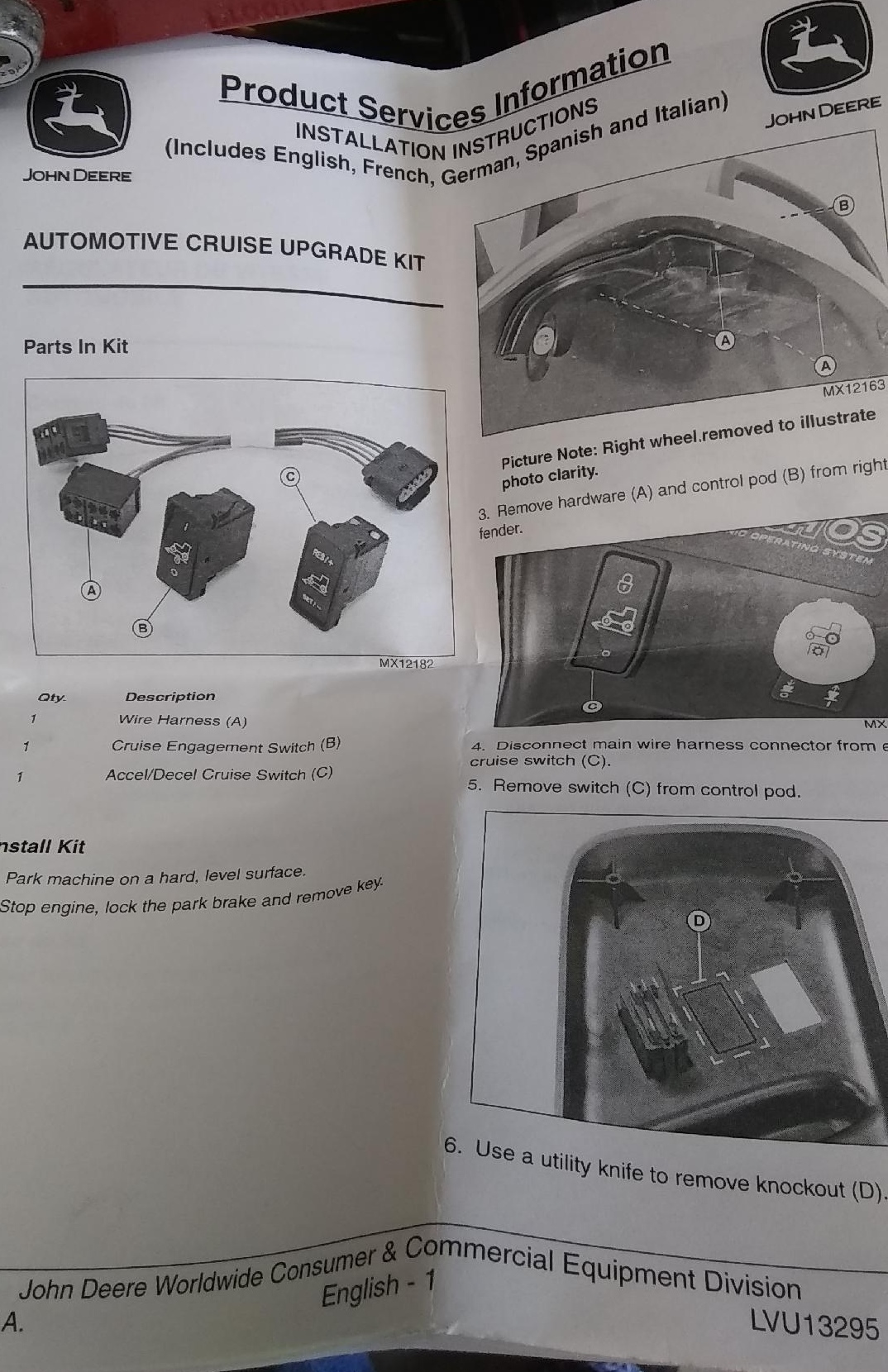

The kit arrived today. Included was two switches, a wiring harness, and instructions. Apparently the console will have the position for the second switch outlined underneath so I can just cut it out. Looks like it's supposed to be plug and play. Instructions just say to use the new harness and plug in the two switches then test operation.
