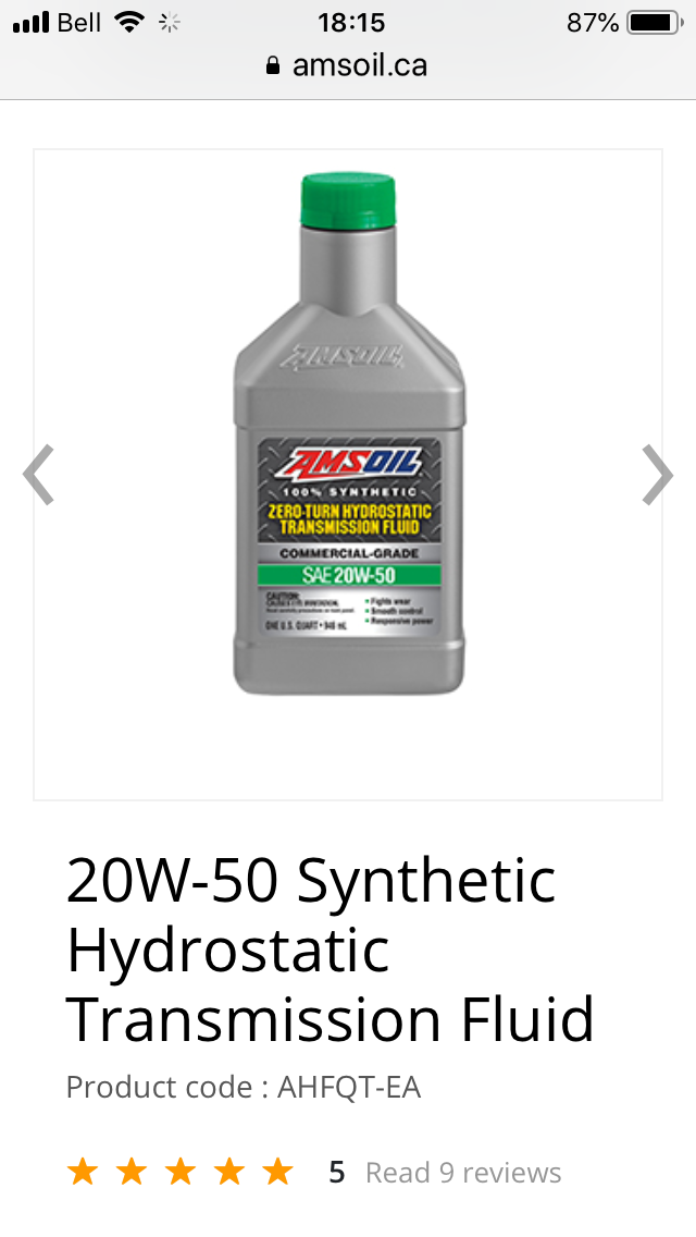

I believe HST Oil in the Kubota ZD21 is a 20w50 weight Oil. This.... Dutchy
