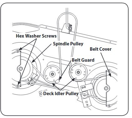

Just got my mower running after fixing a few issues and now it's at it again. First off, I would like to point out that the belt would occasionally slip off when I was on an incline. I thought the belt was the problem so I purchased a new OEM belt. Unfortunately, the new one was doing the same thing so i dealt with it for a while. Recently, my mower chewed up both belts and the deck was vibrating. The belt also pushed and bent the belt guard. Can anyone chime in on this?

When you had the mower in for service, was the belt issue one of the things to be fixed?
As boggen mentioned, make sure that your deck spindle bearings are in good shape. Also vibration could be caused by string or plastic wrapped around the spindle.
Here is a screen shot from the operators manual:
Make sure that this bracket is in-place and is in close proximity to the pulley.

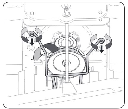

Second photo from operators manual:
Make sure that the part labeled "belt guard" is in place.
