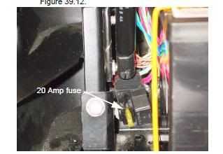

Sounds like the relay for the PTO is bad. Should be next to the fuse. See the black cube in the image below.
