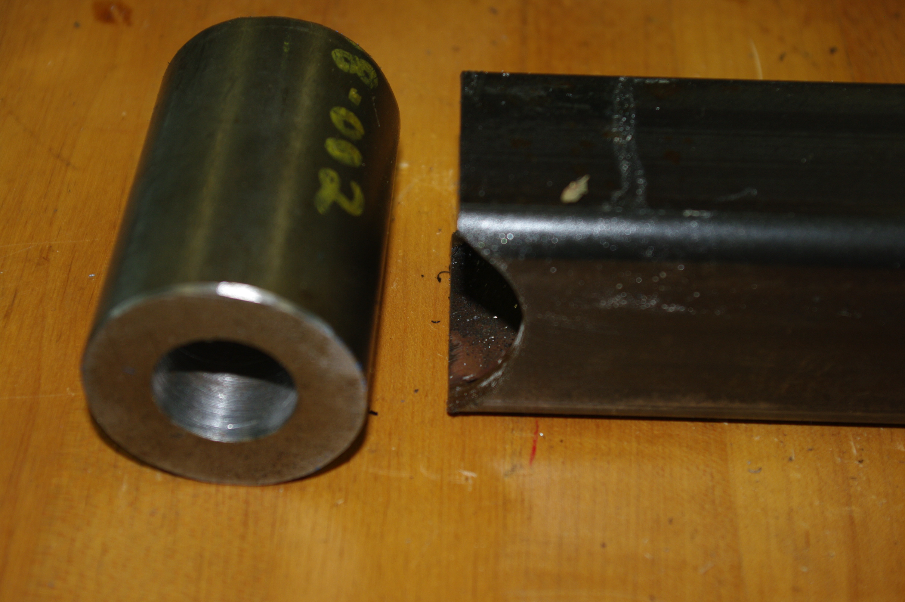

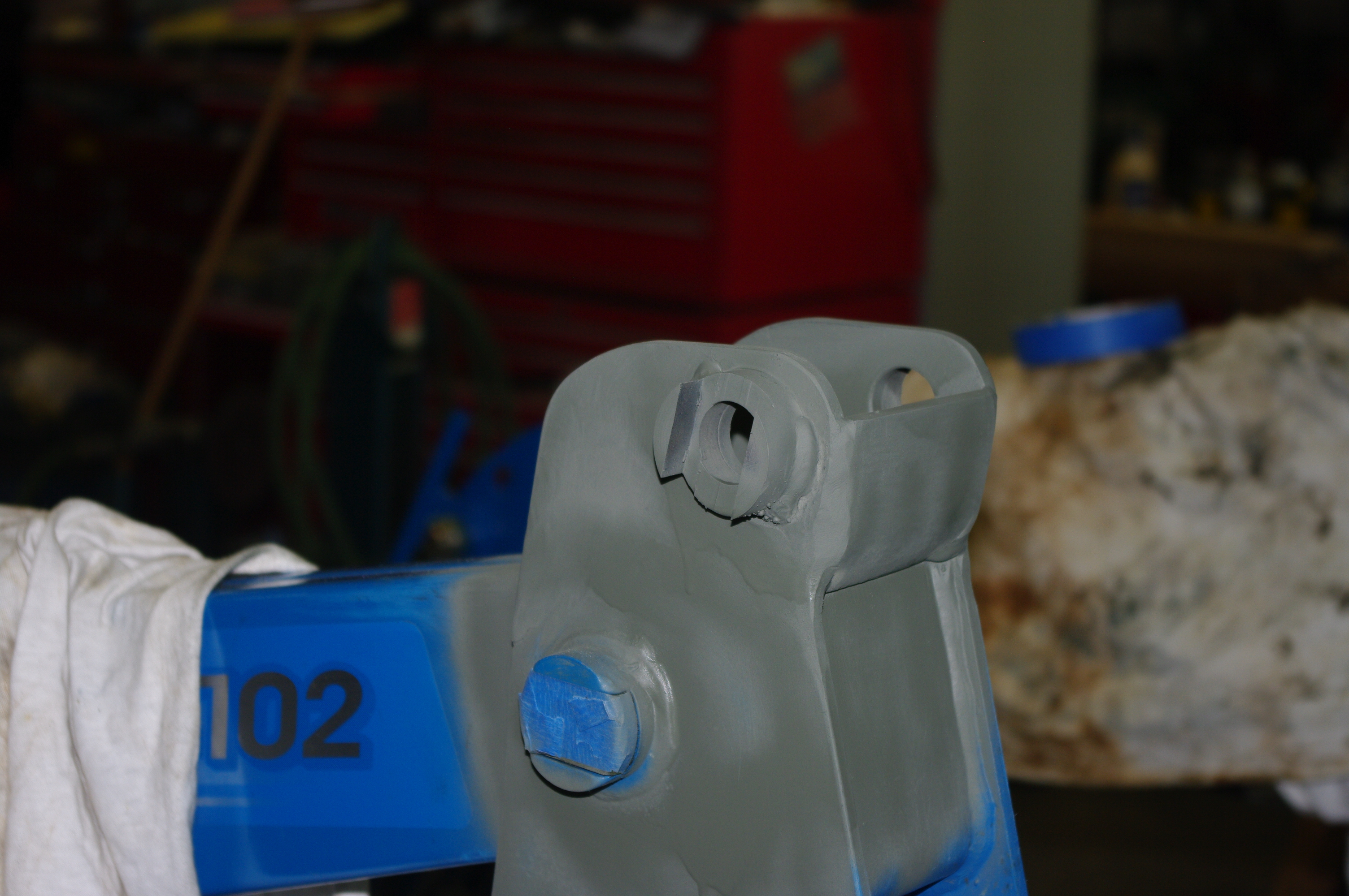

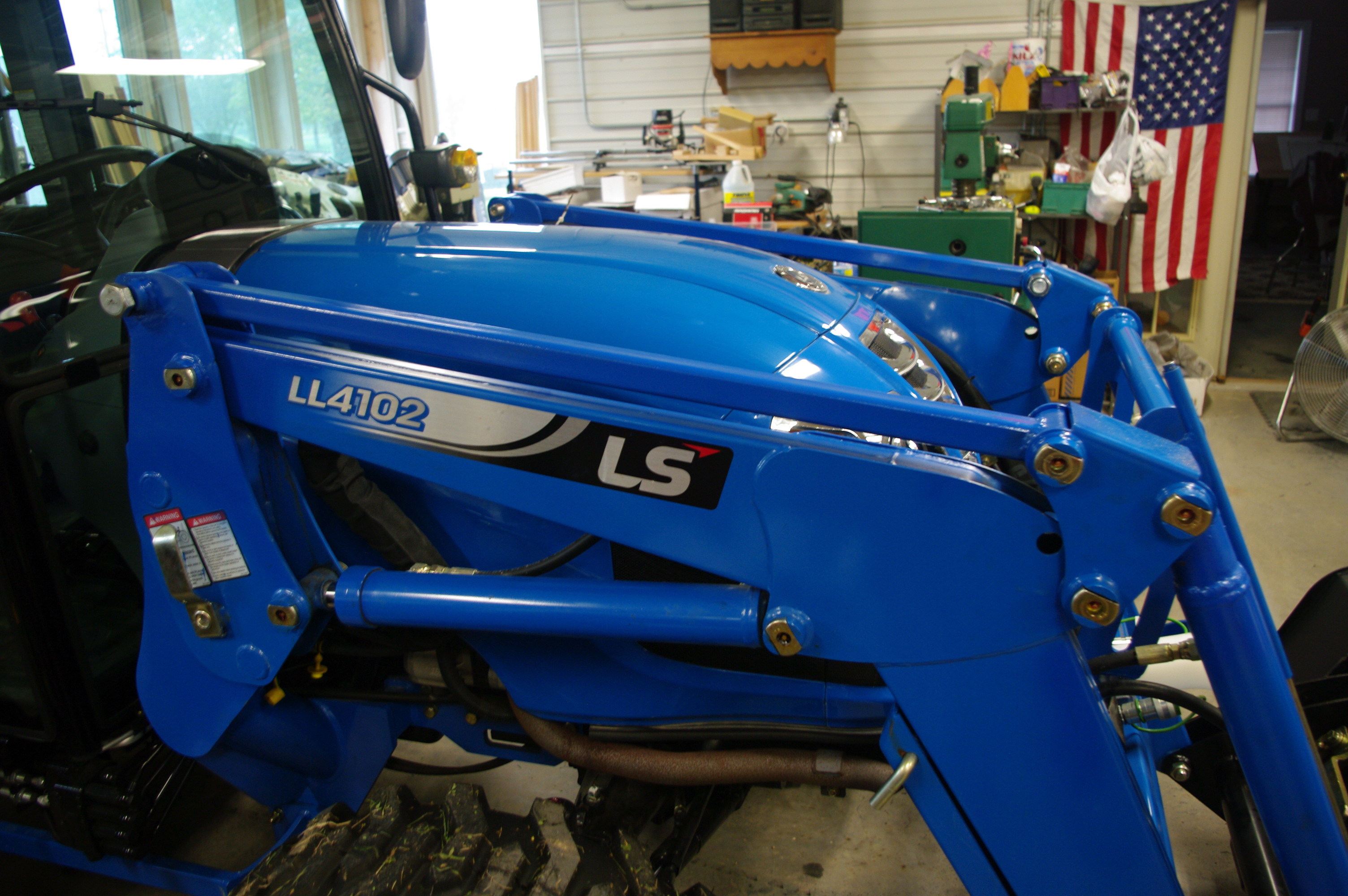

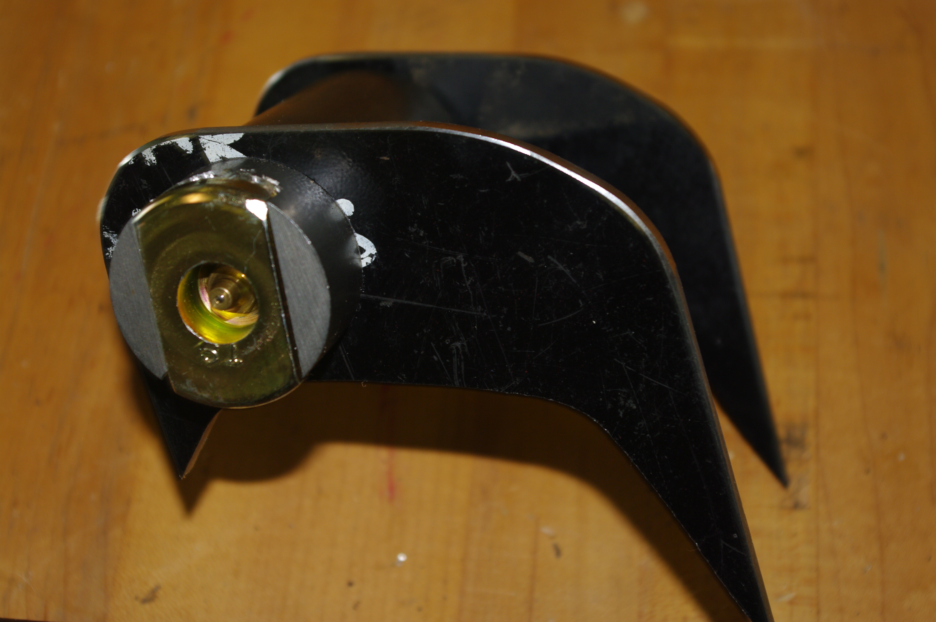

The first photo is what it takes to convert to self leveling. Some I machined from raw material. I bought the pins from LS($15 each x 8), the rocker boxes came from LS at $82 each.
I wanted a 4 degree roll back at the high position so it took some math and still had to tweek it by trial and error before welding. The position of the upper pins in relation to the lower pins controls the geometry.
The cylinders had to be extended.
The pivot points for the rocker boxes needed to be modified and reinforced.
I built a simple jig so that the parallel arm ends were kept in precise position. The ends were very time consuming ie drilling 8" in steel. I have since discovered DOM tube which makes the process simpler and cheaper.
The hydraulic hoses were too short and needed to be lengthened.
Used genuine LS paint but found that Krylon safety blue is 1/4 the price.
The last photo should be the finished product. It has been in use for 2.5 years without a problem and have lifted over 2000 lb chunks of concrete on forks.
It was a lot of work but that is how I have fun and in my opinion, it was worth it.
