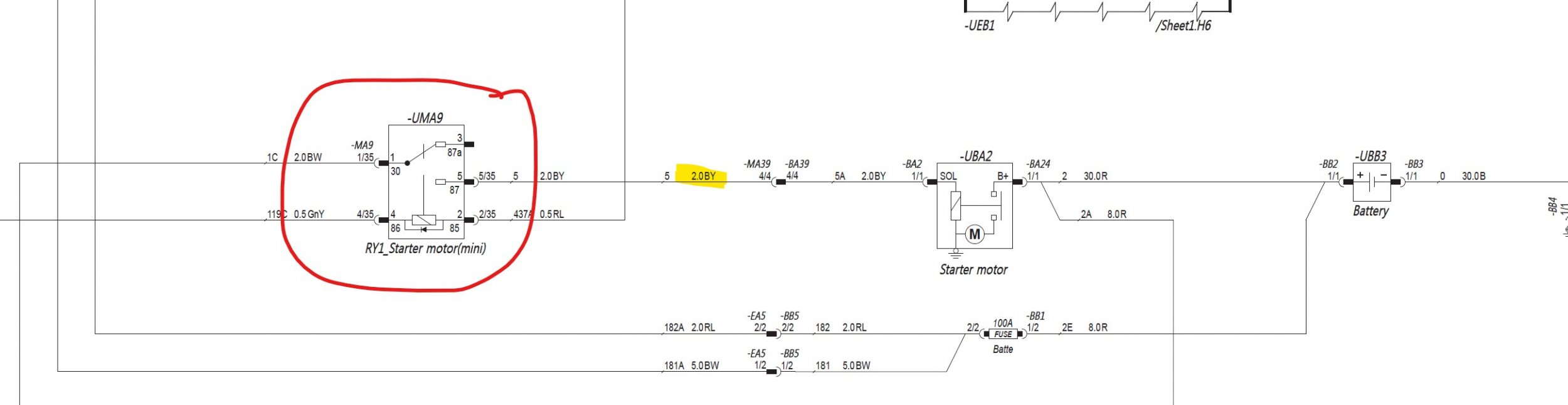

Update: I have confirmed that I'm not getting any voltage from the signal wire at the started to tell the starter to operate. I'm pouring over the wiring schematic and have decided that I need to locate the Starter motor(mini) whatever the hell that is?
The signal wire is black with yellow strip so I'm pretty confident this is the wire I highlighted below. I don't know what this Starer motor (mini) is, it looks like a relay but everywhere else in the schematics where they show a relay, they also call it a relay. I want to locate this item and see if I can replace it working my way up the wiring harness.

That is the starter relay. When the key switch is held to the start position you should have 12 across pins 4 and 2. If not the problem will be a ground or the Key switch. If you get power there you should have power across 4 and 5 with key in start position. If not then you should see power with the key in the run position across 4 and 1. If you have power across 4 and 1 but not 4 and 5 then the relay is bad.

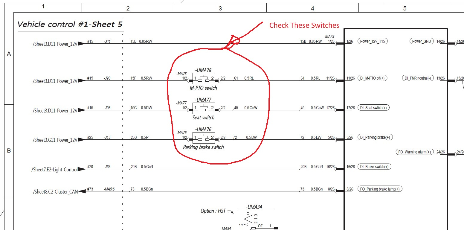

/ LS XR4145HC starting problem.... #30
I would have thought there would be some "safety switches" in the circuit for the starter relay to be energized like the tractor being in neutral, the PTO not engaged, parking brake on, seat switch being made like someone is sitting it......

Theclimer, when you say verify, if you mean simply by making sure the PTO is not engaged or making sure I'm sitting in the seat etc., yes we have done that. Are you talking about a different way to test them?
Making sure the PTO was not engaged or that someone was in the seat was the first thing you needed to confirm. But without using a meter to verify the switch is being made or bypassing these safety's you have not eliminated them as being the problem.
In addition to the ones I circled I'd have to believe you also have a switch to determine if the tractor is in neutral and that the main PTO is not engaged, I did not look further at the electrical schematics for these.
