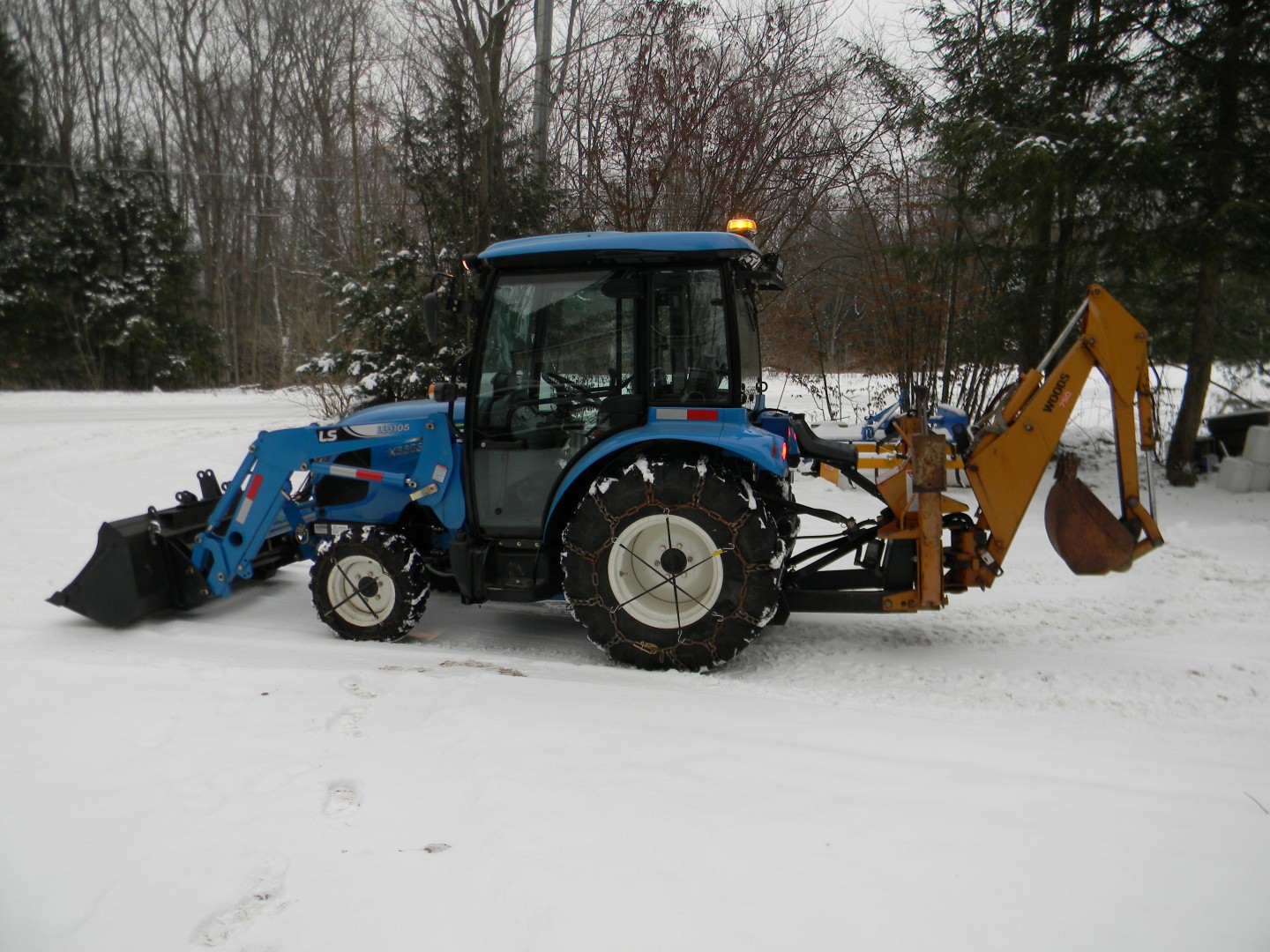

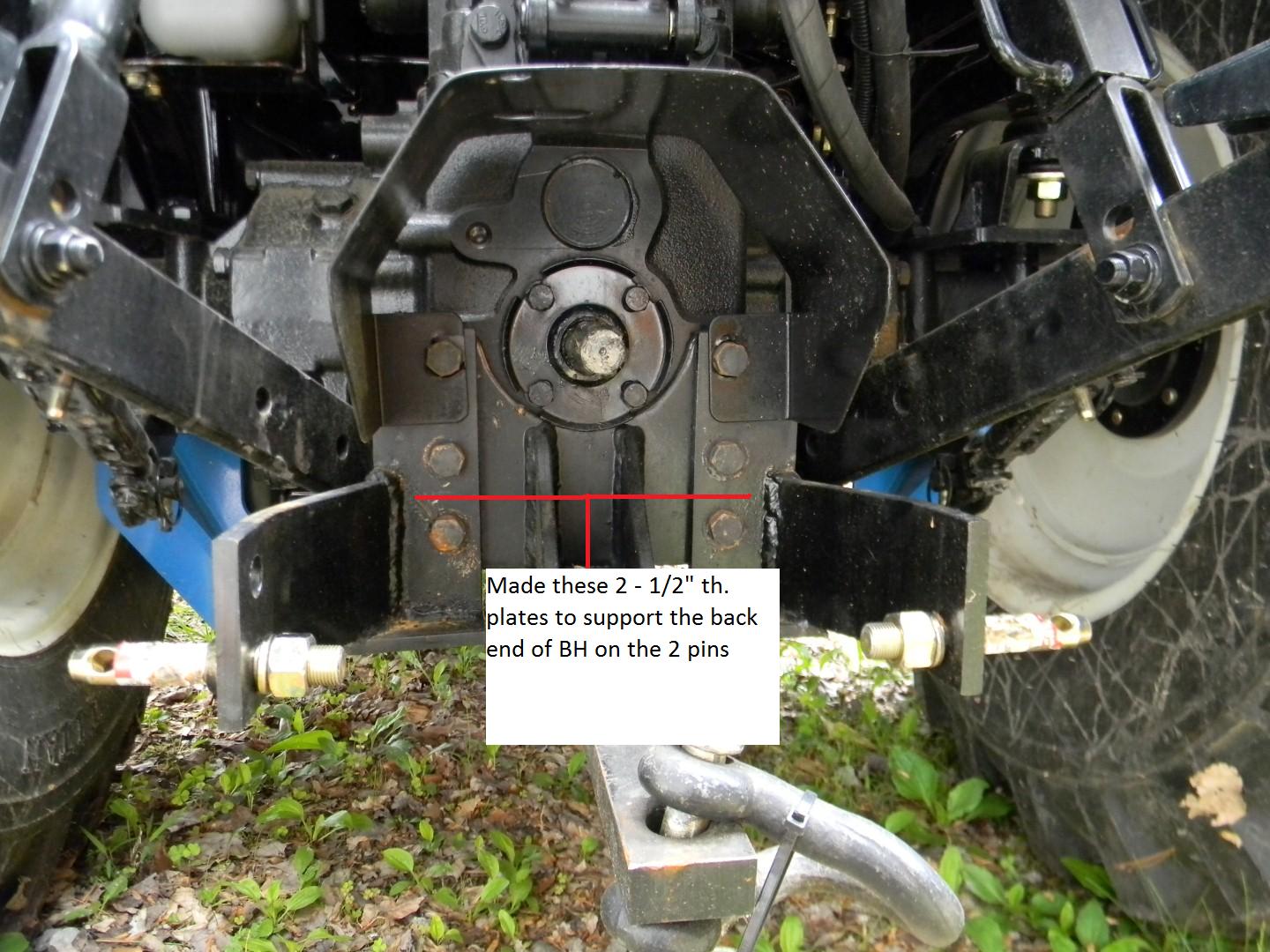

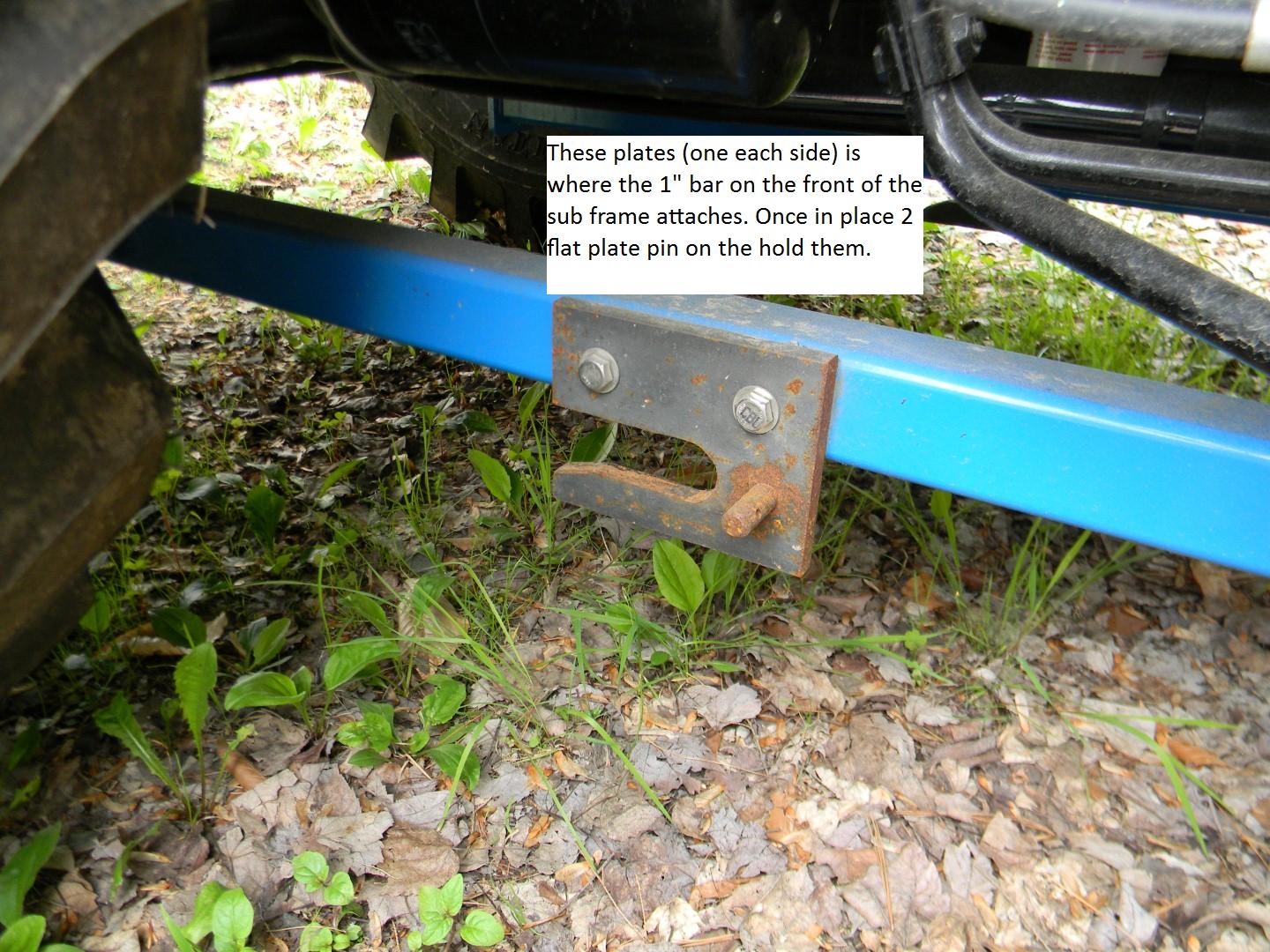

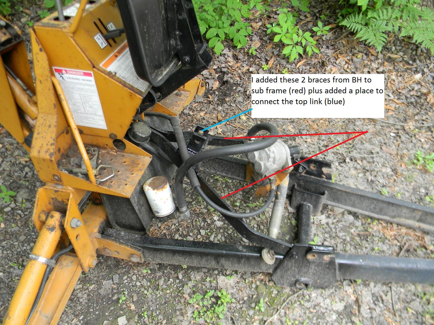

I don't have the factory BH but bought a used Woods BH750 that came with a sub frame for another tractor and PTO pump for my XR3037HC. I fabbed some 1/2" thick steel plates and bolted them to the 6 PTO bolts for rear support (replaced the 6 bolts with longer ones to account for the extra 1/2"). Then made 2 brackets and bolted them under the tractor to the loader frame. Added 2 steel braces to the BH. The BH750 is supported entirely at 4 points where the sub frame connects to the tractor plus added a HD top link for a 5th point. I will post pics if anyone needs them.
   / LS XR4000 Backhoe Attachment
Sounds like quite a project. How far does the frame stick out from the backhoe when it's off the tractor? I'd enjoy seeing any pics you have.
   / LS XR4000 Backhoe Attachment #4

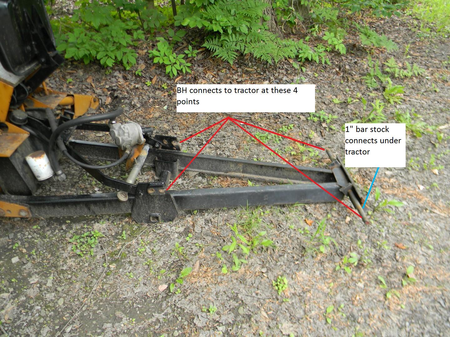

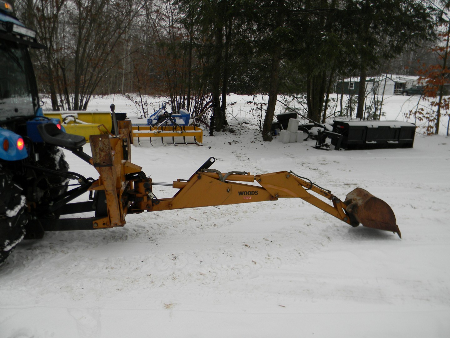

The sub frame is attached to the BH and stays with it when it comes off. The sub frame connects to the tractor at 2 points underneath and 2 points in back (3 if you count the top link). Can't post pics from this computer but I'll post some pics when I get home later this afternoon.
   / LS XR4000 Backhoe Attachment #5
Here's some pics of my BH750 and how it attaches to tractor.
Wow did you have a hard time getting it all to line up?
   / LS XR4000 Backhoe Attachment #7
Not at all. When I bought the BH I backed up over the sub frame and used floor jacks raise the BH to figure where it needed to be, then figured what brackets I needed to make support the frame.
I'm in no hurry when I hook it up. Usually takes about 5-10 minutes. Over time the BH hydraulics lose pressure so BH may not be at same height as when I took it off. I usually back up close enough to engage the PTO pump then adjust the BH hyd. to get the front 1" bar and rear at the proper height to line up with my mounts. Once there I back up and put the locking pins on to hold it. Unhooking only takes a couple minutes.
