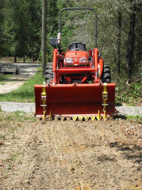

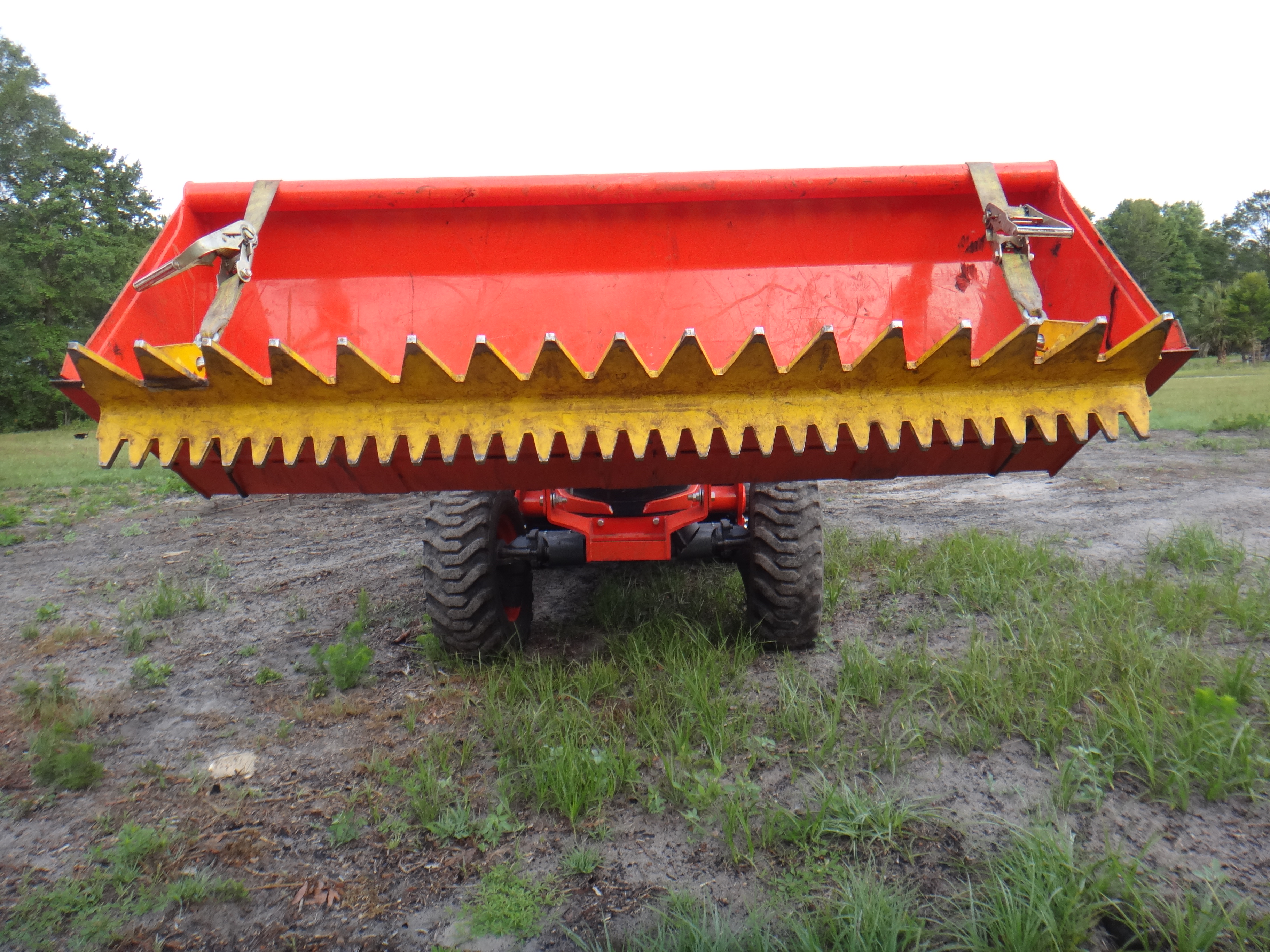

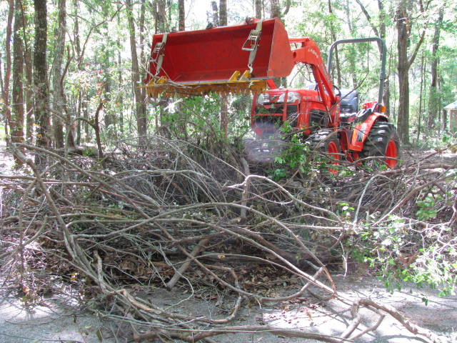

A Ratchet Rake attachment on your bucket will improve brush/sapling knockdown and drag out same by roots, increasing interval between maintenance mowings. RR will reduce probability of bending a blade on your Rotary Cutter. RR is better than a Landscape Rake for piling debris.
TSC sells the Ratchet Rake but TSC's inventory is sporadic, at least in Florida. Alternatively you can order RR "drop ship" from the TBN STORE, agent. No sales tax.

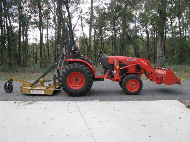

* Don't know right term for it, but lever to adjust rear attachment height is just up/down. There isn't a down stop. I found if I wanted box blade up just a little to spread gravel a little thicker, it was hard getting it at same height. Same for bush hog but I wasn't concerned if there was a small difference in cutting height for that stuff. If I were trying to make the bush hog finish mow and go for pretty I think it would be difficult if there was ever a need to raise it and then try to get back to same exact height.
This is called POSITION CONTROL. Many light tractors do not have Position Control. You may wish to consider CHECK CHAINS:
http://www.tractorbynet.com/forums/...ta-b3300su-zerco-check-chains.html?highlight=
