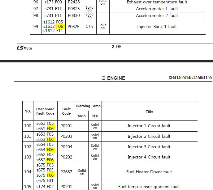

I have a 2017 LS XR4155HC - Bought it used about five months ago. It had 624 hours on it when I purchased it. It now has 664. Today I was using it to bush hog. A red light came on with an error code of F06 flashing. Also shows a display of something that looks like a manual or book with a small 's' under it. A red light is flashing on the display. That red light is the only thing referenced in my owners manual. It says it is an engine error. So I suppose I need to find out what F06 means as far as an engine error. I can't find anything on it. Can anyone help me?

The main thing that comes up is "Proportional Reducing valve solenoid circuit cut-off or short"
I did see one mention of a temperature sensor.
   / LS Tractor issue #3
Looks like its an ejector issue.
If you can get read the 's' numbers, it might help figure it out.

Also, get the ELM327 Bluetooth code reader:
and use an app called Torque
Torque Pro (OBD 2 & Car) - Apps on Google Play (there is a lite version that is free, but I recommend the pro paid version.)
Not sure if Apple has the app, but I'm sure they have one similar.
Use this app and reader to read the 's' code (which is what the light is directing you to do) and go from there. Please keep us posted.
   / LS Tractor issue
From what you have forwarded it does look like an issue with one or more injectors. I may try a good diesel fuel additive that cleans injectors to see if that might help before I go further.
