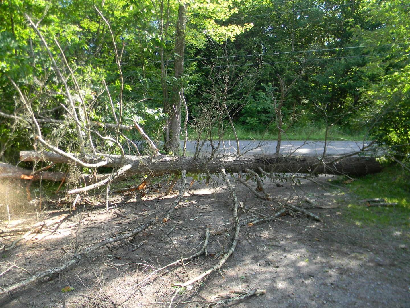

Good test. Seems like you are at your maximum since you couldn't curl. I haven't had to lift anything that heavy yet. Most of what I've lifted has been under 1200 lb. except an old pine tree that was cut down. 20' long by 24" dia. It was heavier than 1200 as it made the rear end real light but no clue as to what it weighed. That was when I didn't have the rear tires loaded, just the counterweight of 850 lb. I'm sure one of these days I'll find my max lift capacity.

Just FYI ... If that 20 foot pine was 24 inches in dia on both ends, that logs weighs about 2,300 pounds!!
The tree is still here. It actually measures 20" at the base and 16" at the 16' length. Not the 24" x 20' I guessed it was in my previous post. I'm am guessing it was still over 1500 lb.
Yeah, it has to be over 1,500. My counterweight started out as a 1,300lb block of steel I bought from the scrap yard (weighed exactly 1300 on the nose). When my neighbor and I were going to start welding on it, I had to move it with the tractor, but had nothing on the 3pt. I lifted it with the pallet forks and the rear tires were very, very light. With 850lbs on the counterweight, the tires would have been solidly planted, I'm sure.
