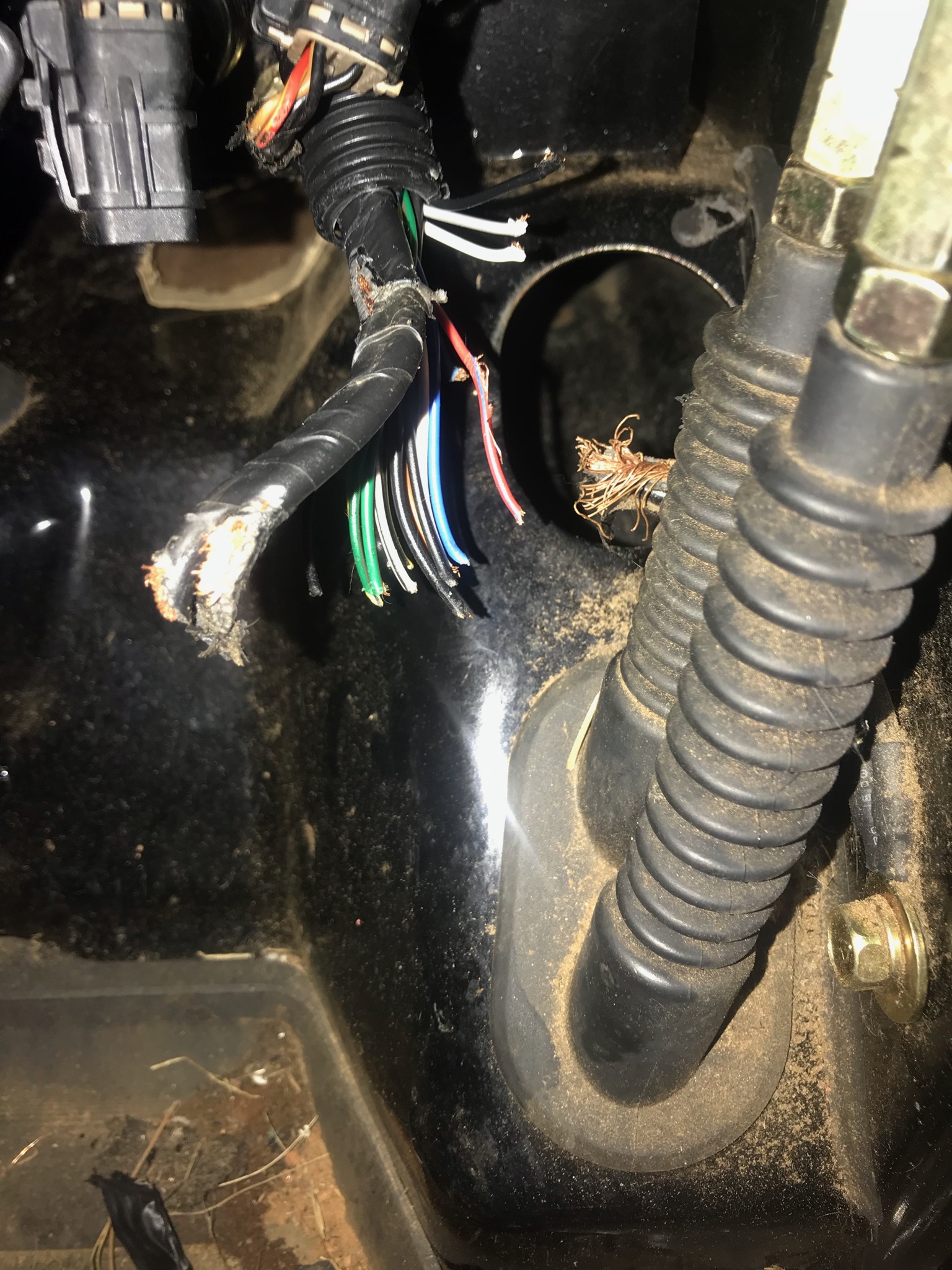

OK, brand new battery, 2013 LS 3037C tractor.
Put in key, turn to the ACC, and tractor attempts to turnover for about 2 seconds and then nothing. Cannot warm up plugs at all.
Turn to START, nothing.......
Only does something when the key is in the ACC position but only for a few seconds.
Here is my dilemma as well, it is remotely located, has a FEL, parked in our shed about 1 mile from road. Do I remove the FEL and tow to road and winch it onto trailer, and then take to shop?
My opinion is it is an ignition switch; or obviously something electrical, but WHAT and WHERE do I start?
HELP>>>>>>>>>:mad::confused3::confused3:

Seat switch perhaps?

I don’t see how it could be anything other than a defective ignition switch, or perhaps damaged wiring.

You assume it was working fine in Jan. You say the battery needed replacing due to needing to be jumped. Did 'jumping' the battery get it started?
Did replacing the battery at any point start the tractor, and get it running?
What does the red text mean? '...attempts to turn over in accessory position'? for 2 seconds then nothing? It either turns the starter over or it doesn't. Which is it doing?
Why do you suspect the ignition switch? Does it have a seat switch, and if so is it wired to prevent starting unless in neutral?
I don't know your tractor- is it a manual or HSt or shuttle shift?
Post back answers to all questions.
Also, to remove the FEL wouldn't you have to lift it? How would you do that without starting the tractor? You could remove the bucket or whatever might be on the FEL, and then tow it to your trailer. Can't you bring the trailer to the tractor, and then winch it on?
And, do you have any rodents where it sits in the shed?

It sounds like you have a bad connection someplace; the most likely place is at the battery, if not then start working outward along the circuit. First though, you should reply to Coyote Machine's questions above, it could save you a lot of unneeded diagnostics.
