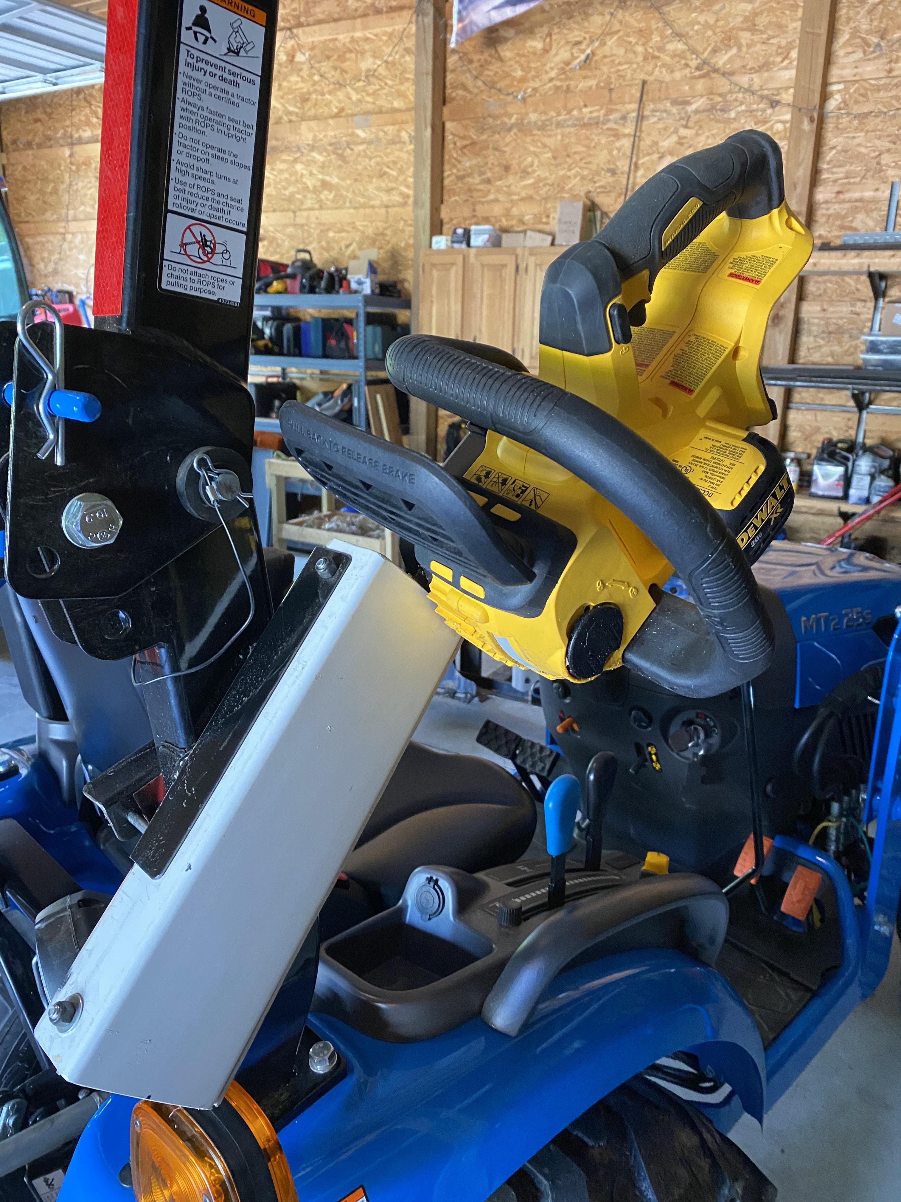

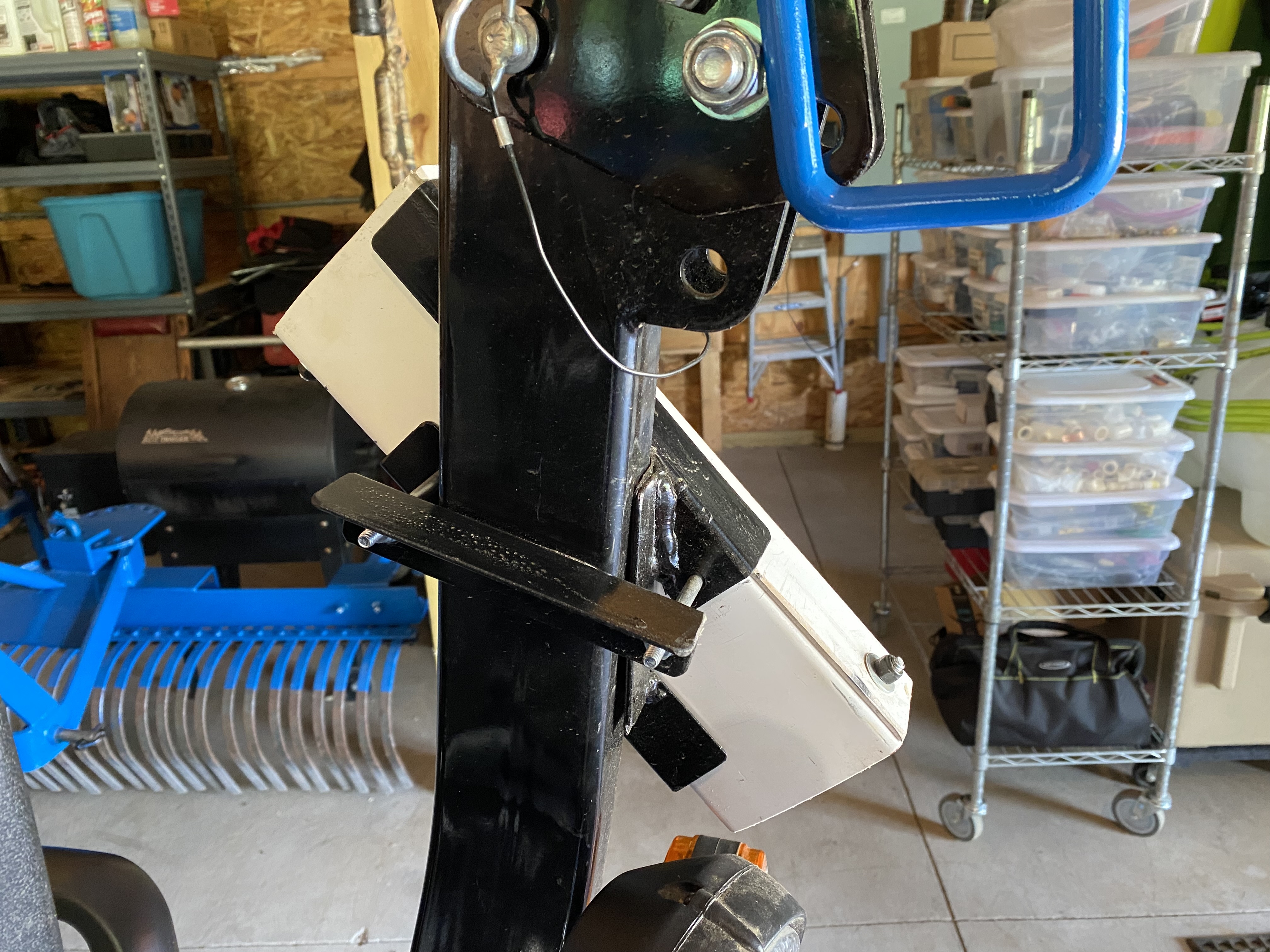

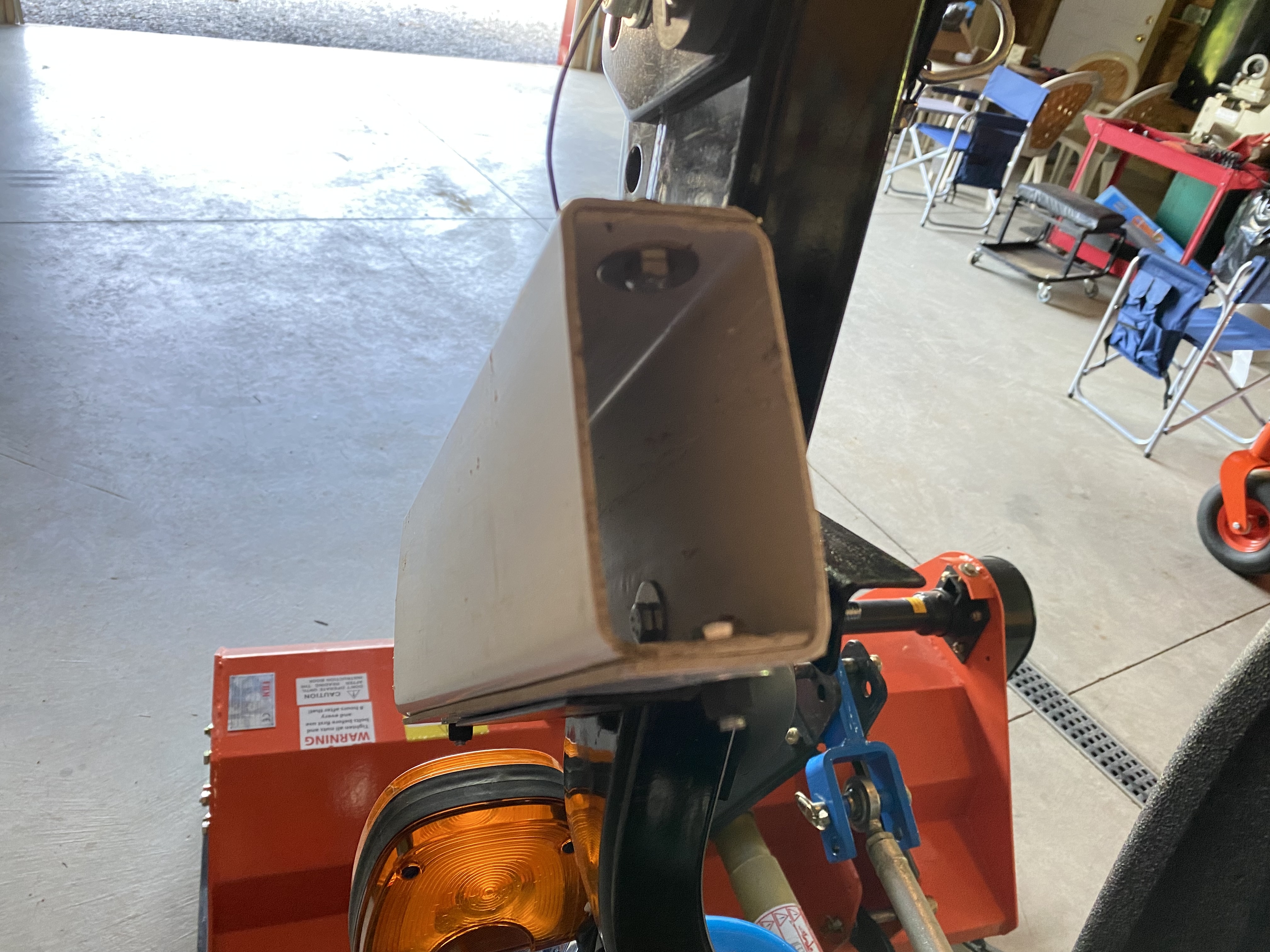

Re-purposing scraps is one of my favorite things to do. I decided to make a small mini-scabbard out of an old bed frame and a piece of 4" square vinyl post. It was nice having it on the Loader control side of the tractor that is out of the way and angled for easy saw removal. A little welding, some bolts, rubber tape and it's done. The rubber tape prevents paint scratching on the ROPS. I am completely impressed with the capability of the little Dewalt 12" electric saw.
