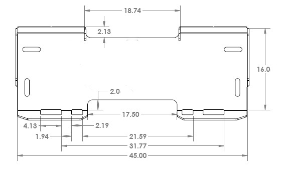

Don't know about LS so here is the standard SSQA:

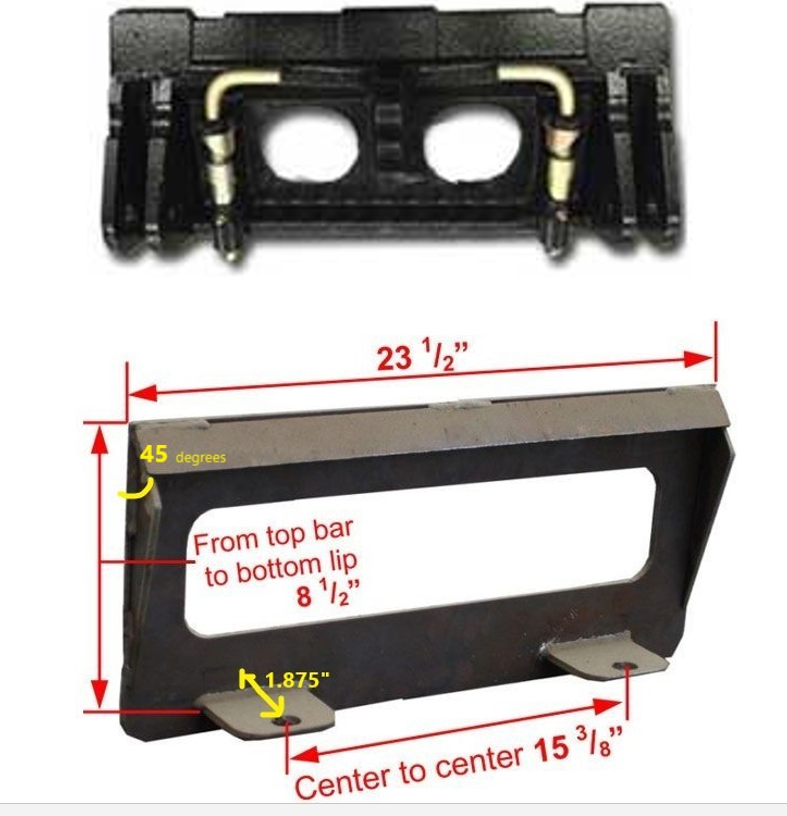

And the Mini SSQA used on a Toro Dingo that is the same size as most Mini Skid Steers:
What are the measurements on your LS?
Pictures would help muchly.
