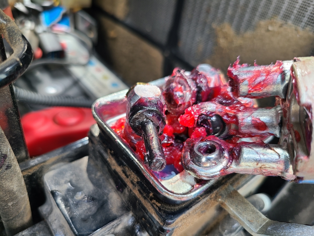

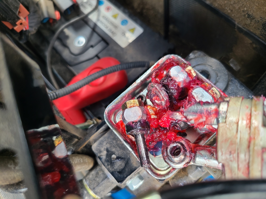

I have the same problem with my loader valve. (Also have MT125, I have the 1101 loader) I have already broken one of the legs inside the valve, and it was repaired under warranty. Now I am having the issue you describe. Here are pics of the broken loader valve before replacement. broken loader valve.jpegbroken loader valve1.jpeg I do like my tractor too, but this loader valve leaves something to be desired. I have had several other tractors (Kubotas) and I haven't broken their valves in 20 years of use, and this here with under 100 hours is giving me fits. I just cleared snow with it today, and that is when it started acting up. Maybe this weekend I will get into the new one and see if something came loose. Hopefully that is all it is. BTW, I am new here (although I was a member many years ago, but haven't used account in a long time)

Not sure if it's exactly the same issue, but mine was a loose nut holding the joystick arm in place. I have to readjust mine (again) because I went too far and lost the float detent due to the arm hitting the plastic housing.
