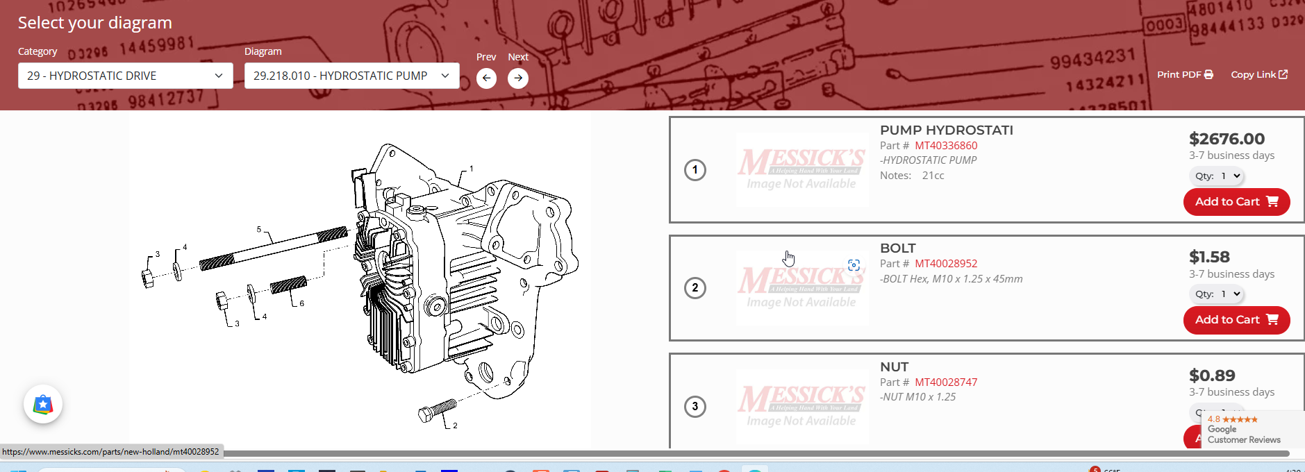

My NH 25S is built by LS for NH. It is based on the MT125. A NH dealer can furnish parts for your tractor. I believe NH just adds MT to the LS part number.
New Holland WORKMASTER 25S - COMPACT TRACTOR (NA)(12/17 - ) Parts Diagrams
