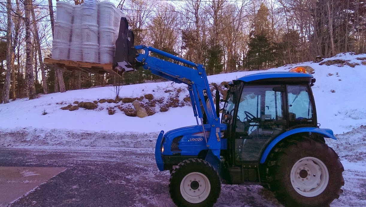

Their loaders are stout! I think LS provides the best overall bang for your buck/value. That's why I bought mine. My 50520 with a LL5100 loader is rated for like 2400lbs. The picture is it lifting a skid weighing ~1900lbs (1800lbs of cement, plus pails & pallet) LS 5020 Tractor Lifting  1900#.jpg
