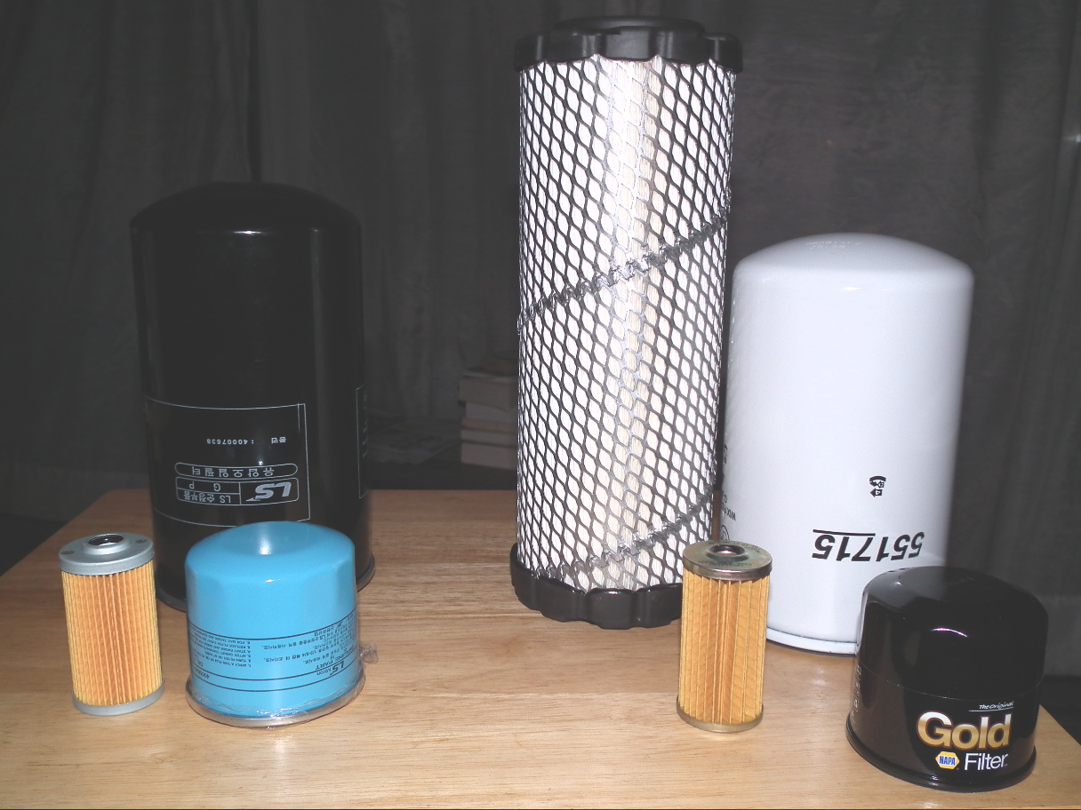

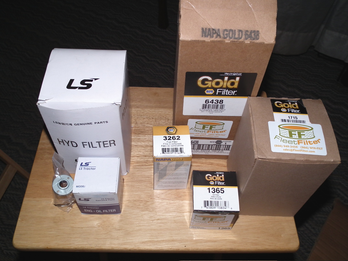

I'm FINALLY getting to 50 hours on my S3010 so I began looking for the various filters. Not sure how I should go, I decided to buy the filters from both my dealer and from FleetFilter and see what the differences were. I forgot the air filter from the dealer so here are the filters I ended up with:
Boxed
Unboxed
As to be expected there was a dramatic difference in price:
Hydraulic $49.99(D), $28.42(FF)
Oil $12.99(D), $5.17(FF)
Fuel $9.99(D), $8.15(FF)
Air$19.05(FF)
I also paid tax ($5.75 because FF is in Texas) & shipping ($8.88) from FleetFilter. The totals were $72.97(D w/o air filter) and $75.42 (FF)

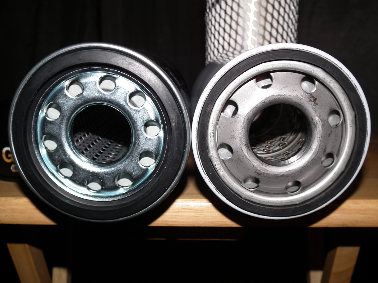

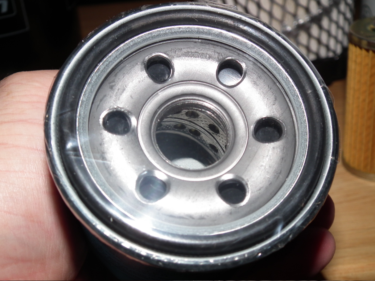

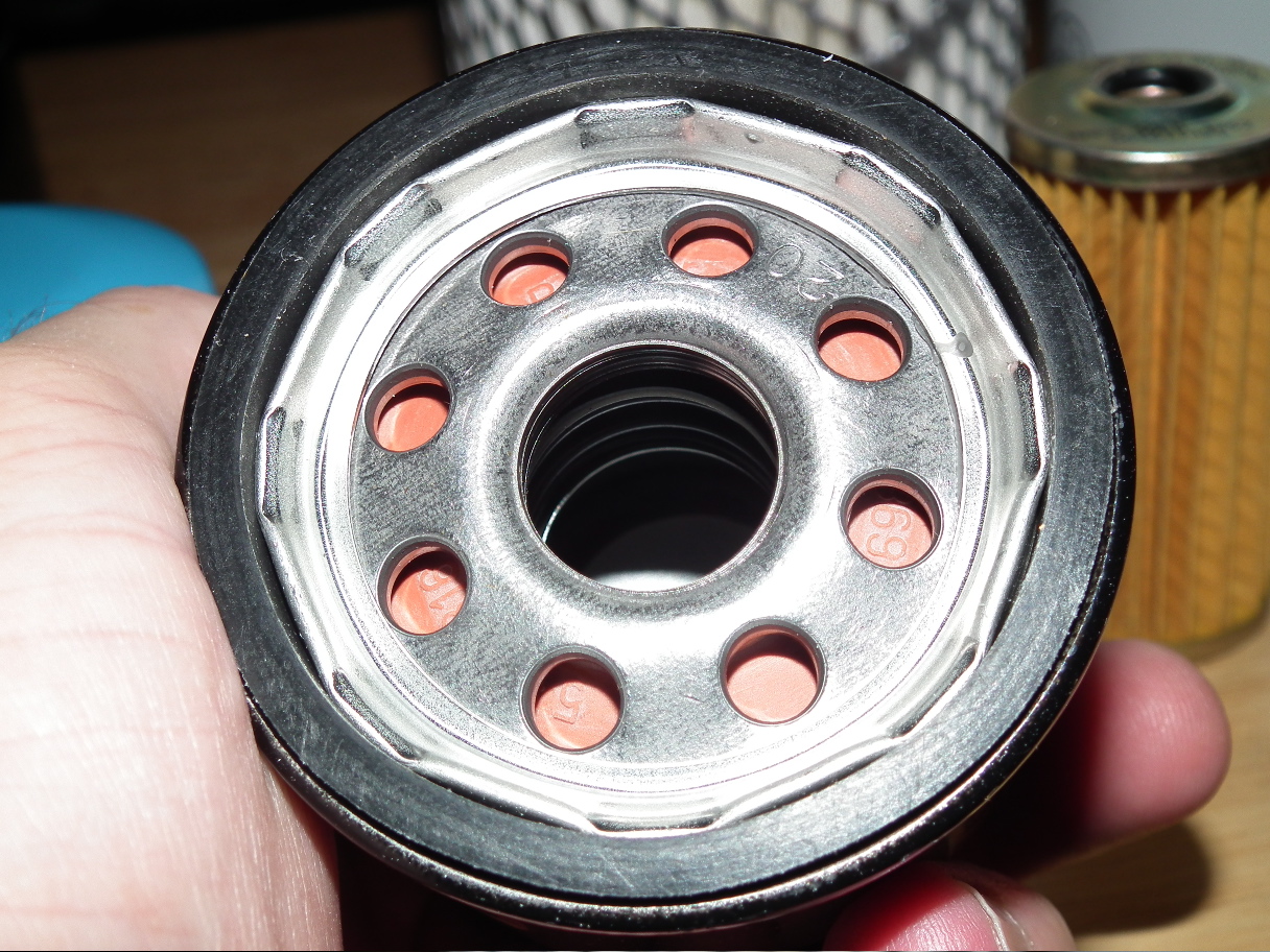

I have to admit the LS filters from the dealer did appear to be of a higher quality of workmanship. I couldn't see any difference in the quality of the materials. The rubber gaskets were nicer (not sure how else to say it...) on the LS filters.
LS Oil Filter
NAPA Oil Filter
LS (L) & NAPA (R) Hydraulic Filters

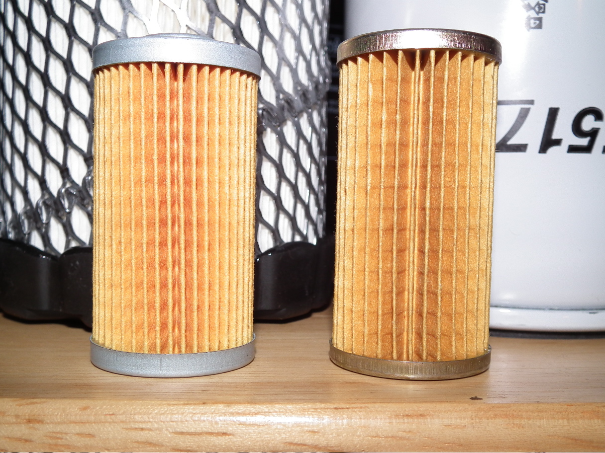

Even the LS fuel filter seemed to be better made and had more folds. The one from FF appeared to be slightly taller, but I assume that's not going to be a problem:
LS (L) & NAPA (R) Fuel Filters
I'm not a pro when it comes to this stuff so all this is just my observations. In my opinion the differences in quality aren't enough to justify the difference in price for my money, but I'm willing to listen to what others think.

Blue,
Are these the right numbers/filters? Just verifying what I saw in the pic.
6438 Air
1715 Hydraulic
3262 Fuel
1365 Oil
Thanks!

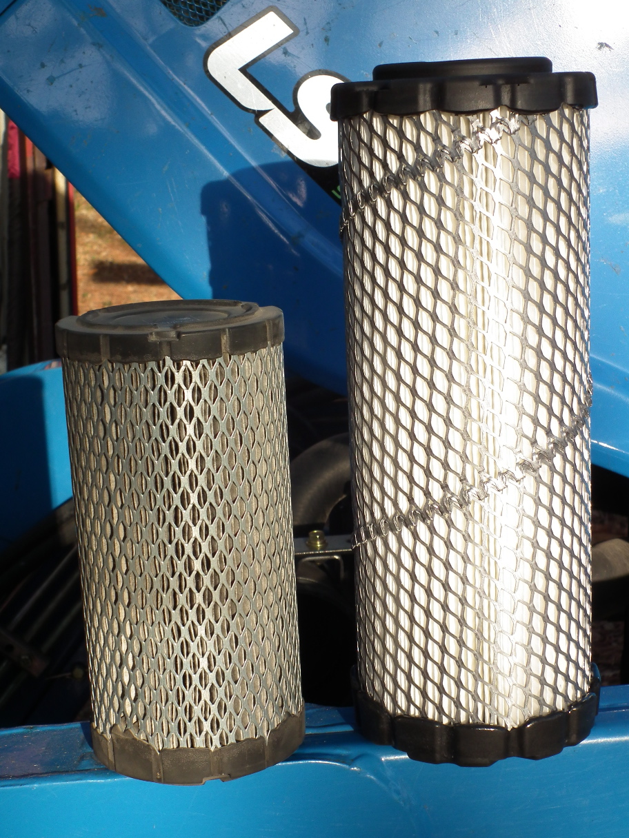

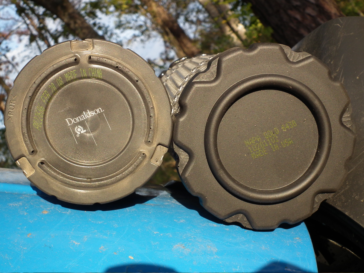

Wix 51715 $25.58 Hydraulic
Wix 51365 Case of 12 $55.80 Oil
Wix 46438 $17.15 Air (WRONG)
Wix 33262 $7.33 Fuel
Totally blew it on the air filter. I was using the filter part numbers for the Montana equivalent of the S3010. It worked for the all the other ones so I assumed the part number for the air filter was good too -- it wasn't. I had cleaned the original with compressed air and knew what it looked like, but I didn't remember how big it was. Turns out it was MUCH smaller that the one I bought to replace it. I found the correct part number for the Wix air filter (46449) by cross-referencing the Donaldson part number (P822686). Here is what they look like side-by-side:
Sorry, I should have checked before publishing that bogus information.
