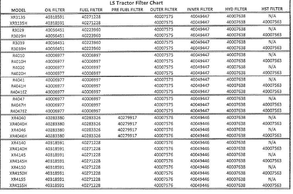

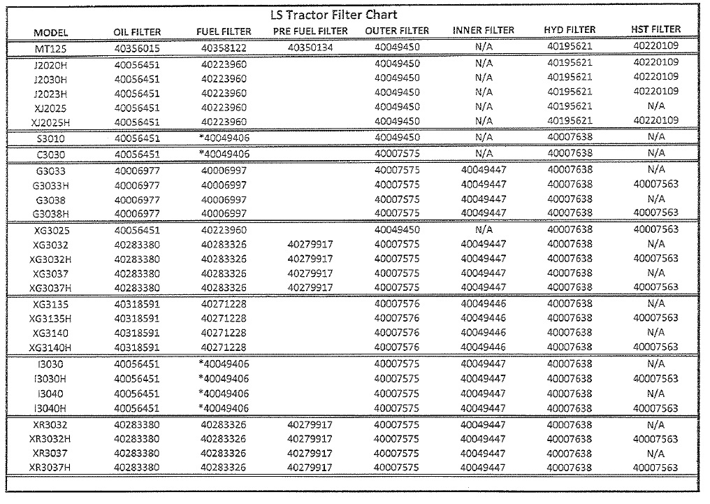

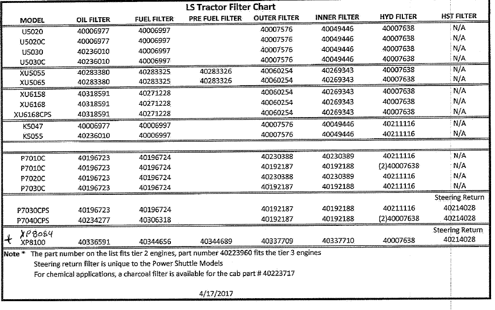

Ls complete Filter list most models ( hope this helps someone)
   / Ls complete Filter list most models ( hope this helps someone) #1
sadams4431
Apr 16, 2018
19
ransom, Ky
LS MT125
i would recommend crossing over all the numbers you can, the stealerships are expensive
