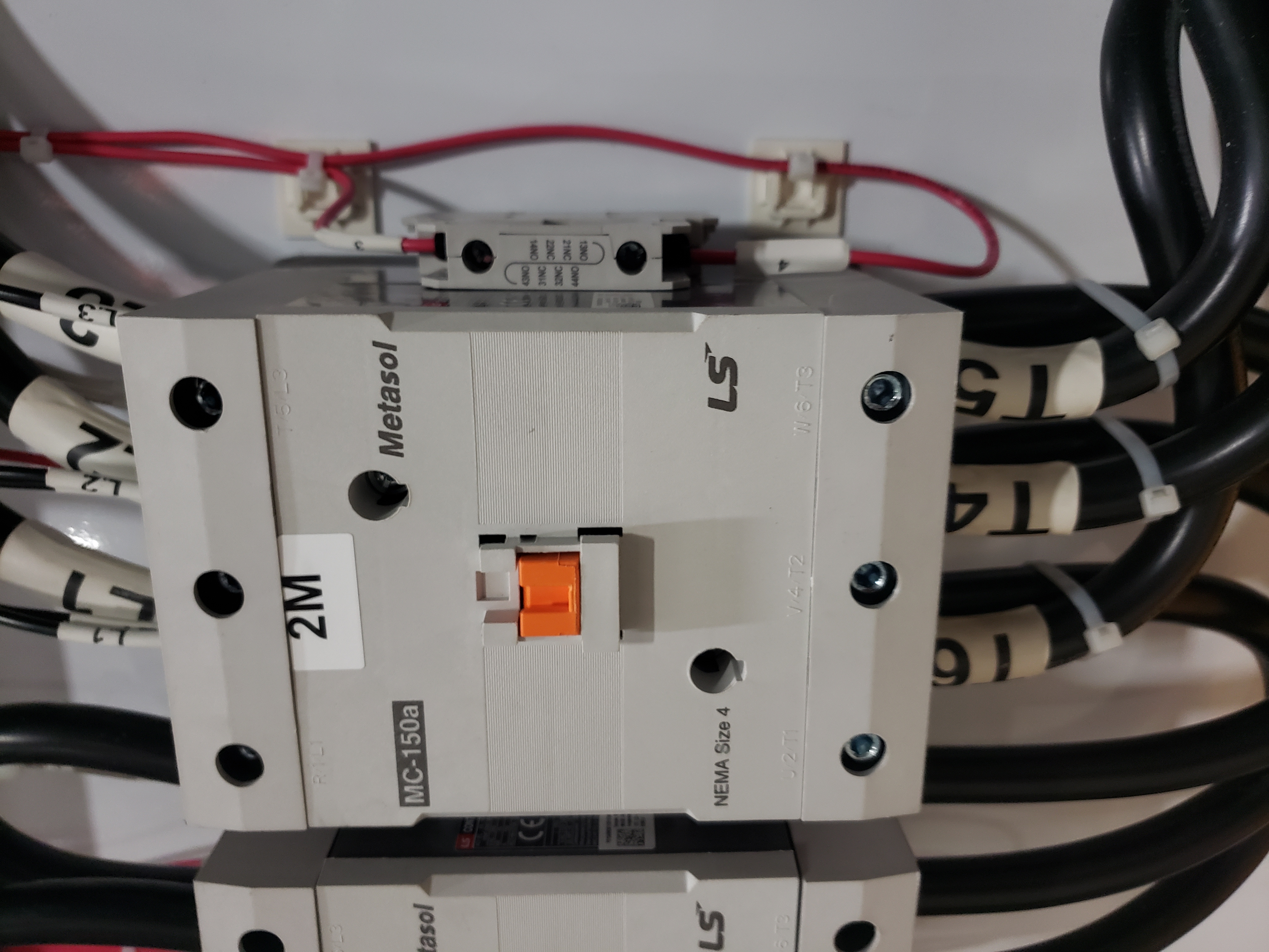

Back when I was researching LS, I learned that they make lots of stuff other than tractors. Pretty much just for the Asian market though, it seems. Until yesterday I never came across anything LS except tractors. I was on a customer's site yesterday installing a control panel that I built, and networking it with several existing (newly built/installed) panels and I found LS components in several of them. I need to find out who the LS contractor distributor is, see what else they sell, and if these are a better value than what I typically use. You guys come across any non-tractor LS stuff?
What is that to the right of the contactor with red 3 in and red 4 out?
   / LS branching out from tractors in the USA.
Aux contact to illuminate a pilot light when the contractor is closed.
   / LS branching out from tractors in the USA. #9
Triggered off of the contactor, got it. :thumbsup:

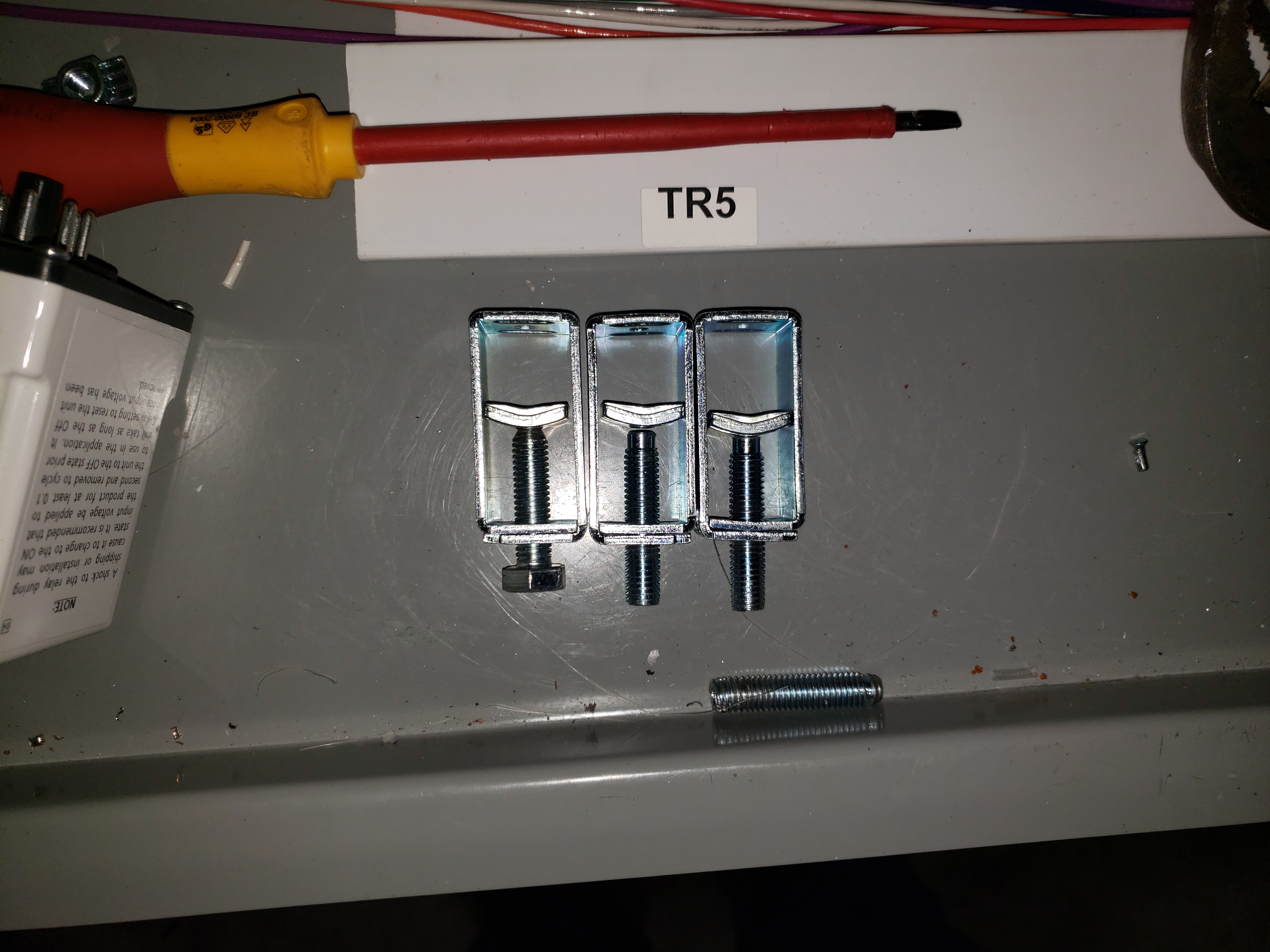

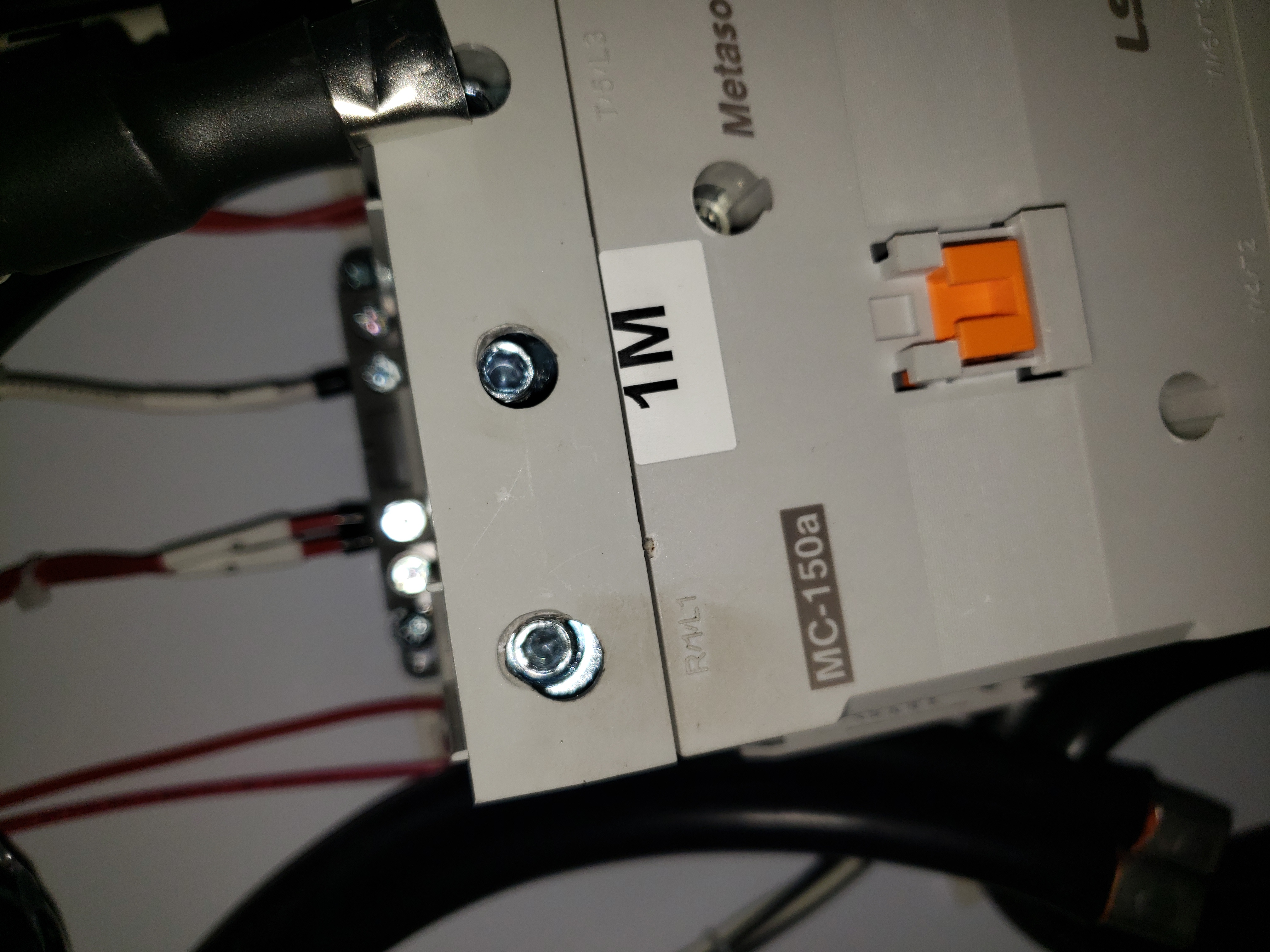

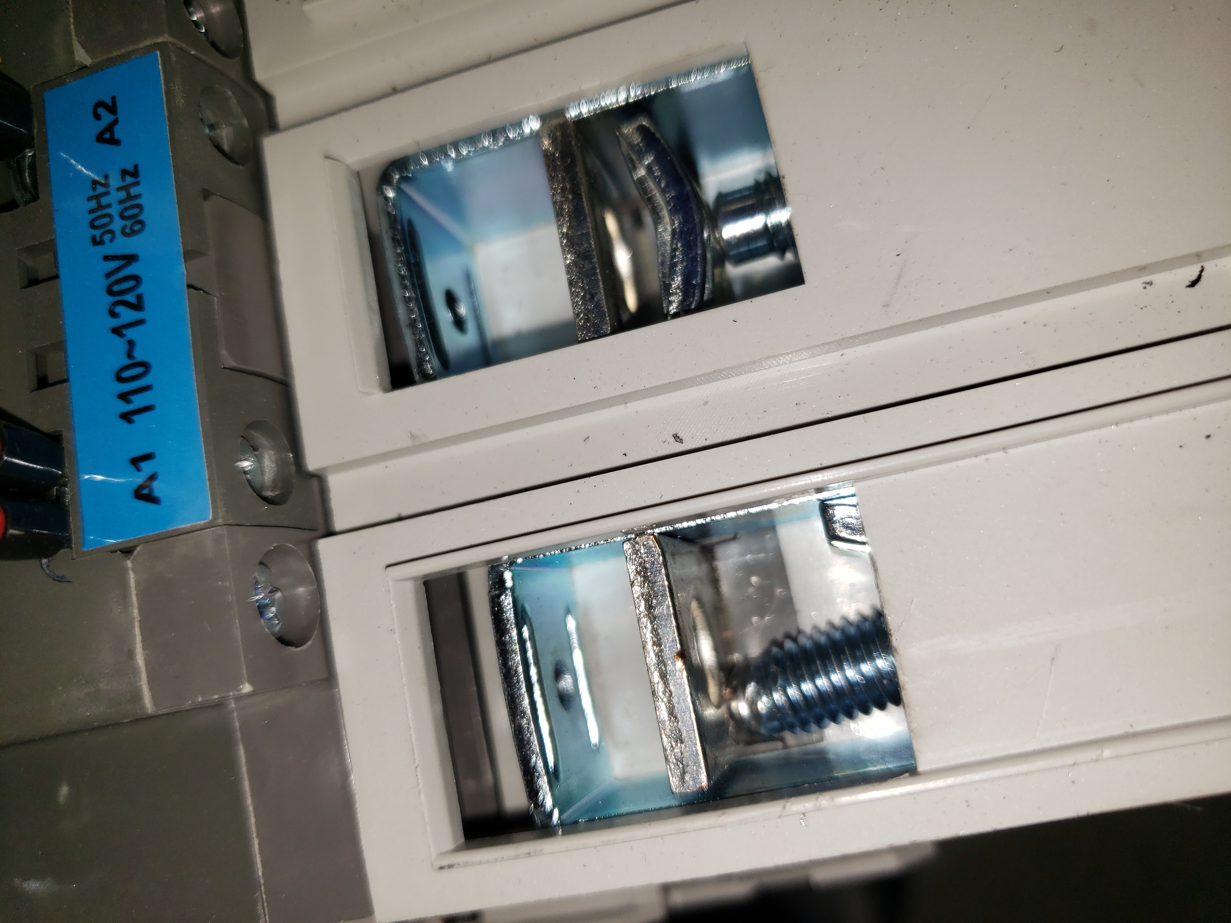

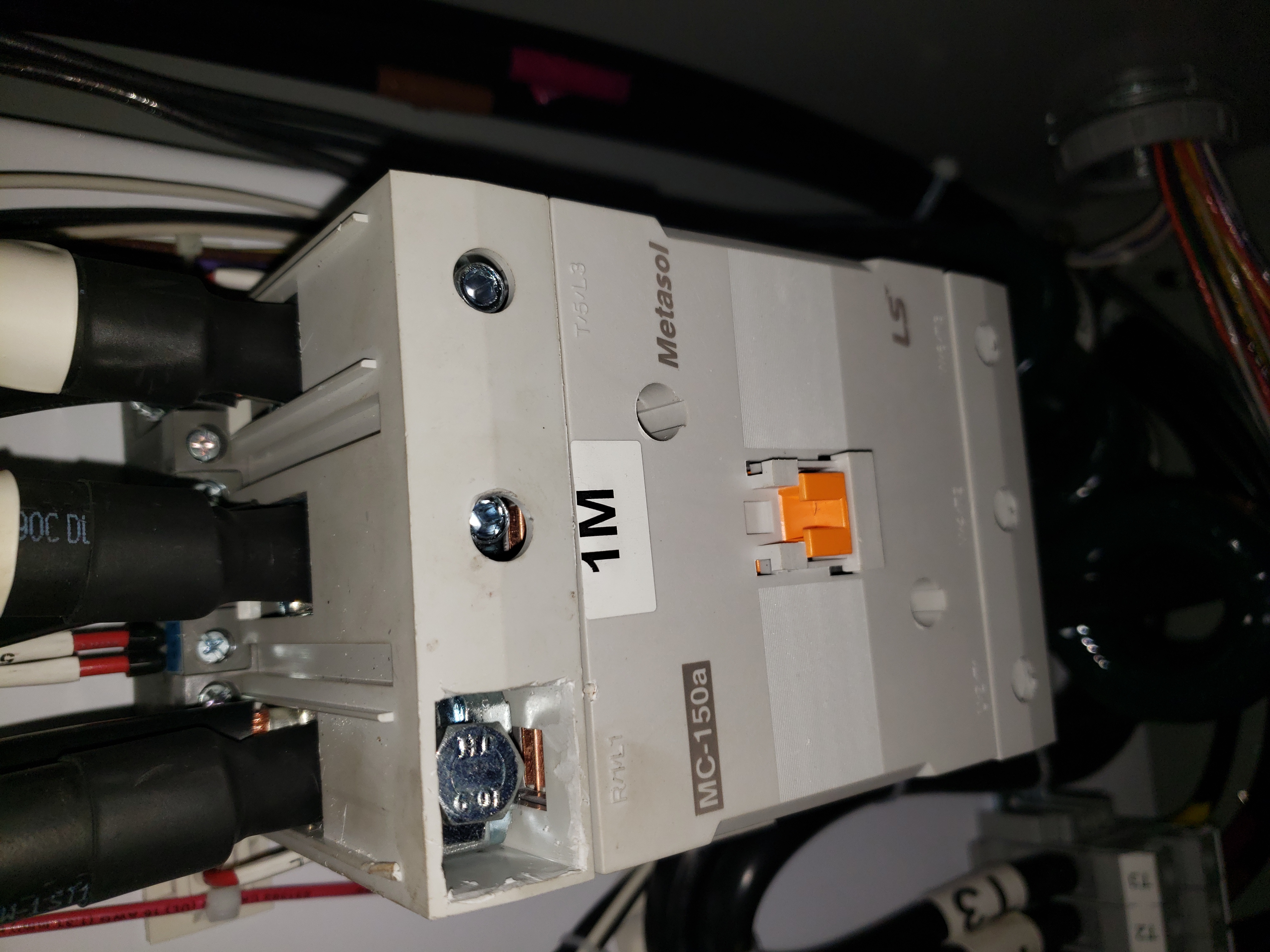

Well so far I find the LS contactors <100% awesome. One of my electricians was going through all the panels before we power them up and checking tightness of connections, when this happened:
A new contactor is on order but commissioning must go on, so a bandaid was employed.
Maybe it isn't fair for me to take away points from LS on this issue, as I wasn't the one turning the screw and I don't know how much torque he was putting on it. He could have had a hex socket on a 2ft breaker bar for all I know. The report I got was "I barely tried to snug it up."
