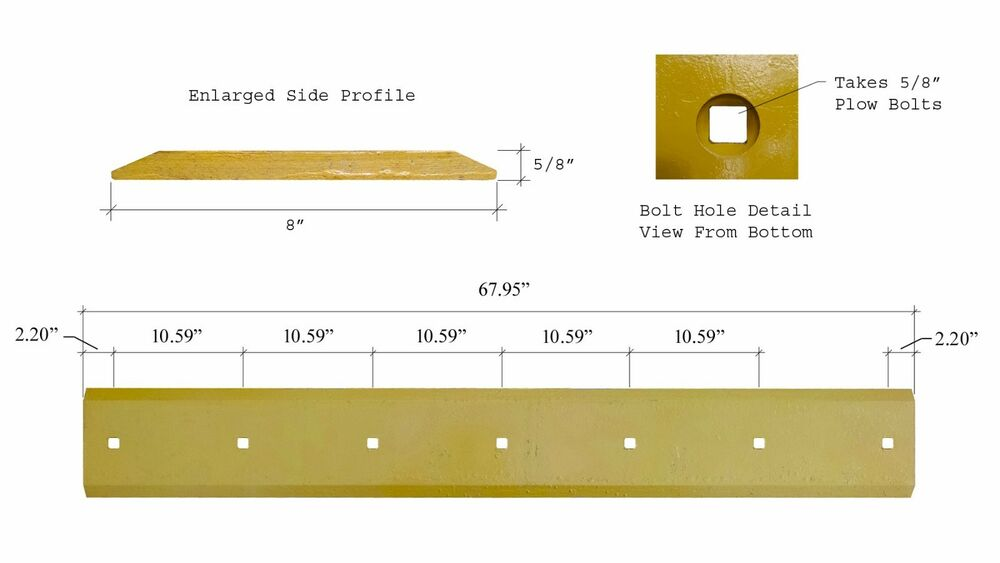

At my job after a bobcat cutting edge is used about half way down they are replaced, so i took a couple of the old ones home , they replace the edge and the bolts every time , i use them on projects that need a cutting edge . the 68" bobcat edge fits the LS 68" bucket on my 3025 the same as a bobcat bucket so the specs on the buckets are the same ,, if anyone wants to add a cutting edge to their buckets what i did ws flip my bucket so the bottom is on top , the LS welded on edge is only 4 inches run a chalk line down the middle set the bobcat edge in the middle of the marks and C-clamp it down , i tried to drill one 5/8 hole took to long so i used a torch to go through the holes took about 20 minutes or so to do all 7 holes , now you have a 8 inch cutting edge instead of a 4 inch and your bucket should last alittle longer .
