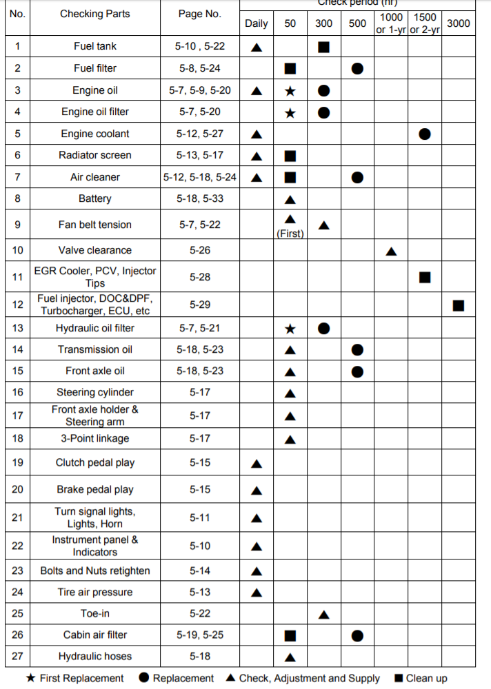

Ok... I have a simple question, but I can't find a "complete" answer to. I have a XR4140HC
What service is done at the 50hr mark?
oil, oil filter, HST filter, grease all the zerks, what am I missing?
Thank you,
Drew
   / LS 50Hr Service question for XR4100 Series #2
   / LS 50Hr Service question for XR4100 Series #3
What part about your owners manual do you find "incomplete"?
