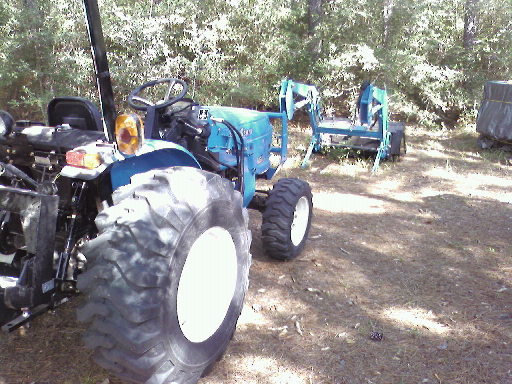

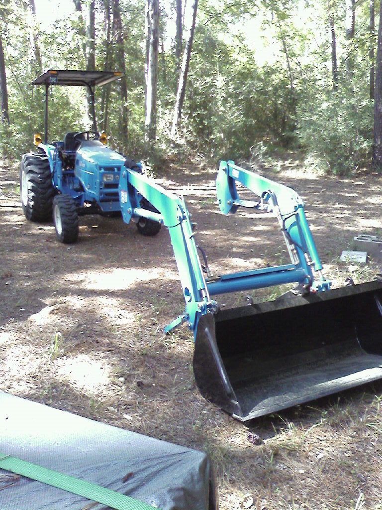

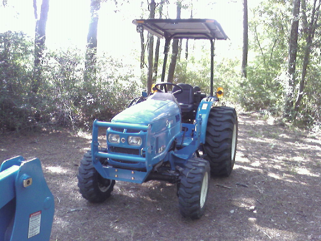

how hard is it to remove front loader ?
I pulled the one on my S3010 off just to see and it's really easy. I just followed the instructions in the FEL users manual. I was careful to do it in the shade as I had heard of others having problems re-connecting the hoses if the FEL was left in the sun and heated up. Re-mounting was a little more difficult until I realized the importance of getting everything lined up properly, but it was easy after that. I think I could get it off and back on in less than 5 minutes with practice. I even took a few pic's of the FEL off with my cell camera.
