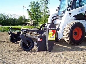

A lot of how you can do it is going to depend on the top soil depth. If you can take 2" out then replant or replace the sod and still have good top soil? If I was doing it I would use one of these, going forward it will allow you to take small amount off and push into pile.
I would take the top soil off push it into a pile then go in take the clay out put the top soil back. If I had good grass, there I would rent the sod cutter roll it up then unroll it and put it back.
However, depending on how much concrete I had I would look long and hard about either raising it. Putting in drain tile, or putting in a ditch. What I just outlined above is a lot of work.
