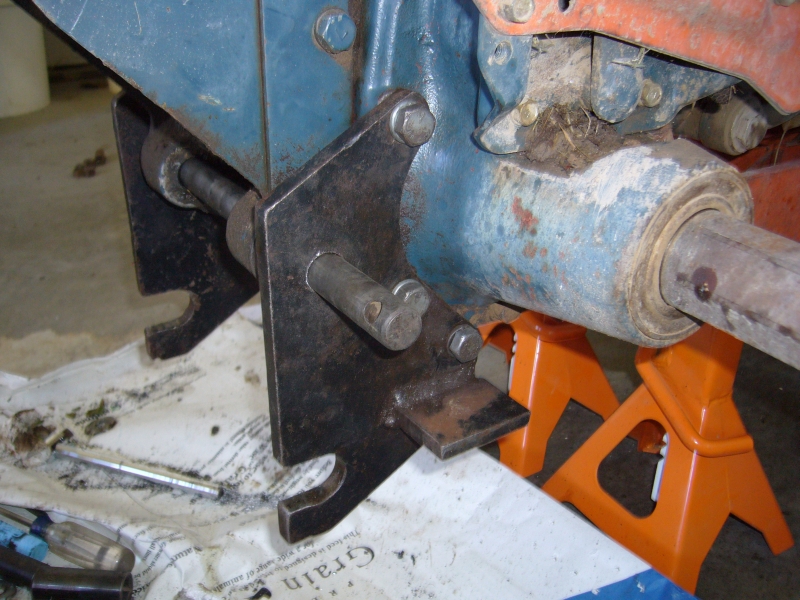

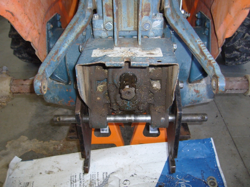

Thanks for the input guys. Here are a couple pics that help show what I am talking about. I heli-coiled the bad holes, drilled holes for the link pin in the brackets and mounted them with the old link pin inserted.
Turns out it only moves each side out 1 and 3/16 inches. Since the brackets are made to take the rear hoe weight/flex I think I would be ok if they would take some load if the link pin flexes. I think that takes care of what Renze noted.
As for the diameter of the pin it is 7/8 inch and it would need to be about 17 and 1/2 inches long. Probably rules out any off-the-shelf pins.
Since the 3pt is rated at like 1200 lbs would 4140 or the like be overkill?
Thanks!
Charles
   / lower link pin steel type? #8
I don't think 4140 would be overkill.
If it was me, I would want it hardened, but pre-hard like 4140 or 4130 would probably do. What I don't like is that the pin is one length going through your tractor and those plates. If it bent you would have a heck of a time getting it off for replacement.
   / lower link pin steel type? #9
Did a little more digging... Most places I found online sell 4140, 4130, etc in an annealed or normalized state, basically about as soft as they can be. One option that should be readily available is "Stressproof" rod, which is an 1144 and comes with some heat treatment. A lot of places stock stressproof for use as shafting because it's strong but reasonably machinable. I'd look for either stressproof or some type of pre-hardened 4140, 4130, or 4340.
Online Metal Store | Small Quantity Metal Orders | Metal Cutting, Sales & Shipping | Buy Steel, Aluminum, Copper, Brass, Stainless | Metal Product Guides at OnlineMetals.com
...has stressproof. They also have a guide that shows some of the properties of the steels they have. For example, they list a yield strength of 100,000 psi for stressproof, but list a yield strength of just 52,200 psi for annealed 4130... Looks like the normalized 4340 would be good stuff too...
