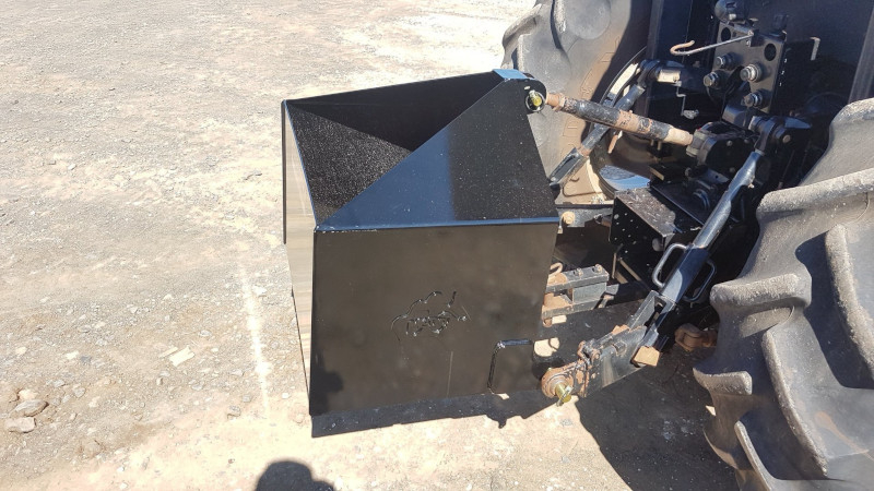

This McCormack Industries weight box puts the lower lift points at the very bottom of the box. I assume it would not be possible to remove the weight box without putting it on top of blocks.
   / Lower hitch mounting height for a counterweight #2
....This McCormack Industries weight box puts the lower lift points at the very bottom of the box. I assume it would not be possible to remove the weight box without putting it on top of blocks.
Pin on, that one could be put on the ground and taken off. But not with any quick hitch, you need to come from under the pins. So the one you posted could not even be used with a quick hitch unless you can slide it in sideways. (and that looks pretty tight)

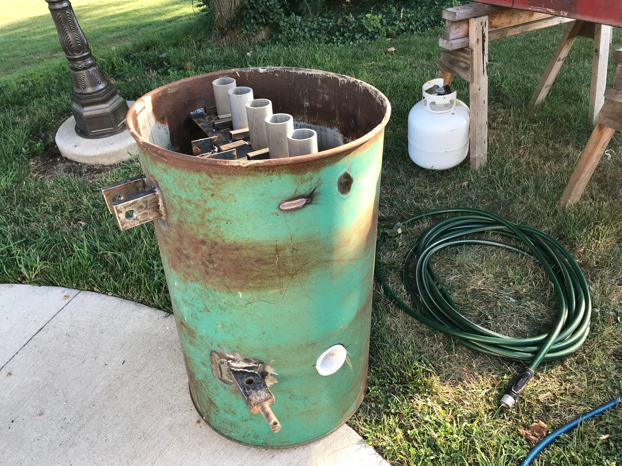

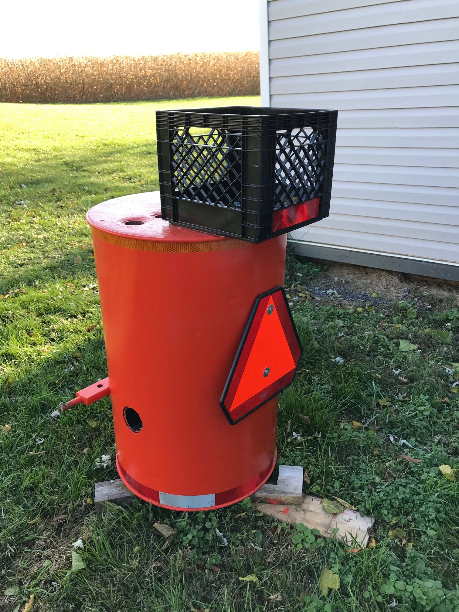

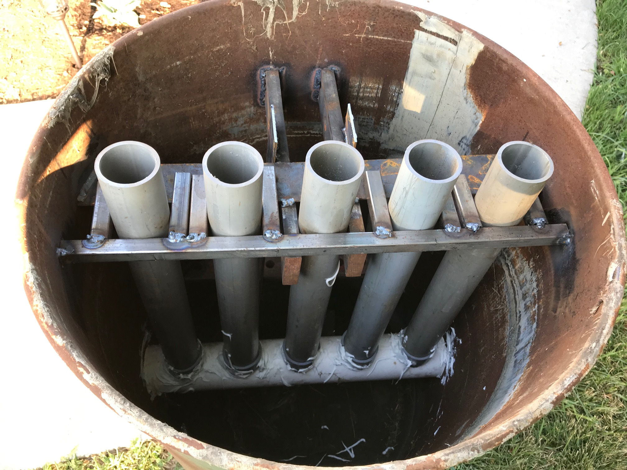

The height at which you carry the weight has a lot more to do with the COG than where the pins are located. Anyway, here's mine. The PVC "header" a the bottom is there to serve as a drain for anything that gets into the vertical tool holders, and to facilitate easy cleaning of anything that does drop into them. The milk crate is for misc chains and straps that are handy to have in the snow:

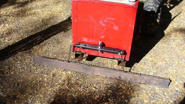

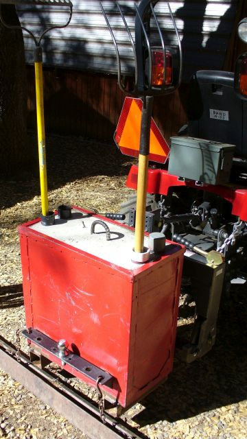

You may also want to add tool rack as "chim" suggests....
Also I found it great for my use to have some ability to "connect" items to rear of weight box... In pic is a 6 foot length RR track when drug behind tractor smooths ground and erases a lot of tire tracks.... And maybe some sort of lifting loop incase you have bad hair day moment and you tip ballast over (has other uses too) ....
