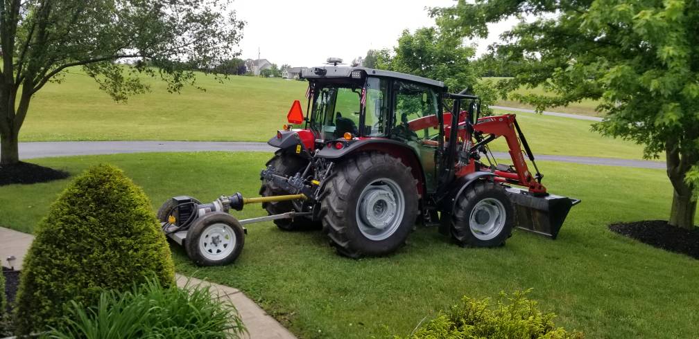

I have a 15kw PTO generator. It has to run at 60 Hertz. On my unit, that is about 516 PTO rpm, which is about 1800 rpm. 20200605_162415.jpg
