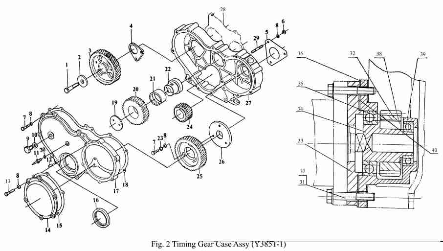

I ordered a rebuild kit for the hydraulic pump from Jerry at affordable tractor and in preparation for the project I took off the intake lines.
Just for the **** of it I turned over the tractor and looked in through the intake at the gears of the pump --- they were not turning!
I pulled the pump off and I see some wear on the coupling .
Is there a rubber bushing that transmits the torque?
Where can I get an exploded view?
What is going on ?

Not turning is not good:( The first link is to John's Jinma site and some closeup pics of a hydraulic pump overhaul. Does the end of your pump input shaft look like the last pic at the bottom of the page? It should have a flat tab on the end that engages a slot in the pump drive gear inside the timing case. With the pump removed, can you see the gears turn when you turn the input shaft by hand? If you can see the gears move when you rotate the shaft by hand, try slipping a small screwdriver or rod into the pump fluid inlet port to keep the gears from rotating, then try and rotate the pump input shaft with a wrench or vise grips gripping the flat/keyed tab end of the shaft(gently, don't apply enough force to break off the piece you have inserted to jam the gears). You should not be able to rotate the pump input shaft with something jamming the pump gears. I am not sure how this pump is assembled, wether it's gears are press fit to the shaft, keyed to the shaft or the shaft/gear are a single machined component. If you can't rotate the pump input shaft with the pump gears jammed, you may have a problem in the forward timing case geartrain.
HydPumpDisassembled
This second link, also courtesy of John's site, shows the timing case parts diagram. The right hand cross section drawing(numbers 31 and higher) shows the pump drive assy. This would be a view from the top looking down or right hand side looking inward of the tractor timing case. The pump mount bolts and input shaft come in from the left of that drawing. You can see that the pump stub shaft engages the pump drive(#34) which is supported by 2 bearings(part# 35 and 39). With the pump removed, stick a large screwdriver into the slotted hole in the back side of the timing case where the pump shaft goes and try and rotate that pump drive. You shouldn't be able to rotate it as it should be hard coupled to the timing gear drivetrain. The most you should be able to do is rattle it back and forth a degree or two(very slightly) as you take up the gear backlash in the drivetrain. If you can rotate it any distance, you have a problem inside the timing case(and most likely gear teeth remnants in the oil pan:(.
http://www.johnstractor.homestead.com/files/TimingGearFig002.jpg
With what you describe, pump gear teeth not rotating with the engine running, it has to be either the drive gear in the timing case or a bad pump input shaft(sheared or pump gear rotating on the shaft:) I hope it is the pump...

   / Low hyd fluid Jinma 254
I put a screw driver in the intake of the pump and jamed the gears . I was unable to turn the pump with a vice grip on the drive shaft.
I was also unable to turn the drive in the tractor with a screw driver.
It seems to me that the torque is not being transmitted between the tractor and pump.
