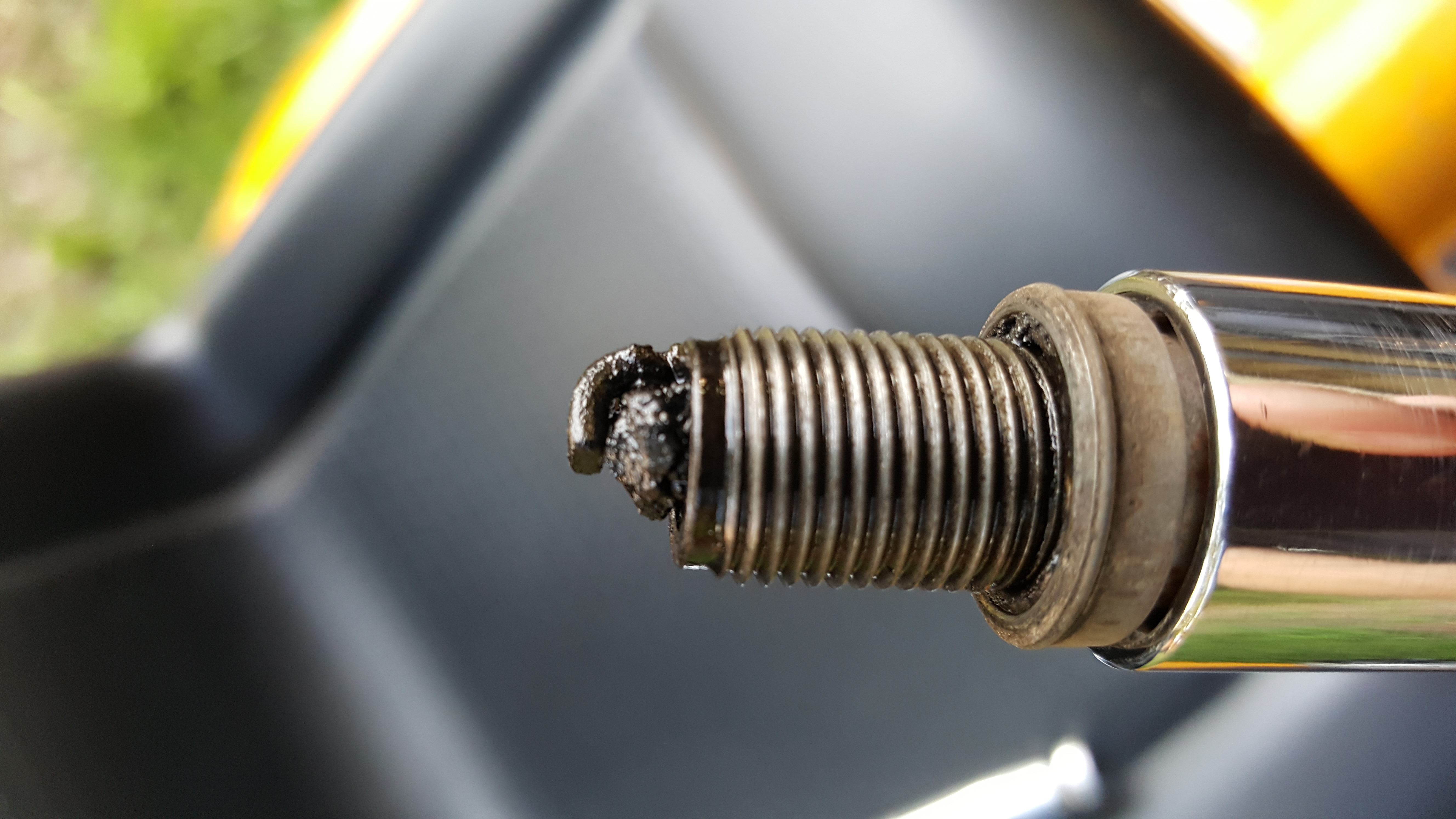

The CH20 in my GT2544 starting burning oil on the right side and smoking a lot. (see pic of right plug) It has less than 200 hours on it.
I don't have a leak down gauge, so I haven't been able to do that yet. I checked vacuum at the dipstick tube and it was fluctuating around 1-2".
I heard about the reed valve problem on the twins causing them to suck in oil and burn it, but I would think that would be in both cylinders. Is it possible it blew the head gasket? I sure hope I don't have to rebuild this thing with under 200hrs on it.

I got a max reading of 170psi on both cylinders cold. I did see fresh oil on the right plug and even the adapter after running the comp test. It looks like the breather tube has some oil inside it too. So maybe it is sucking oil up through the breather. Is there any reason why there would be more oil going to the right cyl?

Kohler has readings for a warm engine which normally create lower readings than cold engine. I suspect you have a head gasket issue on that cylinder.

I am inclined to believe you. I pulled the breather cover and the reed looks ok, but there is oil all in there the filter looks soaked and there appeared to be oil in the breather hose. I'll bet it blew the gasket at the oil drain and is blowing back through the crankcase, but that cyl sucks a lot more oil back in on the intake stroke than both are getting back through the carb. I guess there's only one way to find out, pull the head. It's head 1, on the right side.
When I lookup the head gasket I get p/n KH-24-841-01-S. That looks like the oem gasket, isn't there supposed to be an updated version? Or is that only for the 25 and above?
