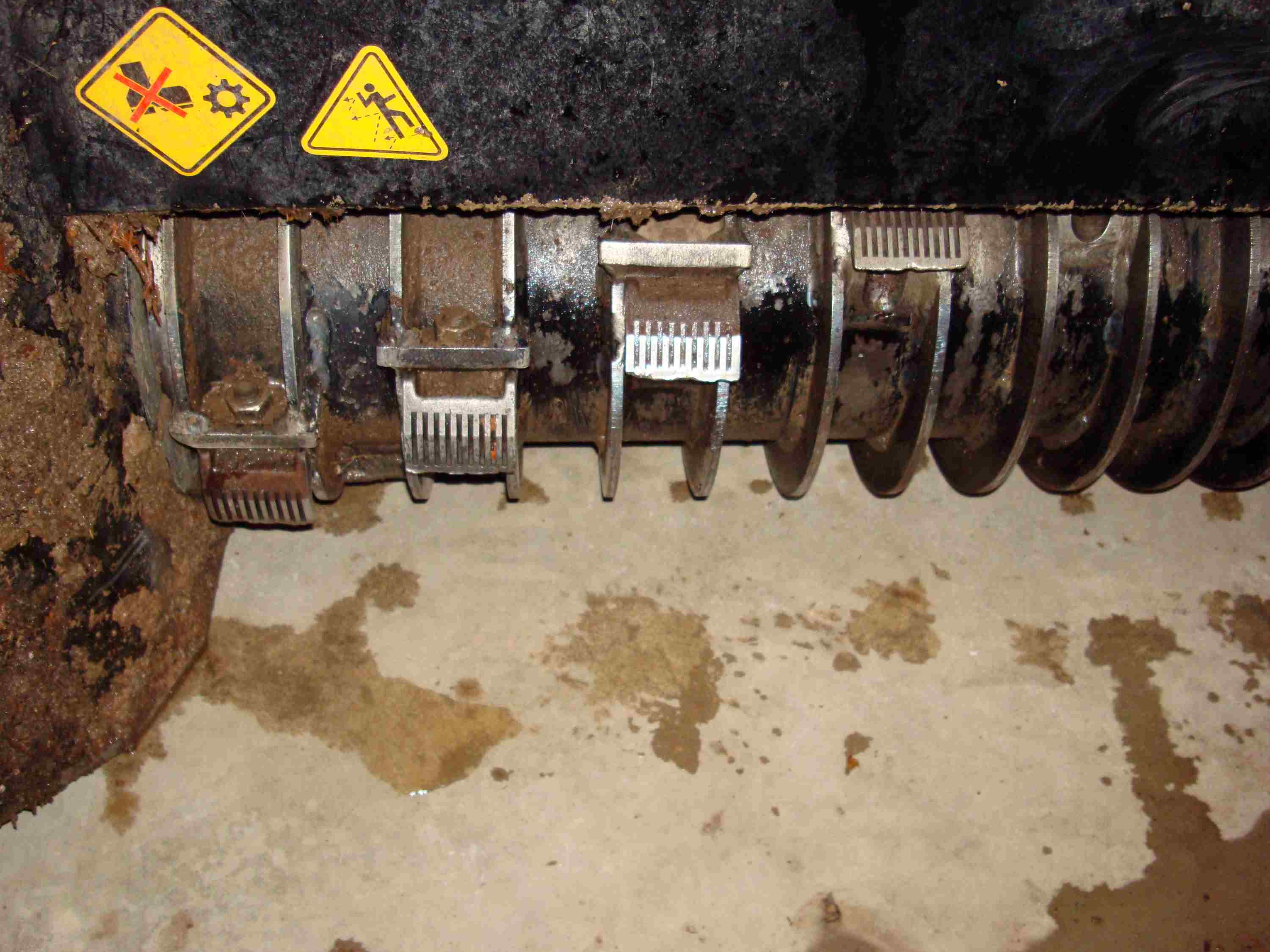

Here's a picture of the teeth on the low flow head I demo'ed.

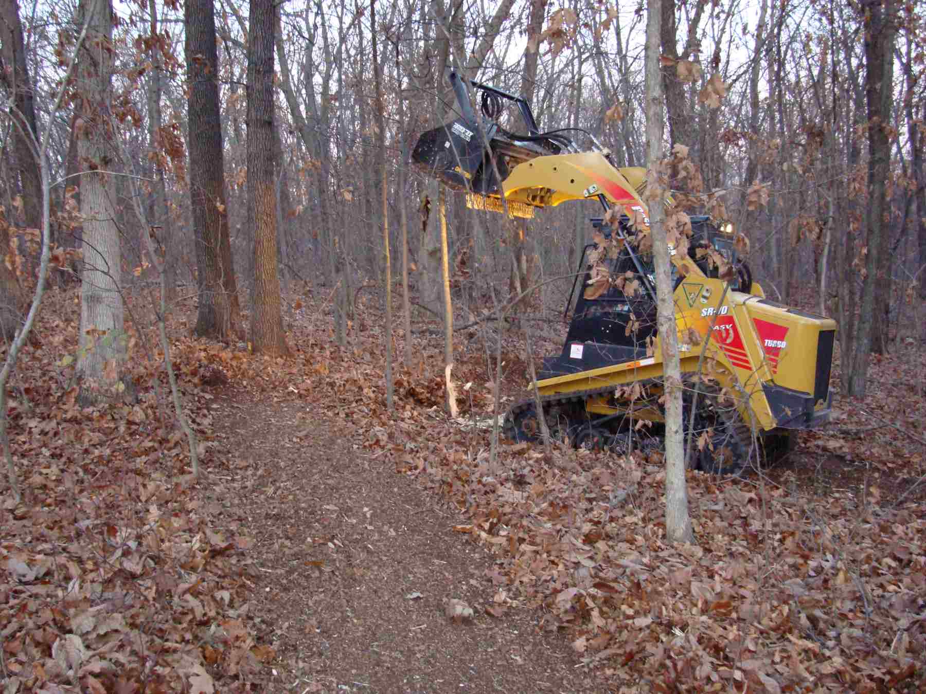

Here's a picture of the machine working.

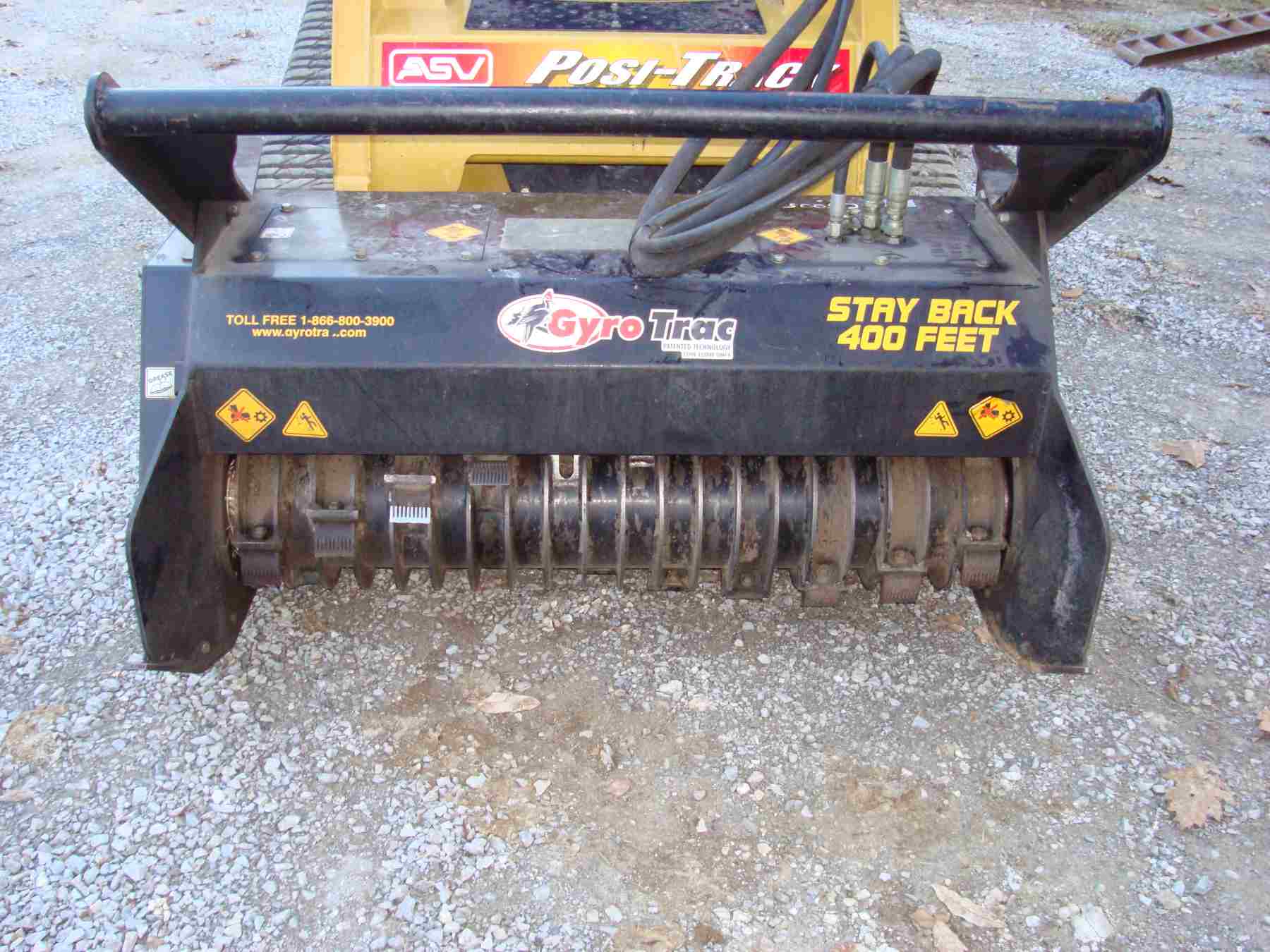

This picture shows, what I consider, worn-out teeth.
